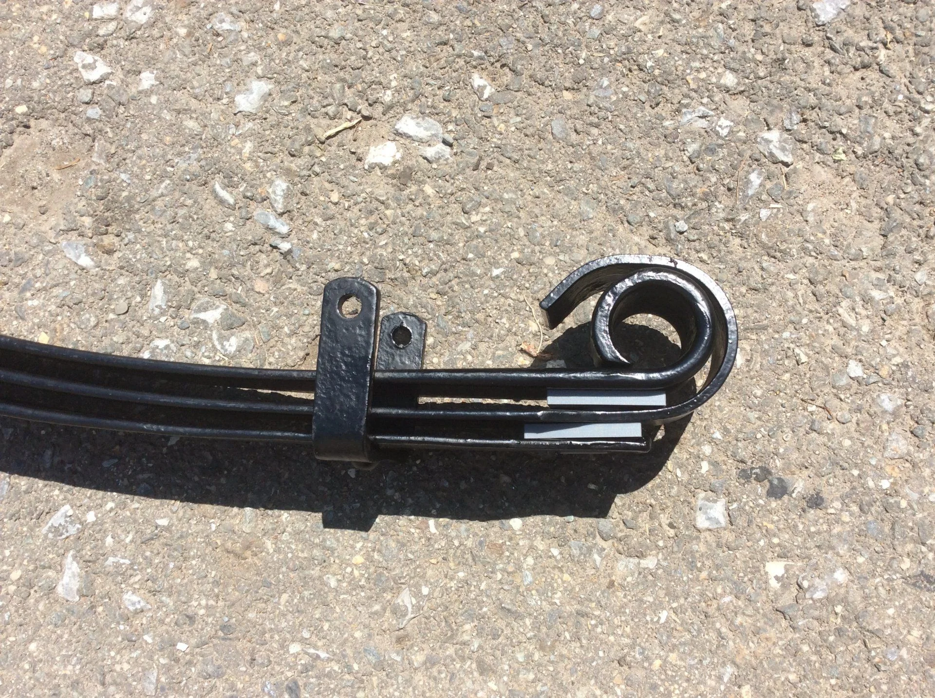

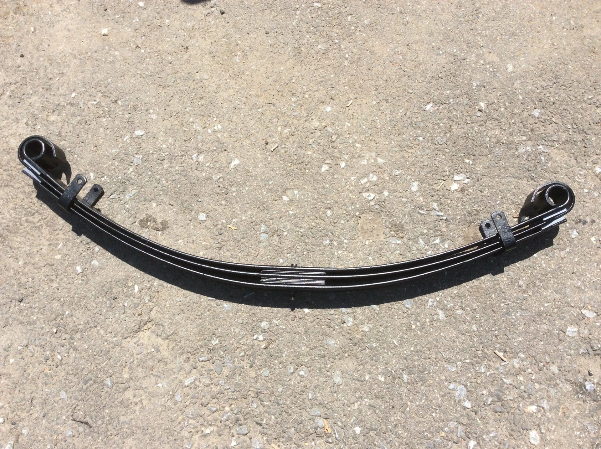

The parabolic springs were cleaned, blasted where required, and coated. The plastic slider pads for the spring tips were machined from gray colored oil filled UHMWPE. I'd rather have nice new shot peened units, but they are NLA. These springs will due for the rest of the season.
I used parabolics on a 1978 hzt 45 pickup, best ride comfort with bed empty of any other spring i have tried.

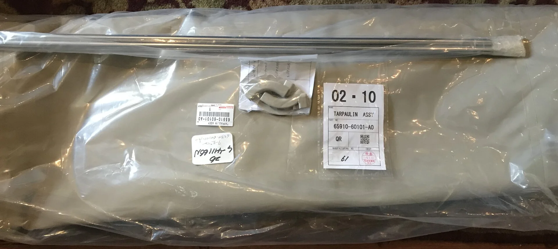

Parts arrival has begun. I’d love to compare this 65910-60101-A0 tarpaulin to the 65910-60160-A0… the 60101 is significantly less expensive.
60101 is a shorty, 60160 is a mid wheelbase.
