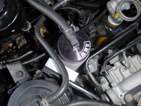

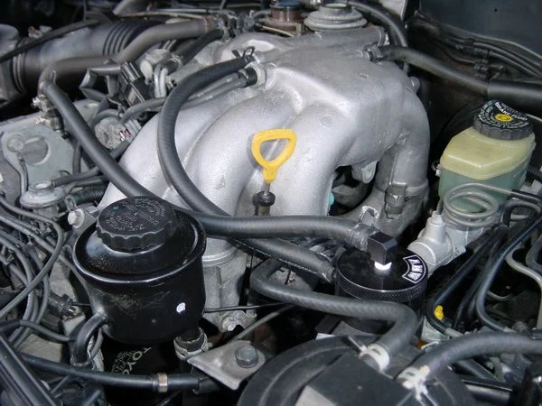

Here are some pic's of my install. I used a piece of 1 inch square aluminum stock for a mounting surface and attached it to the charcoal canister bracket. Caught a lot of junk since I installed it in July, glad its not going back into my engine. Great project and writeup Shaun!
Good Work! :cheers::cheers::cheers:
Hey Jersey, I'm trying to visualize how you mounted the block and then mounted the catch can to the block. Do you just drill holes and use nuts/bolts or did you drill/tap?
I drilled two holes through the stock and canister bracket for sheet metal screws making the front ones in the stock larger to pass the heads of the screws through. Once it was secured I put the catch can bracket against the stock marked the holes drilled and used the supplied screws.
Wondering where that will tend to drip when you open for oil changes? It looks like it is right above the coil which might make a mess or is it a straight shot down to the ground? I know the angle of the photo might be misleading. One thing that I like about where I mounted mine is that they both drop onto the reverse side of the wheel wells where they then drip to the ground. When I change my oil I simply sit two buckets under the wheel wells towards the back and all the oil and crap collects in those without getting on anything else. It is a small slim stream of oil on the reverse of the wheel wells which is really easy to clean afterwards. Anyway, have you done a dump test yet? :cheers:

I not sure if it will drain all the way to the floor, i haven't drained it yet, however I have enough space to easily get a large red cup in and out with no problems. I'll check tomorrow and let you know if it's a straight shot down, that would be cool.

Either way it sounds like you have your solution - just put the cup there and twist the petcock open. BTW, I leave mine open the entire time I am changing my oil and oil filter; I like to give it time to really drain down. Again, really good work! :cheers:

I looked at the drain, if opened it will drain onto the inner fender.

Cool! I think the catch cup idea is the best, I can't get anything at all under my cans the way I installed them so I just let them drip to the floor and put two big buckets there to catch the waste. Like I wrote before, I let mine leak dry the whole time I'm draining the engine oil, removing and replacing the oil filter, etc. It takes a while to stop streaming out on the PCV side whereas on the turbo side it is like one tablespoon, maybe two tablespoons at most over 5K miles! You can test from time to time the effectiveness by removing the return hose - on mine it is always absolutely bone dry whereas with my other catch cans the return hose was wet with dirty dusty oil! If the return hose is dry you know that 100% of the oil is in the can! Again you did great work with one of the best catch can designs I've ever seen, $$$ but worth it! :cheers:
