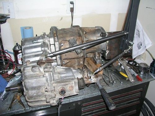

Got the shifters mostly done. They won't be completly finished till I get the seals and the Tcase back together. PLus I need to mount them into the rig to see how much throw they will require and what is available.
They are nice because they are fullt adjustable..
I am going to bend the shifters apart for more knuckle clearance and build a "pistol grip" into them..
A nice coat of paint and away we will go :D
