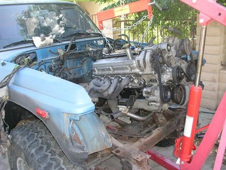

Started placement on the motor today. It sits fairly far back and there is a TON of room between the motor and the radiator..
Over all I am not overly pleased with the motor mount cradle. Without doing a springover the bottom of the cradle comes very close to hitting the front diff. Once I get the tcases on I can figure out if I need to move the motor forwards or not. As it stands. I have very little room on the DS for steering (spagetti headers do take up a lot of room)
What is the standard amount of tilt that most V8's have in them when you do a conversion like this? It seems like my motor is angled back considerably.. Don't think that is a huge deal considering that the oil pickup is in the rear but I would hate to be wrong..
The other issue is steering. I am very tempted to do a stock setup just for ease.. I hate drilling holes in the frame for a sag box. But I do have a Scout box and I don't have a FJ60 box :(

Only the tranny is on there right now.
I wanted to do everything but I still need to tweak the DL angles to make sure the 203 and the split tcase fit well.
After I get everything positioned the motor/trannt/tcases coem out and the frame gets painted..
And wait till the full intake is on it. AS it stands I only have half an intake :D
My 5.0 is at 0 degrees side to side and 5 degrees rear tilt. Local hot rod shop recomends 3 to 5 degrees tilt to the rear.
