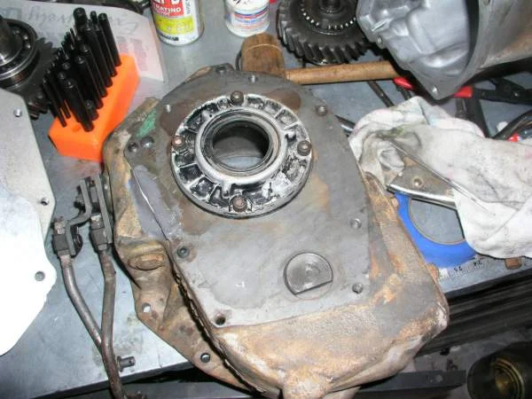

Got 1/2 of the holes drilled in the GM 203 in a ford bolt pattern.
the reason that I have not finished drilling and tapping the holes is due to the fact that one of the bolts has to drill into the shoulder of the 203. Drilling that part won't be a big deal but tapping an incomplete hole is a PITA.
Soooooo, out comes the JB weld :D
I used tape to create a boundary and am going to sand down the surface to be flat with the flange. I really don't care how strong the JB weld is, Most of the bolt will have threads in metal completly...
You can also see the allen head set screws that I am using to plug the chevy 203 pattern.. I figure that having ti able to be run to a Chevy again would not be a bad thing ;)

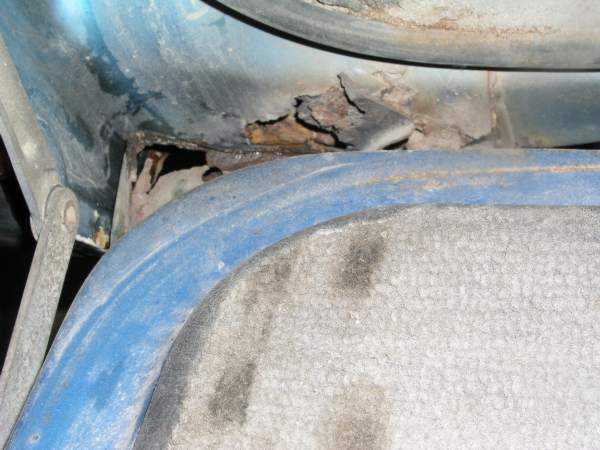

I am also looking to replace some of the rusty spots on this rig.
It is funny, there is no rust on the gutters like most 60's have. But the bottom of the tailgate is pretty hammers as are these spots..
Other than these bad spots is is fairly clean (cept for a nice dent in the PS rear door ;)

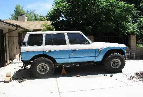

I really like the stock color. So I am thinking that a metallic blue will be necessary.
But I also think that I am going to go with this paint scheme...
attachment.php
Cept the white will be blue and the blue will be rhinolined black :)
So do I, but there was another guy on the board with a white top cruiser that just did not look right..

I like the paint idea you just posted Mace. Looks kinda cool. I am not sold on the white or black roof ideas on wagons myself.
Also, the rust in the rear kinda under the tail gate. How are you going to go about repairs there. Thats one of the many places I have some rust :)

the white is just not my cup of tea...
the blue top and aqua lower might be neat.
Anyone what to chop that color scheme into bob?

I am planning on just cutting it out and replacing the pieces. I am fairly sure that SOMEONE that is parting out a 60 will have those protions in good condition that they can;t seem to get rid of :)
