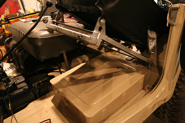

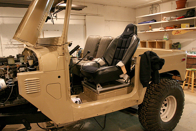

Here are some updated pictures. I didn't get the cage installed yet, so we modified the driver's seat brackets for the Corbeau. I'm going to leave the passenger bench in until I do the cage.

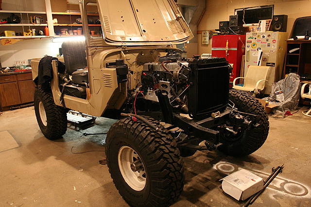

New radiator is in...

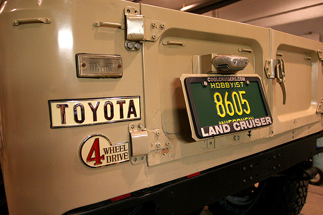

And it already has it hobbyist plates. The thing I can't understand is why it takes 2 months to get a drivers license and 2 weeks to get new plates.
It's because you live in a nicer area, here in Woodburn, you can get plates a DL and a clean title in about an hour, ID optional.
