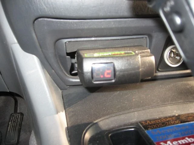

I slid the entire ash tray out, and then mounted the bracket to the top of the ash tray bracket. That way if I ever remove it, the ash tray will slide right back in.
I used a piece of closed cell foam as an insulator on top to take up the space.
What is this thing?
