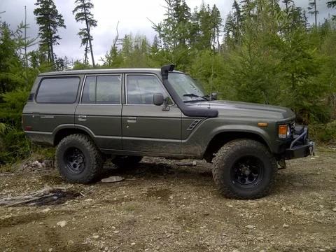

I run the 098 Series. 17X9 4" BS 285/75R17 Toyo Mt's. I find them heavy,
but I'm not totally happy with them. The powder coating is poor and they are rusting underneath the powder coat. They are less than 3 yrs and garage kept.

he is looking at the Rockcrawler model 97... So the one's that Cam is showing in his pic... Still love your truck dude!!!

are you running any type of wheel spacers? Any modifications required to get the wheels to work properly?
Nope, the 17" rims clear all the tie rods and calipers. They are a perfect fit with those tires. In that pic I was measuring tire clearance on the springs. 1/2" clear with full turn front and back to the springs.
Wow, I can't believe they fit. Interesting. I've been looking to go up to a 16 but maybe I'll do a 17!

Cruiserpilot... love that deep forest/army green of your truck. What is the actual color and did you do it or was it the PO?
Cam - I still think your truck is one of the best looking on here. And damn you, DAMN YOU and your Toyota Diesel sexiness!!!!
Make ya feel double bad now....I'm running a 12HT/H55 in mine. The colour is
1969 Ford Black Jade - which I like to refer to as 'Westcoast Rainforest Green'
