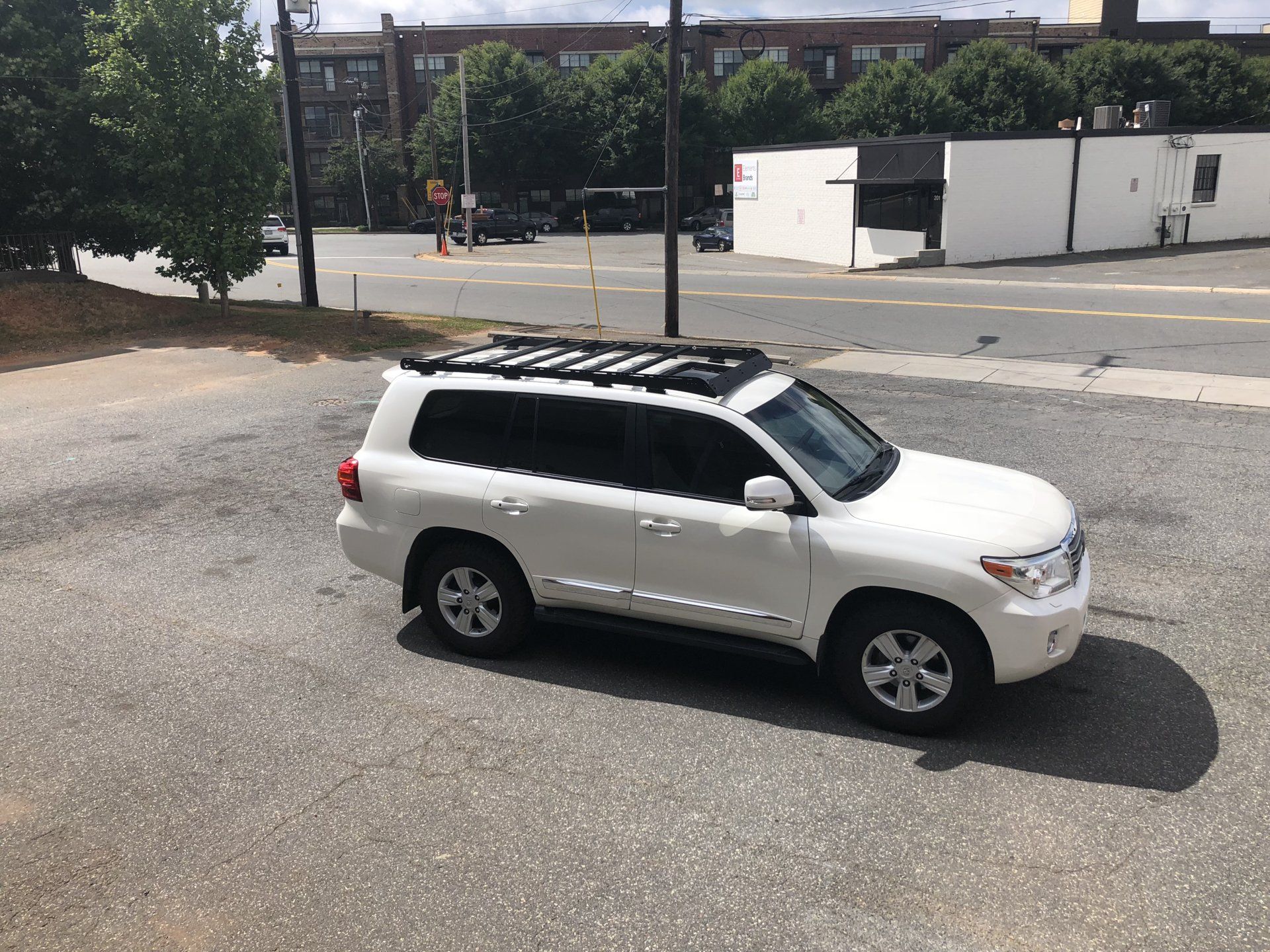

After lurching around here for a while and reading a lot of threads here and on the TW forum, i decided to get a Prinsu rack. After reading several threads on here, the one thing i definitely knew i wasn't going to be crazy about was its interface with the truck. I decided to build my own mounting blocks. It wasn't very difficult and i figured i would post the instructions here to help anyone who is interested in doing this themselves.
First step was to identify what i was going to make the mounting blocks out of. After doing some measuring i decided to go with t6061 aluminum. Generally strong and easy to work with. I decided the feet would be .75" wide and 1" tall. Each foot would be 5 inches long to provide enough mounting surface and area for a sealant. A 48" stick can be obtained from local metal distributors for about $50.
Step 2 - Cut up the metal into 5" sections and file/grind the edges smooth where the cut takes place. A band saw would have been ideal, but i used a chop saw with a friction blade as this is what i had access to.
Step 3 - paint the feet with white poly primer. i put them in place under each foot to ensure they were all the same. There was some variance. not much but some, so i marked them with a pencil and checked all the measurements. Then drilled each one twice with a 1/2" drill bit on a cheap harbor freight drill press at work.
Step 4 - Paint the feet as well as all of the hardware with duplicolor textured undercoating.
After a quick dry fit i resized the Prinsu does not hug the roofline as nicely as i would have hoped, so i went back and made .25" spaces for the 4 corner feet. This cost me another $25 to get a 30" stick of .25" by .75" to make spacers the same dimensions as the feet.
after another dry run, this has mostly fixed the fitment issue. So now on to step 5 - assembly. These are the products i used in assembly
applied liberal amounts of sealant
finished installing the cross bars and tested for leaks today
I still have 3 cross bars left. Not sure if i will use them or not. I dont plan on putting a roof top tent on it. I use it for camping and some offoading and trail riding, but i would not call anything that i do "overloading" mostly some "Homedepotlanding" to get drywall or ply wood. I also have a large rocket box i can mount on here now with out it shaking like crazy at 80mph like it did on the OEM Roof rack.
I will say i am going to have to fix the gap in the front. There is more wind noise than i would like. Its not terrible, but more than there should be.

I went ahead and drilled new holes to drop the fairing. Now there is only about a .5” gap. Maybe less. I am going to put a second cross bar in the front to creat more height. I am going to order a channel filler molding for the top one so it won’t have wind noise. Once I have that I will post an updated photo. This setup should provide some additional rigidity and mounting options as well.

So I have been traveling a lot the last couple of weeks and have just now gotten time to work on the rack some more. I went and picked up a t-channel cover strip for about $4 from Grainger. it comes in 96" sections and fits perfect.

I still need to figure out what i want to do for weather stripping between the fairing and the roof of the truck. I also am going to fill the channels on the roof back in with the OEM weather stripping.

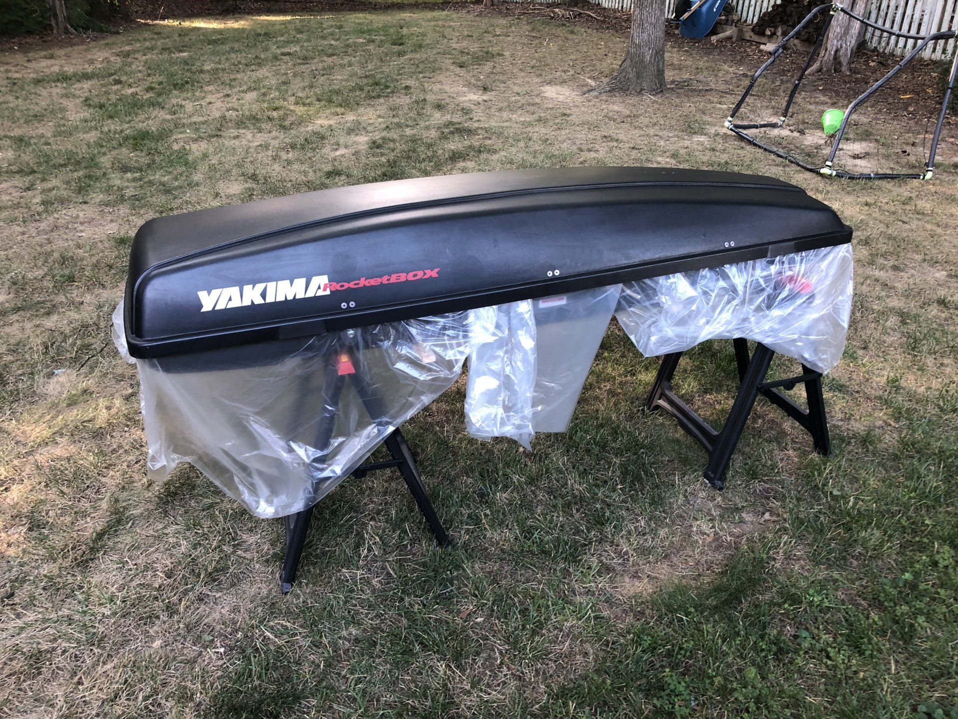

I am going to the mountains in a few days so i decided to go ahead and put my rocket box on it. I decided to plasti-dip it white first though. On a previous trip i had a stick of deodorant melt due to it getting so hot inside. Hopefully this will help some.
right now i have it held on with the factory clamps, but not really that happy about how i have to space the cross bars tom make this happen. next project will be to make custom plates to attache it between the rails instead of around the rails.
