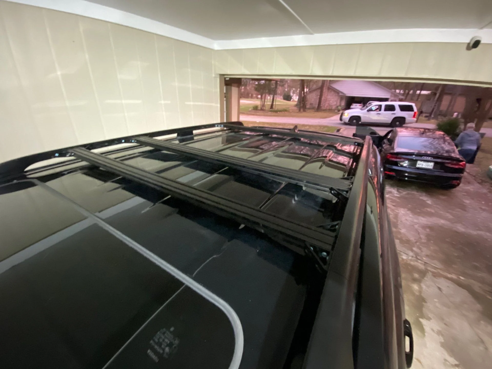

Yes. Coming from the wrangler world last rack I had was by Teraflex, lots of adjustability and was made out of the same 8020 type stuff like the prinsu and was useful. Right now I have just added 8020 stock to factory side rails, but not sure if it going to do what I want
Yes. Coming from the wrangler world last rack I had was by Teraflex, lots of adjustability and was made out of the same 8020 type stuff like the prinsu and was useful. Right now I have just added 8020 stock to factory side rails, but not sure if it going to do what I want View attachment 2197142
Looks like the po po was rolling up on you lol. That doesn't look too bad, I bet the static load capacity isn't as good as the aftermarket offerings but that's to be expected.
He rolled up just as I snapped a pic, I’m LE he was stopping by to chat. I’m just using it for my luggage/cargo box for trips and maybe some maxtraxs
