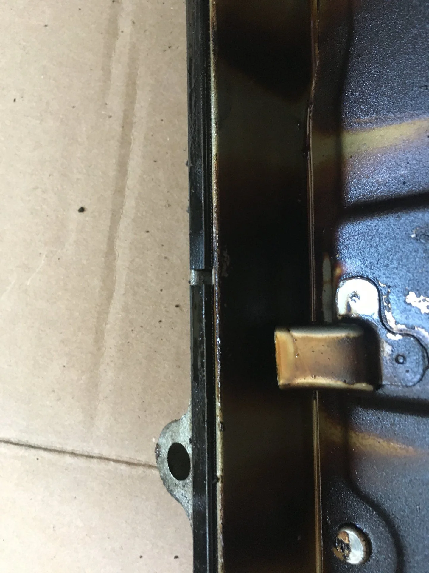

Replace spark plugs at the same time if they haven’t been done. My valve cover was pouring out oil when it hit colder temps. It was a Florida vehicle and I live in Montana. Here is what we found when I removed the valve cover.
