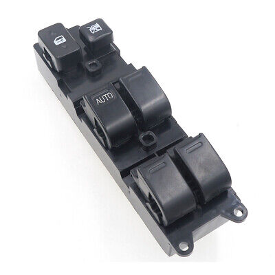

It sounds like your switches are worn out. It happened to mine. The plastic "pin" that pushes down on the circuit wears with age. I had good luck with these:
Yes there are loads of them on aliexpress. That is where I bought mine 5 years ago.
It is not a push down pin but a closed slider inside the unit.
