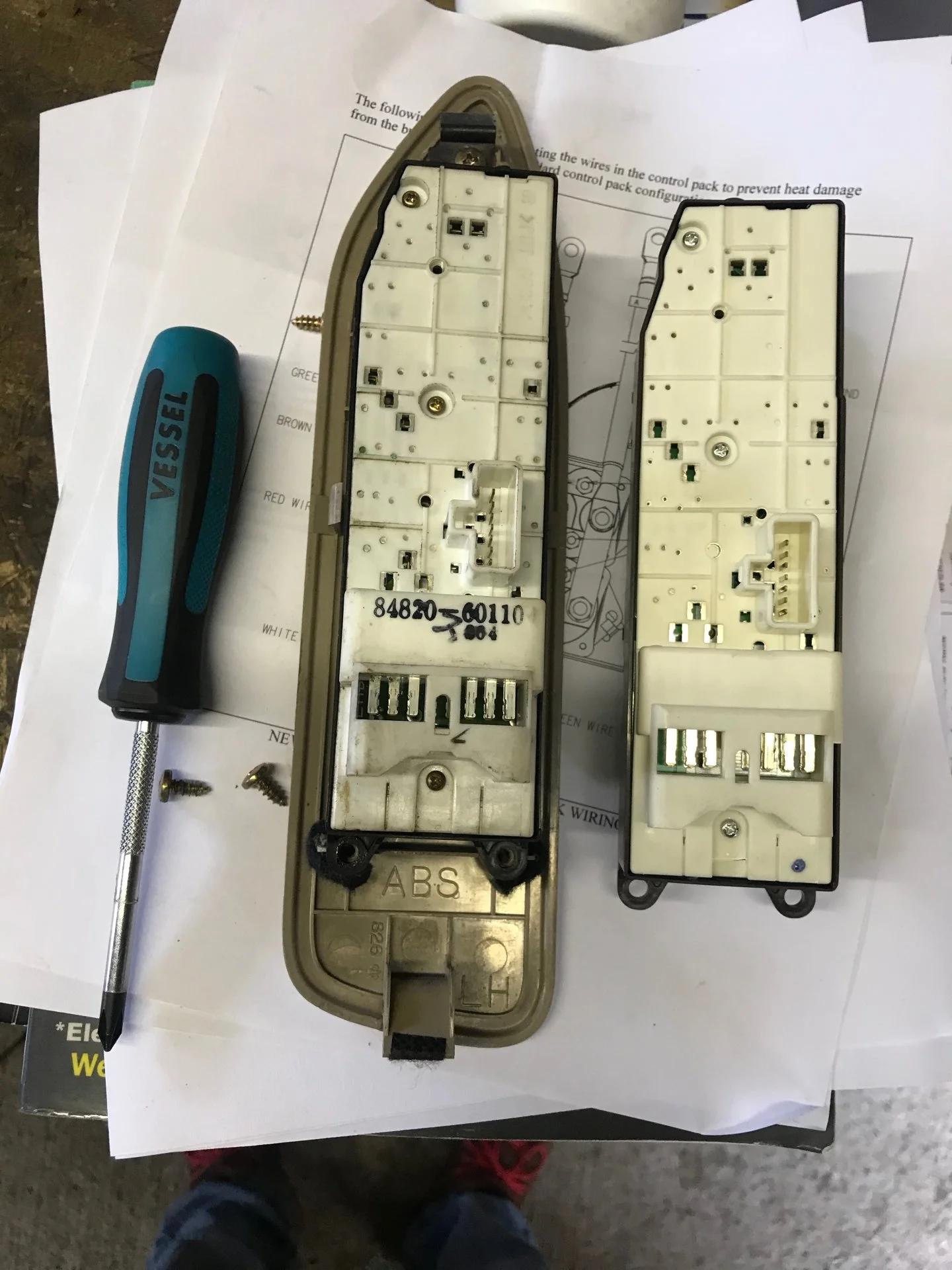

My driver door power window switch has been acting a little funky so I took it apart to see what was going on and the little white plastic "forks" that go between the spring and rocker switch are all broken. Does anyone have a part number or source for them? No luck on google.
Then likely the component pieces aren't available. Source a used one off Ebay or out of a yard, think all the switches in all the models are the same in that time frame for Toyota.
I'm assuming a parts switch is going to be the answer but I wanted to try getting new pieces if at all possible first. The ones in whatever switch I get are going to be just as old as mine.

You may want to hang on to your original switch. I ordered one off eBay and it was good for a couple months before it started acting funky. I ended up taking the eBay switch apart and putting the little white rocker thing in my original switch. It was a little different design but it worked in the original switch. I kept the other 3 for spares. Original works great now.
