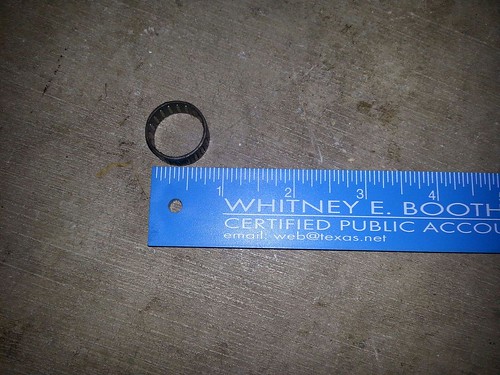

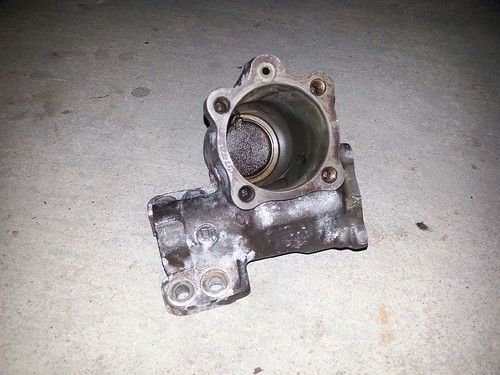

I'm hoping someone can help me out here. I tore my power steering gear box down this past weekend. The box was installed on a 1982 FJ40 which I was told had factory P/S. However after pulling everything apart I discovered the gear box was a ball bearing unit. So the PO must have changed it out at some point.
Based on the features (one oil passage, no power piston plunger) the late FJ60 boxes seem to be a close match. However my unit included a small needle bearing that I can't manage to locate on the parts diagram.
Does anyone know what Toyota part number for the bearing? Or a tip as to what year model gear box I have so I can track it down?
Thanks in advance!
This needle bearing is really small. Those bearings are quite a bit larger. I wish I could recall where it went. I was pulling things apart expecting to have a diagram as to how it all went back together...

Good Point Cult45, and thanks for the tip Pinhead. Here is the ball bearing diagram from a Mini-truck. That looks to match exactly what I have. The only other thing I can figure is I somehow knocked the cage out of the race for the two larger needle bearings when I was removing it? I think I would've noticed that, but I'll double check the larger bearings. If that turns up nothing, I'll play around with the reassembly tonight and see if I can figure where it went.
So it appears there are quite a few rebuild kits out there with minor differences. I'm not quite sure what year model my steering box is from, so I'll try to measure some of the O rings with sizes provided in 44107B & 44107C and hopefully through process of elimination I can determine the correct rebuild kit to purchase.

And for the record, I still can't figure out where that bearing goes. Maybe it came out of something else and somehow got mixed up in my parts. But it does fit the diameter of the splined side of the input shaft perfectly. It's too small for the Pitman arm side of the shaft.
I know this is an old thread, but did you figure out where that needle bearing went? I have the same issue. My brother in law was visiting, he wanted to work on my cruiser, and I had the gear box pulled, so he decided to disassemble it. But then he left, and now that I have time to put it back together, he doesn't remember how everything came apart. For the most part, it's pretty self explanatory, but I have the same needle bearing in your original picture, and I can't find where it goes.

Unfortunately, I dont recall if I ended up finding where it should go. I remember spending quite a few hours putting it all back together. It seemed to work fine turning it by hand. Currently it's sitting in the corner of my garage since I moved over to a CJ style box. I guess I'll figure out if I rebuilt it correctly when it ends up on the next project.
