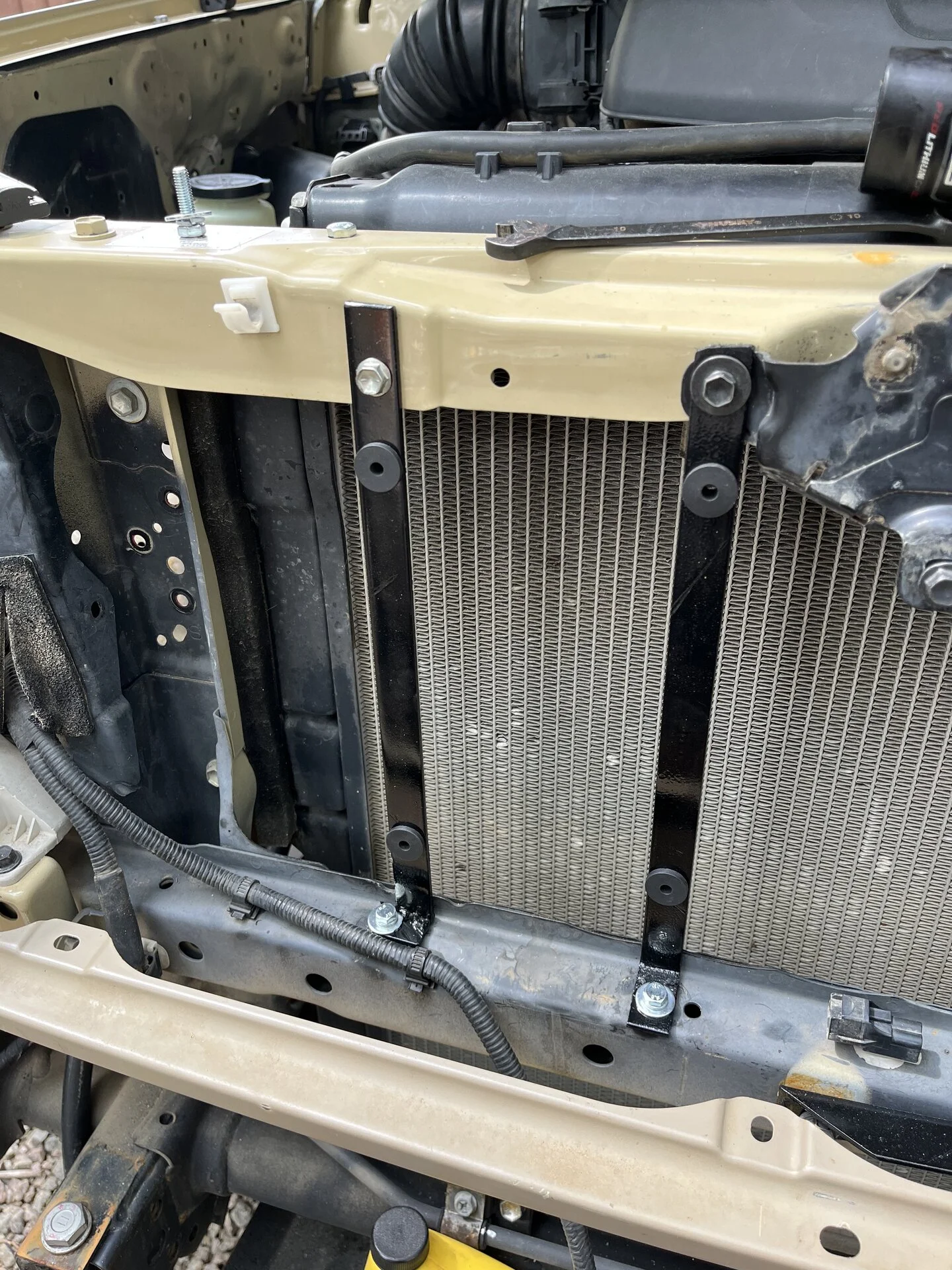

Here is a non-heat sink set up. Opted for a Hayden cooler. Hayden 676 from S. Korea.
Set up using a OEM D3 oil filter up-stream from the cooler. This is for an armored vehicle with other GVM upgrades.

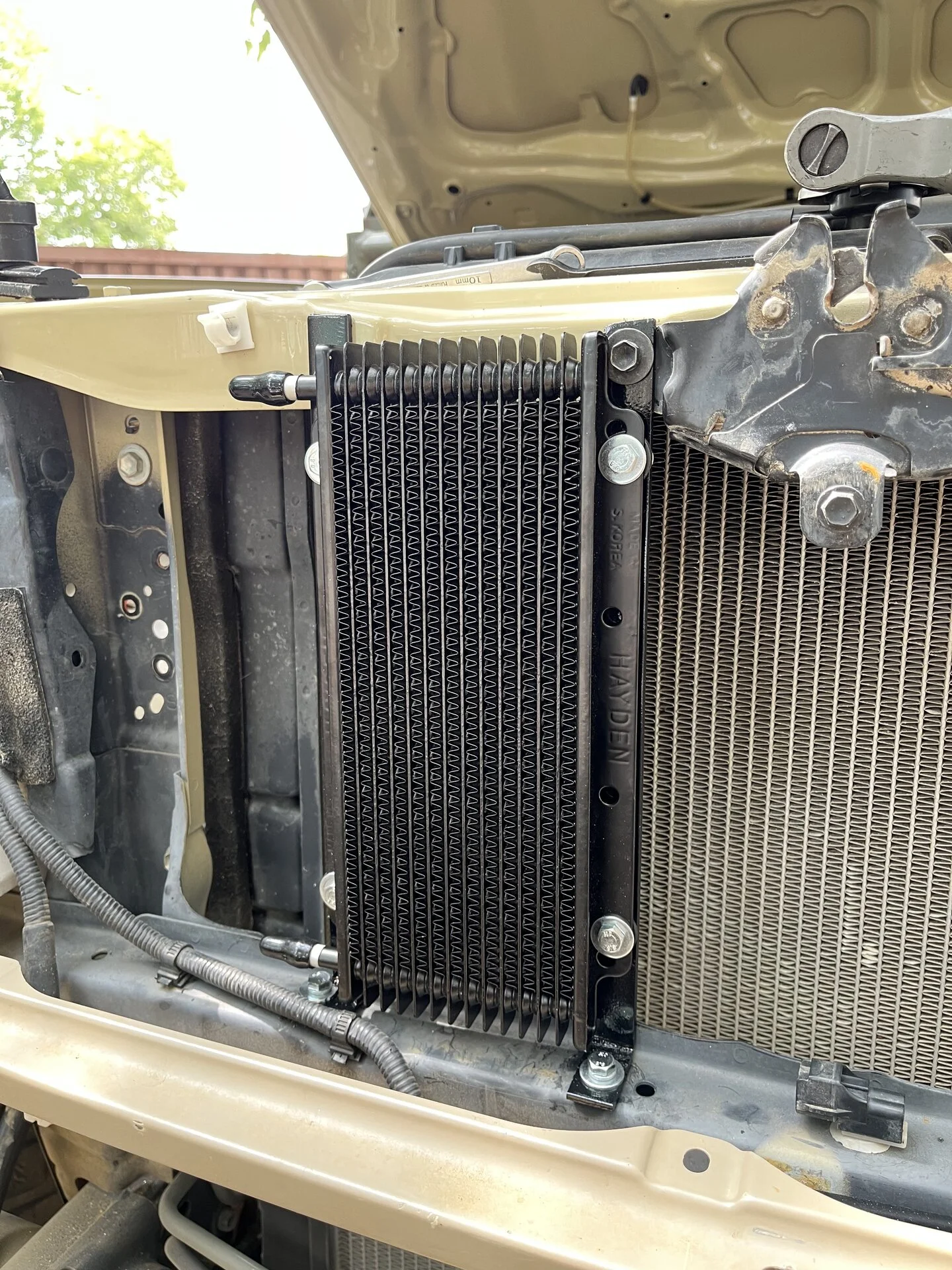

Cooler mounted:

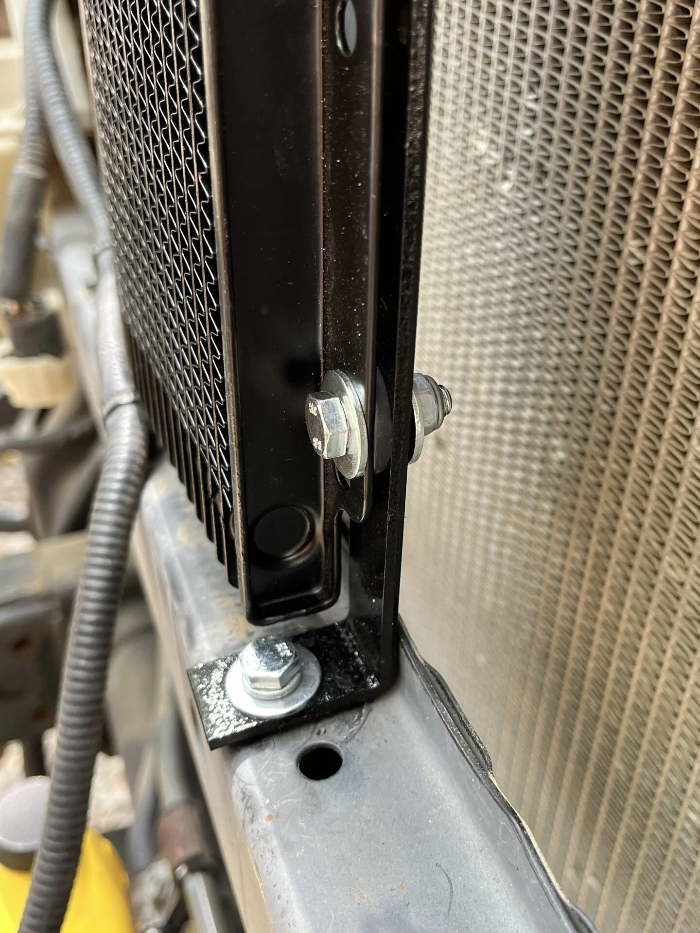

Close up of bracket mounts and rubber isolators:
Brackets utilize factory holes on core support. 2. The 2 lower holes are drilled and stainless nutserts used:

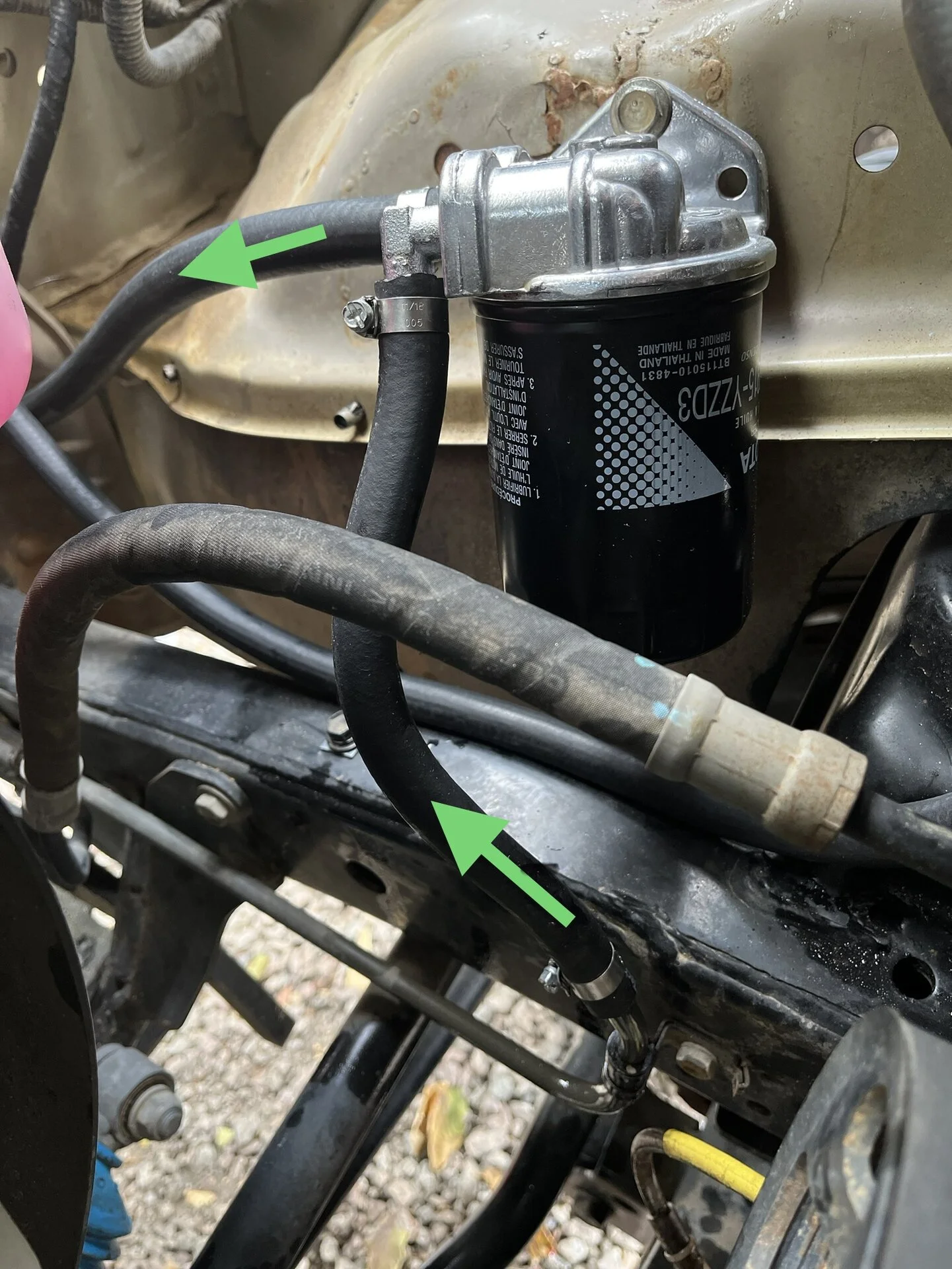

Aux filter set up. Green arrows indicate fluid flow direction. Filter housing made by Derale. OEM D3 filter in use. Not only does this filter the fluid, it also provides extra volume to the system. Very important for keeping the system cool.
