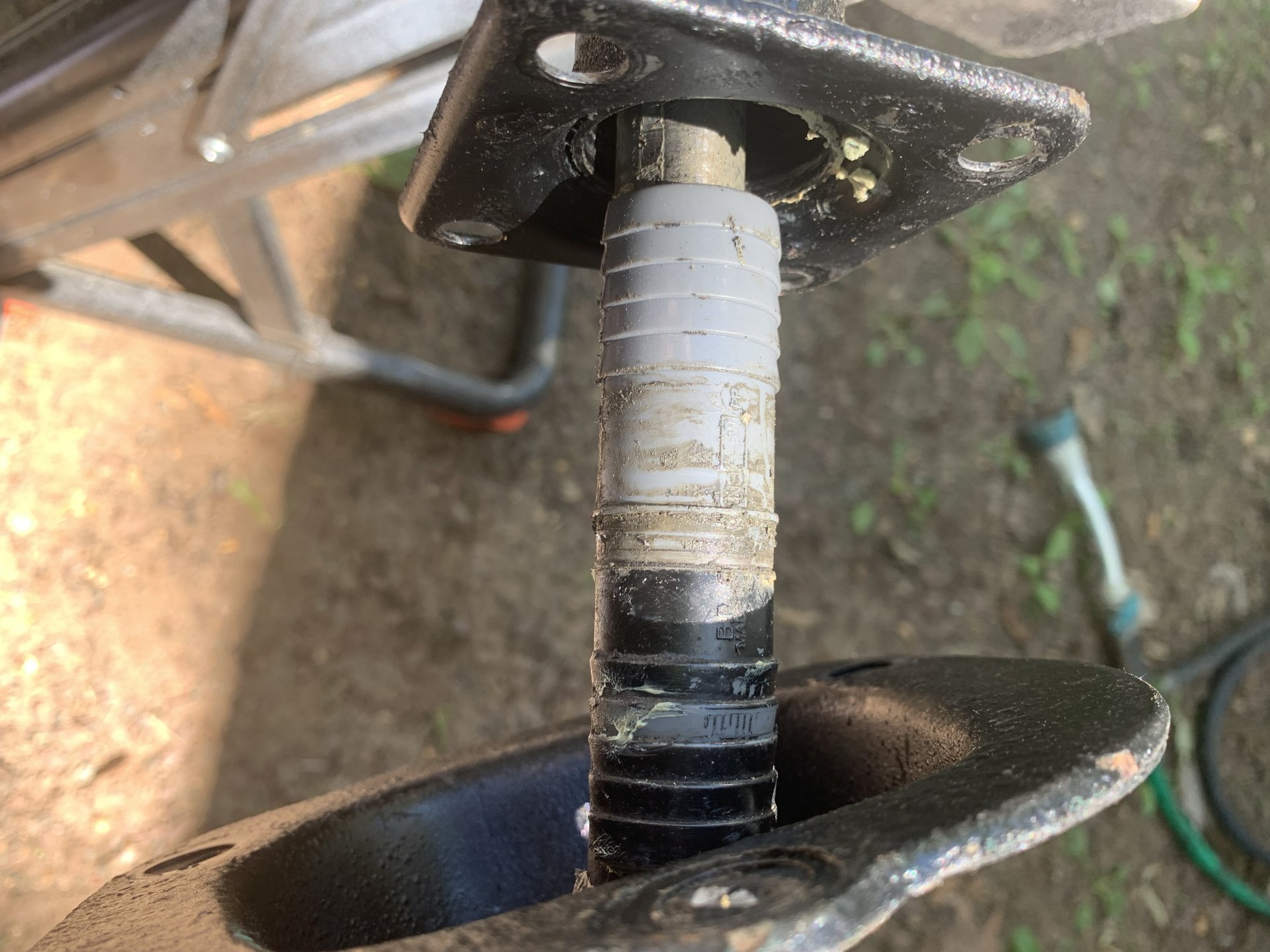

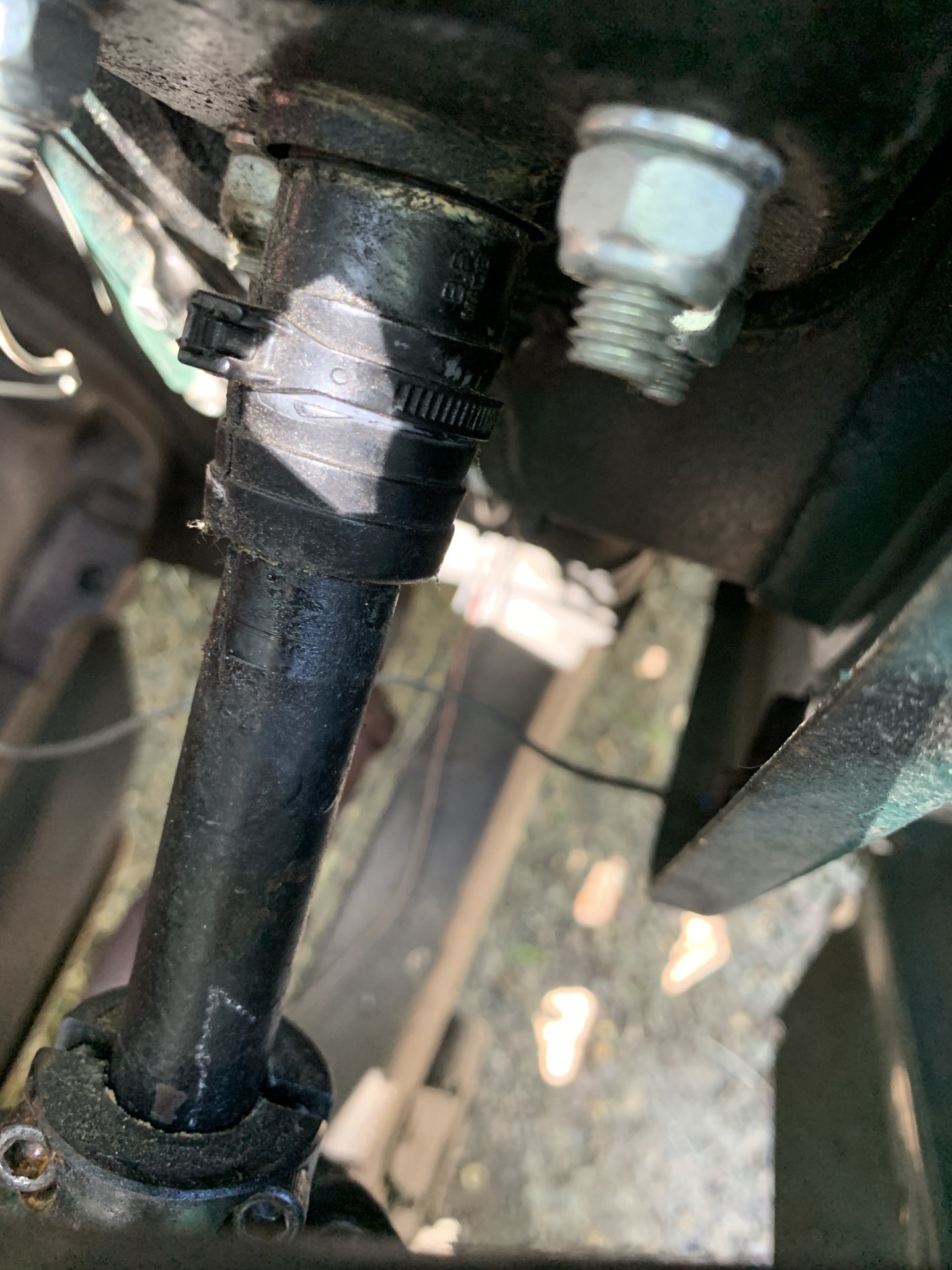

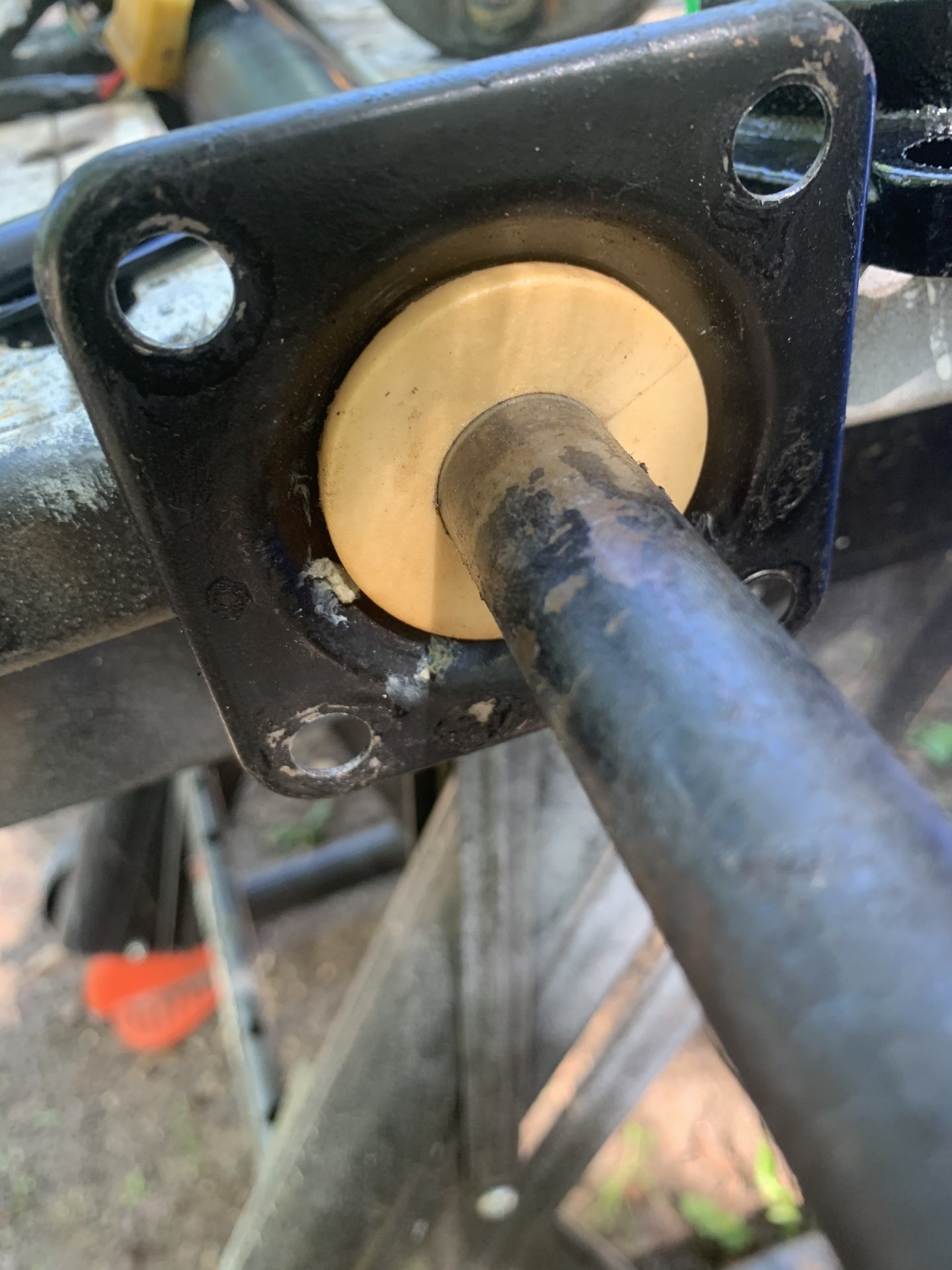

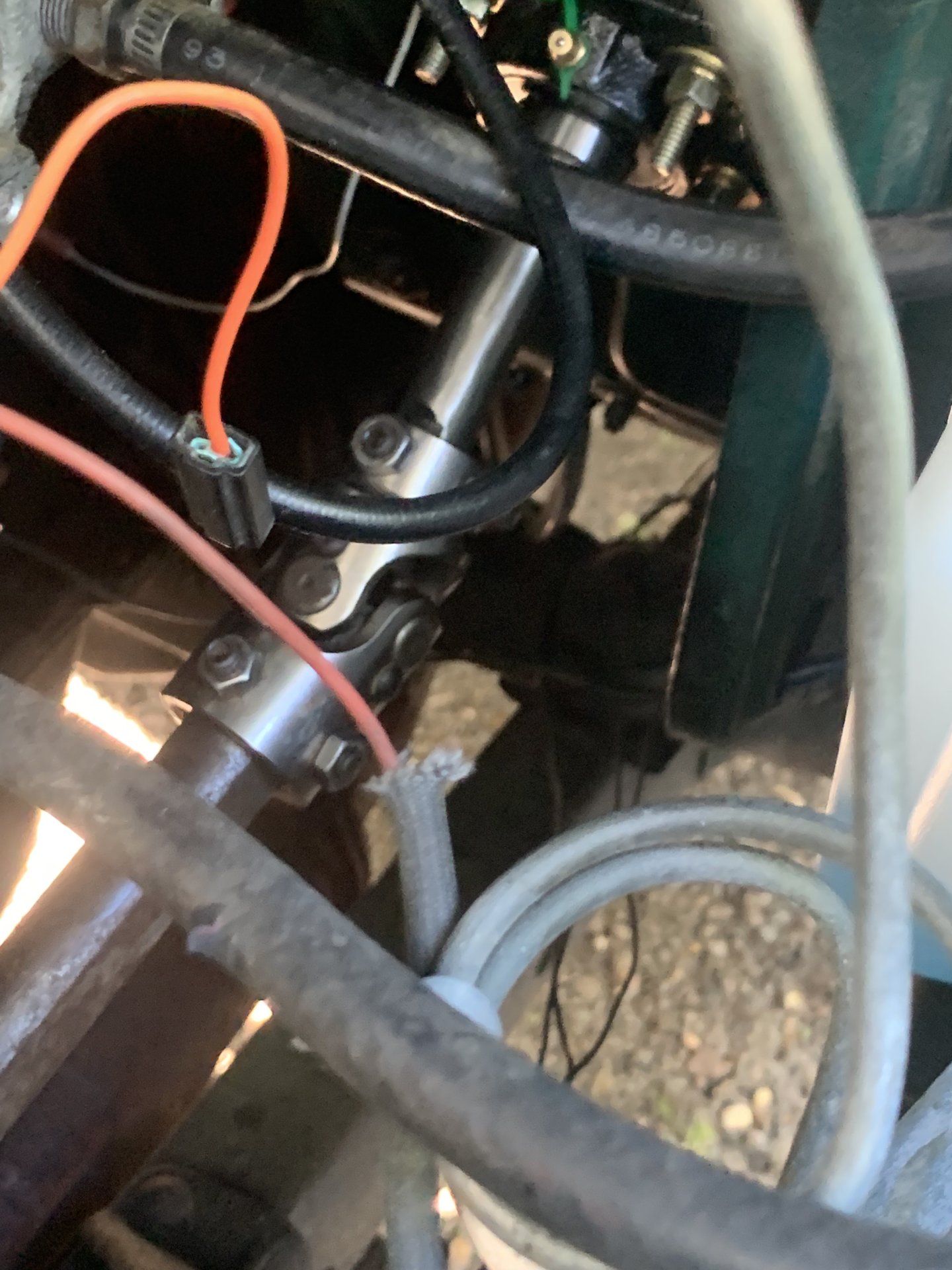

Banner day…had all the parts and the temp was 74 with 45% humidity….big motivation. The Steering shaft from the steering wheel to the rag joint had no bearing or shaft support at the firewall and every bounce and jog transmitted the sloppysteering bumps to the steering wheel. Additionally the looseness of the rag joint was dangerous. Got it all disconnected.

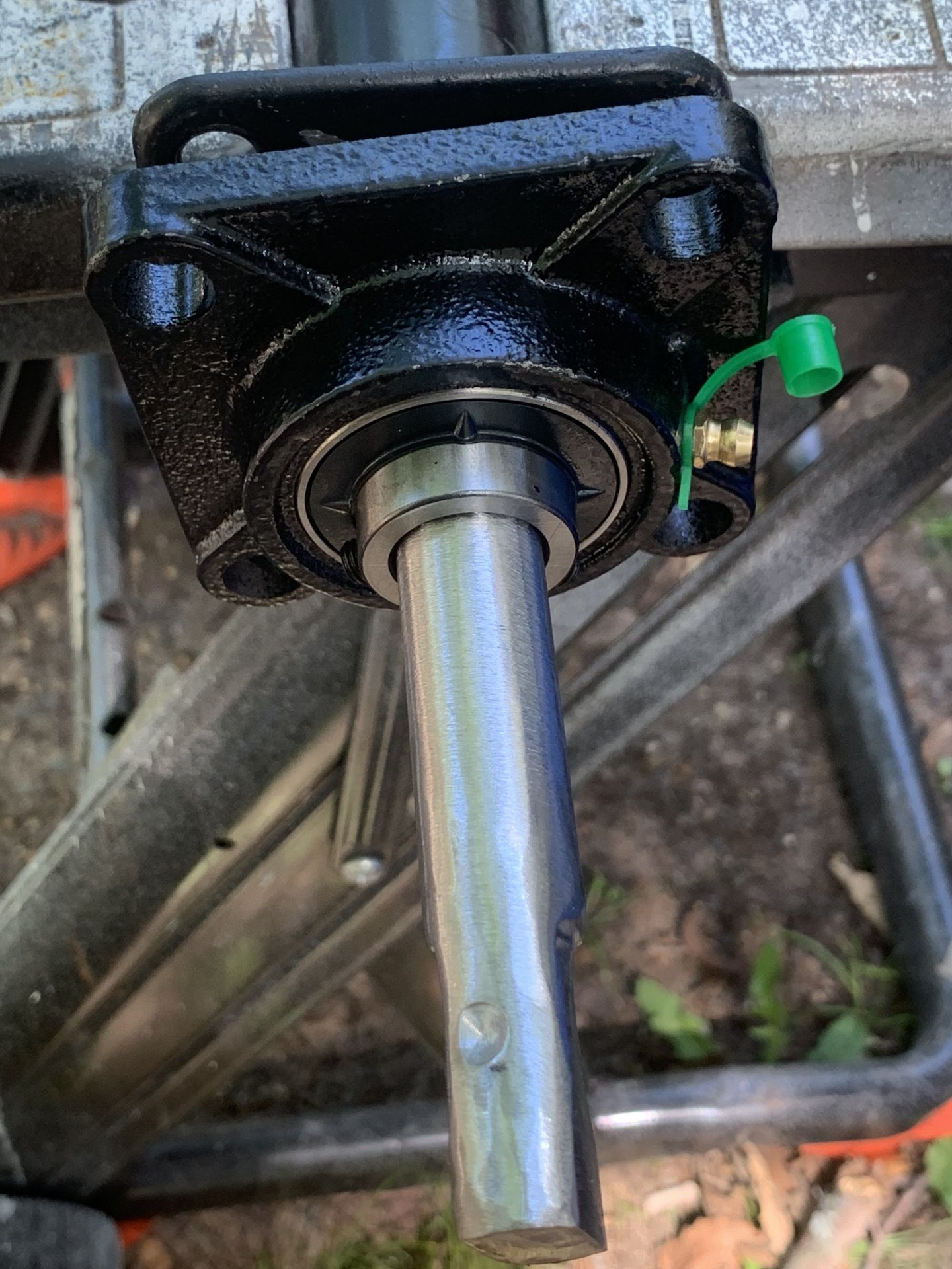

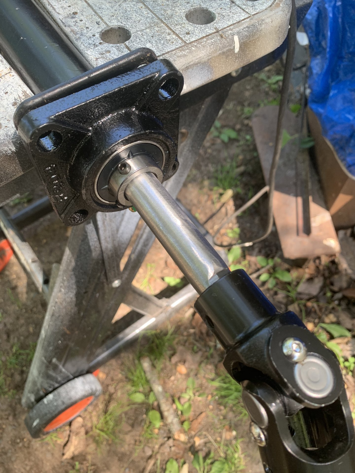

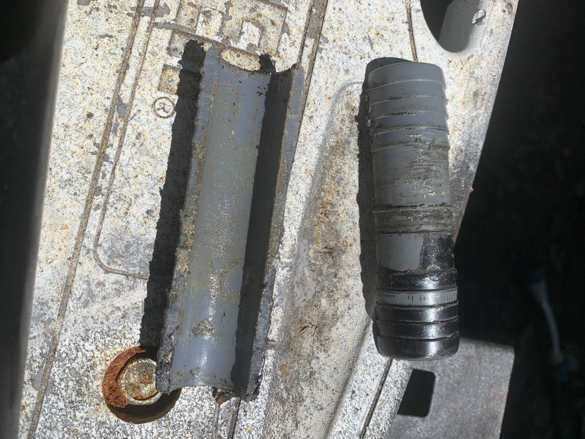

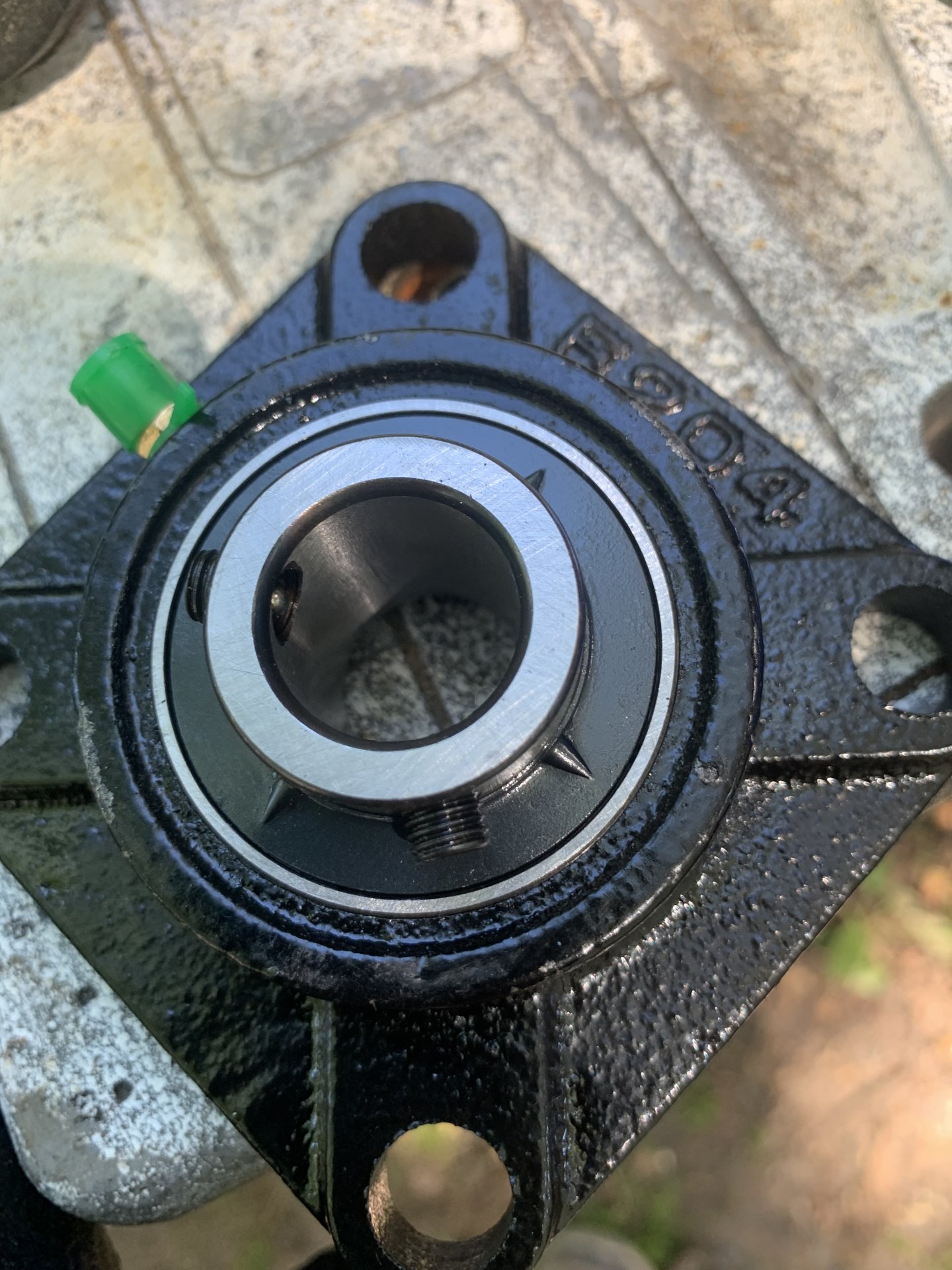

The “ bearing” used in the steering column turns out to be a pvc hose barb coupler cut in half and zip tied to hold the two halves together. in the interest of accuracy, I took the column out and cut the rag joint, shaped the “D” parts onto the shaft and shined up the balance of the shaft to accommodate the flange bearing at the firewall. Slipped on the rubber plug into the column and bolted it all back in after insuring the correct placement of the u-joint and drilling the detents into the shaft….
seems like it went like clockwork all due to the explanations and suggestions from you all… got it all back together, took it for a test,…HAPPY!!!

Looks so much better… I’d imagine it would work better too.
It is so much more secure and firm. By firm I mean it is not like a fork in a giant bowl of spaghetti but has a better solid feel. Like my chevy pickup. It also does not transmit all of those little back and forth jolts to the steering wheel. Worth all the time spent writing to you guys and looking up parts needed. 2 weeks to learn about it and get parts, 4 hours to dismantle and re-install.

Once you have everything dialed in pull each lock pin holding the column together and red loctight them please. I can tell you it is not cool when the steering wheel loses communication to the box. Luckily I was only going 5mph when it happened to me.
Does it have a slip in the shaft anywhere now ? IT needs one.
Yep…collapsible shaft and red loctite when I finished it…none on it when I took it apart
