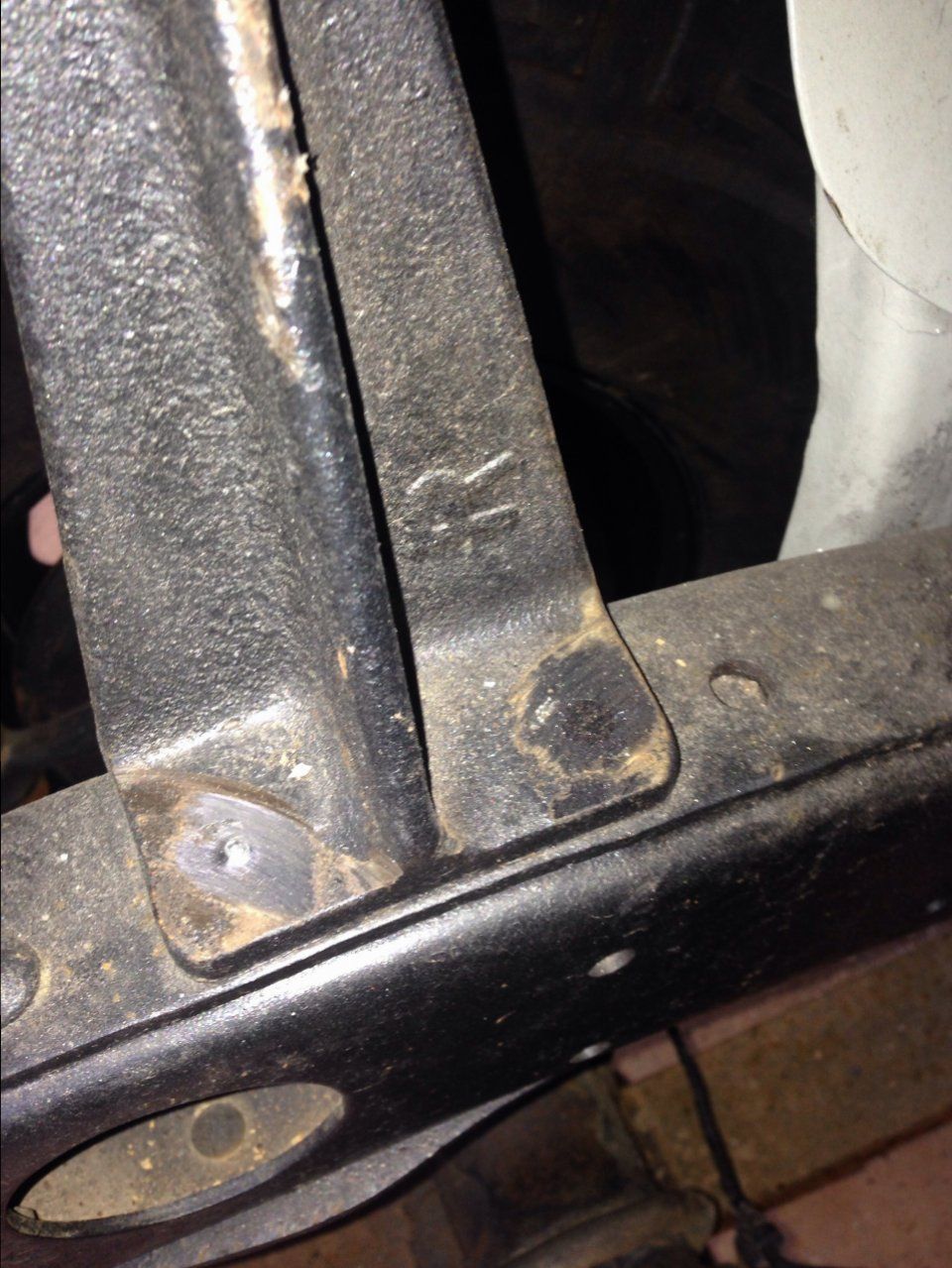

Finally got the grinder, drill, punch and baby sledge hammer out on the weekend.
If anyone tells you the rivets are easy to punch out they're taking the piss:-)
Cut the head off the rivet and tried punching them out. Took a few chips out of the paintwork with the punch being dislodged by the sledge.
Ended up drilling the rivets to the chassis - that made it a bit easier!
Decided to use an 80 series box due to the larger internals, future parts availability and stability at freeway speeds.
Used G-clamps to hold it in position and trimmed the inner guard.
Due to the width of the shock towers and the position of the steering box, the shock is angled with a slightly backward lean.
As I understand it, since the shackle is at the front, it is meant to have a slightly forward lean.
Is this going to be an issue? It's a pin type shock mount at the top - will this help with alignment?
