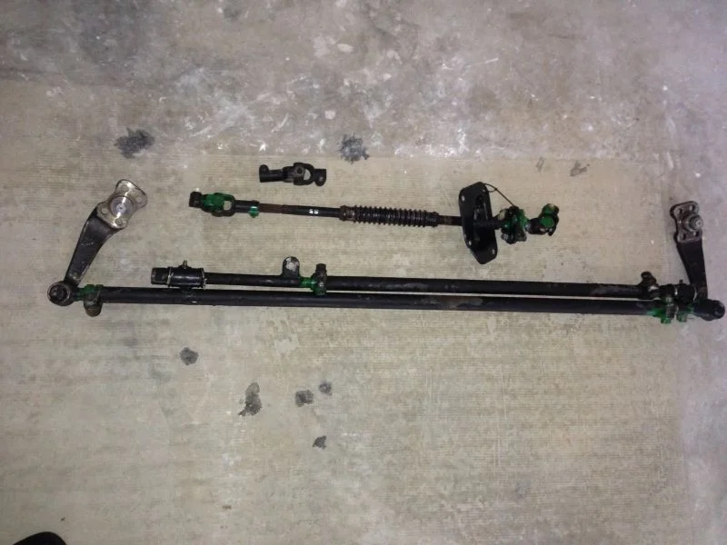

I was just having a look at the variety of shafts I've collected for this mod.
How long is the 80 collapsible shaft? Mine might not be long enough - just by eyeballing it...

I have a variety of different links and arms and tie rod ends etc.
At the moment, rough measurements of the different arms suggest I will be using the following:
60 series relay rod
70 series drag link
60 series (knuckle) arms
60/70 series tie rod ends
70 series relay rod ends
80 series steering box/pitman arm
Looks like I'll have enough adjustment to make all of these work without cutting/welding/re-tapping threads.
I have a 60 series and 70 series pitman arm that I can use (I'm assuming splines stayed the same) if I need to.
One question I have is:
In the photo above, the 80 series intermediate shaft has a rag joint/uni joint combination.
From looking on eBay, the rag joint is compatible between 40 series and 80 series... Can anyone confirm this?
If they are the same, it looks like the rag joint on the 80 column is on a spline - could you take it off and put the uni joint on the spline and then mate the rag joint to the 40 series (non-removable) rag joint?
This would mean you don't have to cut the rag joint off and re spline the 40 column...
Knowing my luck the will both end up male ends (or female ends) otherwise I'm sure someone would have done this already....
