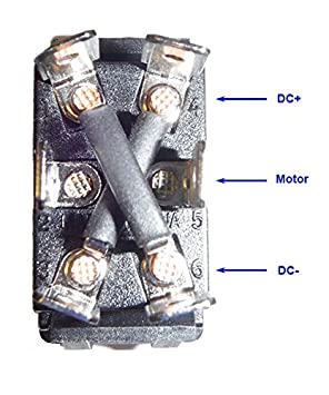

Here's what I got to control the up/down:
It flips the poles when you push the up or down of this DPDT switch. $14 on amazon I got the kind you have to hold in because I just knew that at some point I'd get distracted and something would get broken.
