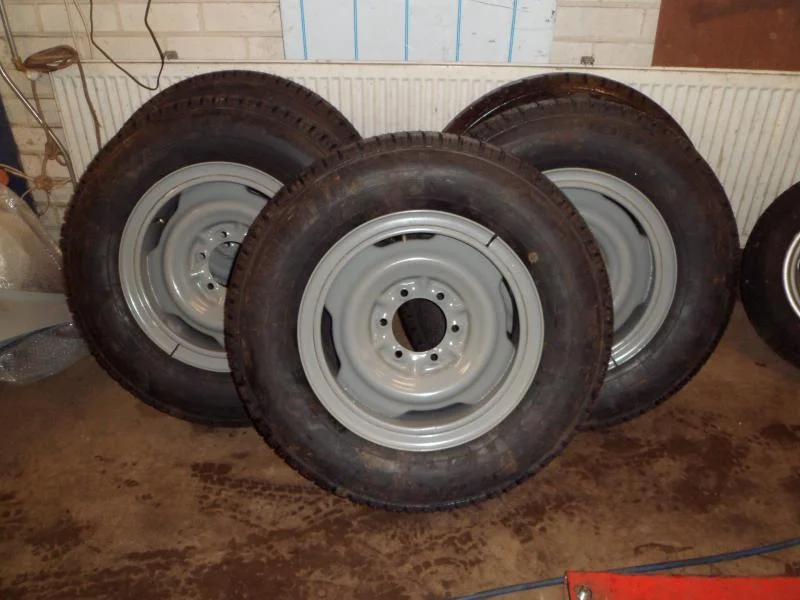

I want to powdercoat my split rims, they should be gray.
Did anybody powdercoated them also and knows the colour code for the powder coater company.

Wow. I just took some parts to be powder coated and the guy said they don't powder coat rims anymore due to grease and road grime getting in the cracks and crevices and causing blemishes after the 100psi with electrostatic charge hits the grease. But those rims look awesome.
The rims were sand blasted by the powder coater before he powder coated them.
For this reason all the grease was off the rims, before the were coated.
