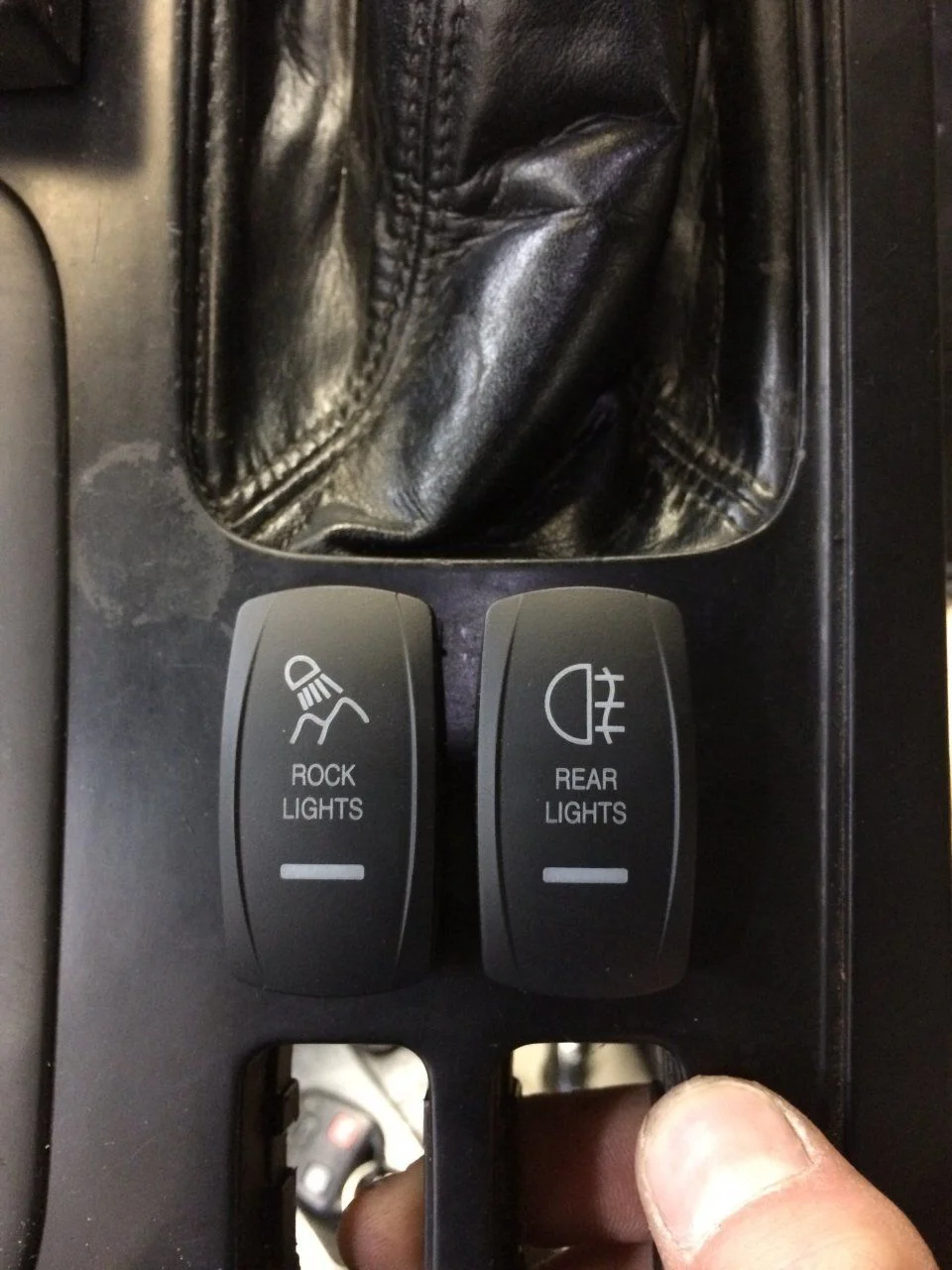

SPDT switch. Tie one side into reverse lights, the other side into constant 12v source. This works very nicely and gives you full control of the aux backup lights.
