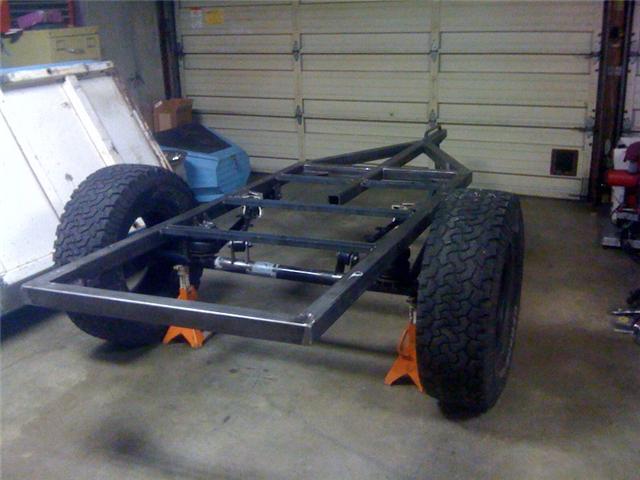

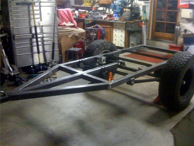

Well I've made some progress. Built a new frame and suspension with a new 3500lb axle. I decided on a 4-link with triangulated uppers sprung with air bags. I'll do a better update with better pictures when I've got more time...

This thing is coming along nicely! And who said this wouldn't make a good offroad trailer.
Cheers. I'm certain I'll be able to tow this thing just about anywhere I need.
