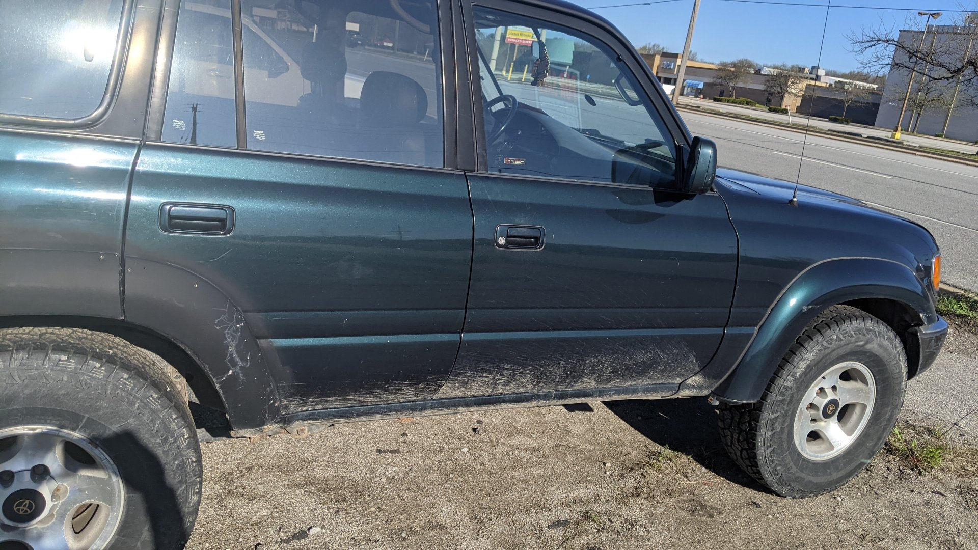

Hi all,
I'll start by saying I've never owned an 80. I currently daily a 97 4R, and have been into Jeeps primarily before now. I was driving home and spotted a green 94 fjz for sale on the side of the road, so of course I went to have a look. It's listed for $1000 with a "blown engine", and after some detective work I was able to track the owner down to have a chat. It seems that it MAY just be the head gasket that has failed because it seems that the only issue is oil in the coolant. Full disclosure, he's an over the road trucker so I haven't gotten to listen to the truck run yet, but before I do I'd be interested in some input from those that know more than me.
Truck stats:
1994
260,000 miles (ish)
Triple locked
The rust situation is extremely good for it being a salt country truck...rockers, frame rails, doors all great. There's a blister under the rear window, but that seems to be somewhat common.
Interior condition is decent, but absolutely shows wear
Suspension and tires seem to be okay, but that's nitpicky even if it ran well.
My questions to you guys are :
How laborous is a head gasket replacement on a 1fzfe?
How laborious is an engine swap, and how easy is it to find a suitable replacement - this would be if the pistons were melted or there was a severe knock or something
Is there anything besides engine failure that can cause oil to get in the coolant....this is both a general and FJ80 specific question. I know there are some instances in jeeps, but it's almost always a bad headgasket and/or a warped head.
Is there anything else that I should look for during an inspection that I may not have thought of? My primary concerns are always rust, engine health, and transmission health but those are applicable to damn near every vehicle.
Any additional input for a newbie would be rad.
The attached pic is the truck in question.
Thanks in advance

Offer him $500.
Blown HG is common at least one time on every 1FZ-FE engine.
You'll be looking at $4000 to do a HG, depending on how much you do yourself.
That includes a fair amount of "While I'm In There" stuff (hoses, radiator, plugs, wires, etc.)
These trucks like TOYOTA parts. Buy from McGeorge Toyota Online, Partsouq, or local dealer
This will likely need full baselining of all axles and electrical. It's a 28 YO truck with 260K.
Odds are the block is fine, it just needs a HG and the head reworked UNLESS it's been sitting with coolant in a cylinder for 6 months or more. Then you may have cylinder pitting due to to stupidity.
Unfortunately, it's green.
Get whatever maintenance records he can provide.

If you're not going to do the work yourself and going to pay a dealer.....double the numbers.
The key is to follow the FSM. If you've done a Jeep, you can do this, just follow the FSM and the videos.
Engine swap with a like kind and model is easy. Can do it in a weekend. Finding one that doesn't need the same thing will be the hard part.
Engine swap with a SBC or LS will be in the $xx,xxx range. Some will say less, but not many.
If it's not rusty, you want an 80 and you are prepared to feed it time and parts for a while then I say go for it. Depending on how far you want to take it you could easily spend over $10k in parts "baselining" an out of date 80 but you'll end up with an amazing rig that's ready to run for a long time to come.
I picked up a sub $2k triple locked 80, with no rust, back in '97 and am about $15k in parts into it and have enjoyed almost every minute of the work and driving of it. That included the head gasket and a ton of "while in there" stuff and maintenance during the over 55k miles driven in it so far. You definitely don't have to go that route and could just fix the HG and then do the minimum required to keep it on the road but many of us end up wanting these to be as reliable as possible and to drive as well as they can so we keep going with the repairs and I think it's worth thinking beyond the initial repairs before you buy.
If you are on a similar path to what I describe above $1k vs $500 doesn't really matter in the long run. Rust and paint/body condition may be the two largest variables in terms of long term cost of ownership as they are the most expensive to address typically.
Given your experience you'll have no issue with the HG work on an 80. You do want to take the head to a qualified machinist for inspection and to have any service work done on it but I'd do that with the head(s) off of any engine and don't see it as unique to an 80. It may take some effort to source them but you should be able to pick up a used head or engine as needed if you have to go that route but it's of course hard to say until you open up the one in that '94. It is possible that the oil cooler or it's seals failed and caused the oil-in-coolant scenario but the HG is more likely.
Good luck with the decision.

Thanks fellas. This board is way more active than I figured....I appreciate all of the information and am stoked that I decided to post up before even taking a legit look at the truck. Honestly, if I can get it back on the road with confidence in the reliability for $4k, I'd be pretty happy about that. It would almost certainly end up being my DD because they're beautiful vehicles, and I work from home and can eat the 11mpg for the time being.
Either buy it or pass along the info to the forum so 1st come first served to buy it and "Rescue" it from a scrapper.
The big question is whether there's water in the cylinders. That's the difference between a simple head gasket replacement versus having a rusted, locked up cylinder.
If I were you, I'd snatch it up for $1k, no questions asked. In the current market, you could easily flip it for double that, especially to those Facebook dorks.
