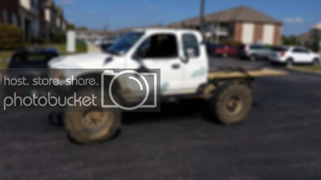

So the Tacoma left the garage for the first time since hoe down and I have a few questions.
I have reduced the drive line vibration from extreme sybian ride down to a French tickler level of vibration with new u joints, grease and cutting off the bent spline guard. The driveshaft is still visably out of balance (1/8" of "flop") and is bent, is this something that can be fixed with a retube?

Yes a retube should fix that.

Just had to prove that you can still do truck things with a 4ft frame behind the cab. So give in and truggy it out like you know you want to.
Damn. Look how much more work Connor gets done, even without a build thread.
Nice! How does it drive?
So now its a short bus storm trooper!
