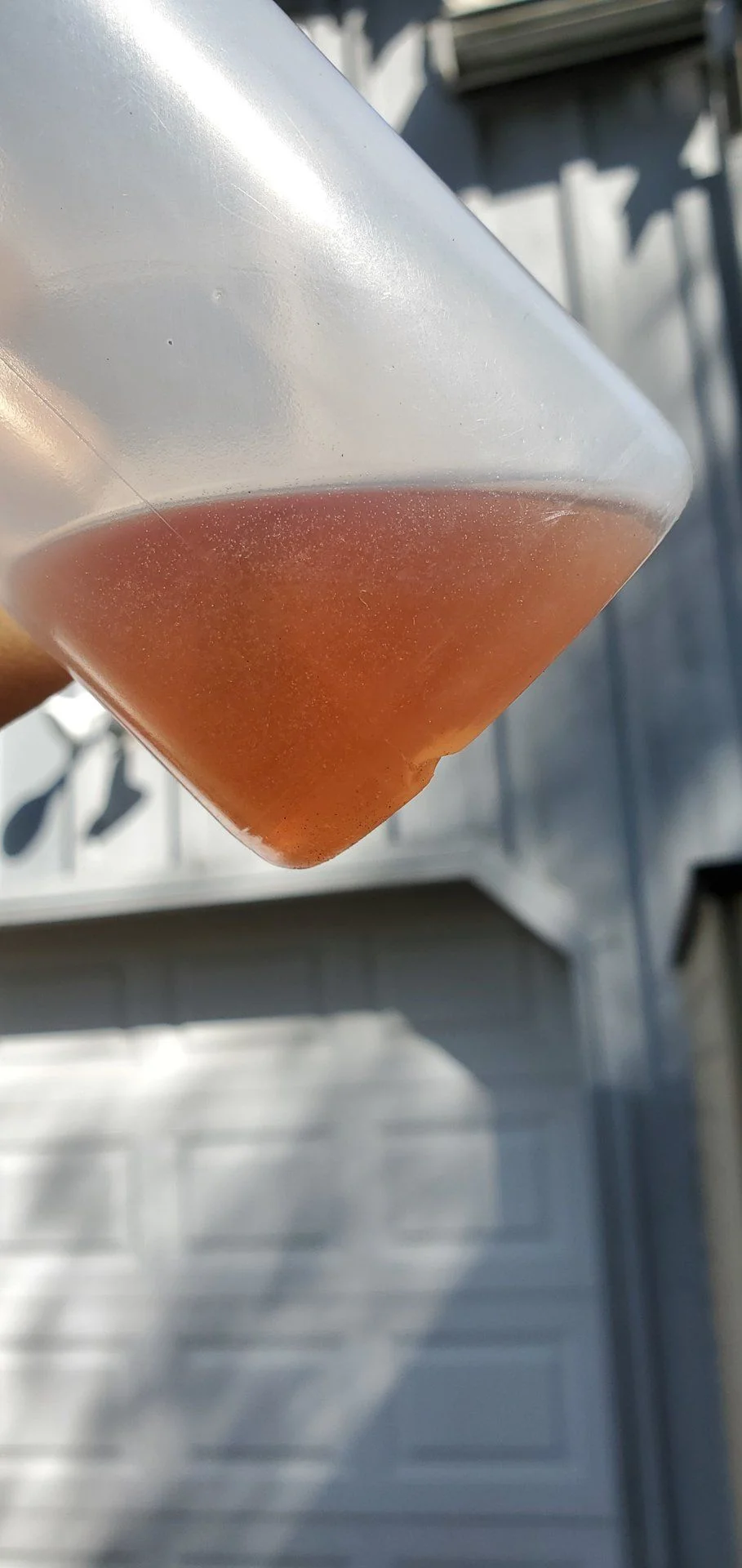

this is the fluid that I bled out of the left rear looks good to me but there are lots of teeny tiny bubbles and I have no idea what that means
Normal. Henry’s law of gaseous expansion. Open a soda bottle and it fizzes = Henry’s Law.

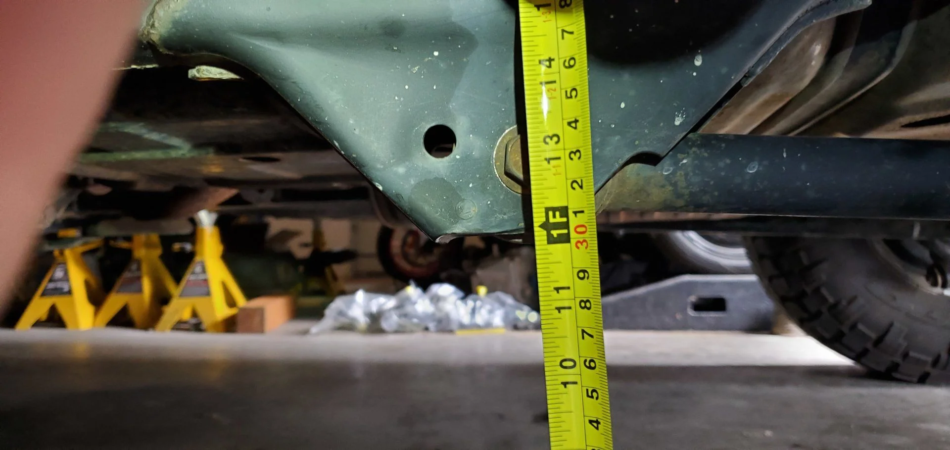

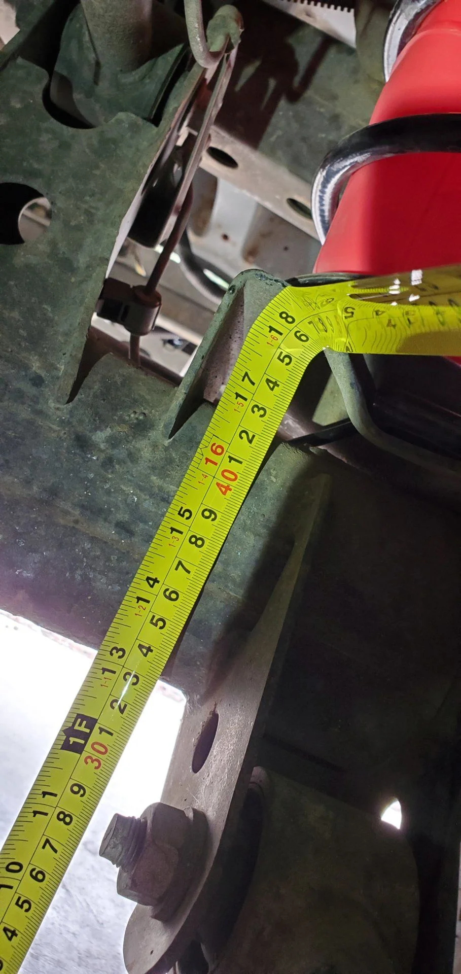

I'm not sure where the center of the rear axle is here, if anybody could give me some help
Update, I realize that the center of the rear drive axle is also the center of the Hub so I just measured the center of the Hub which is super easy but also reminded me that tire pressure could mess up all of these readings
This is the driver side which is 1/8 in higher than passenger
Driver side was equal to this and I could not get a picture of it but the forward control arm bolt was exactly one foot off the ground on the passenger side and 1 ft 1/8 on the driver side
These are my actual ride heights Hub to Fender and I was very very careful to get an accurate measurement to 1/8 of an inch
Right rear 20 and 5/8
Left rear 20 and 6/8
Left front 19 and 3/8
Right front 19 and 2/8
No driver, 50lb box in back and metal rear bumper
Front to back rake is 1 3/8 inch
My ride height measuring the suspension is 15 2/8 vs 12 1/8 so...difference of 3 1/8
And the rear is 15 2/8 vs 12 7/8.
Which is 3 3/8
FR 3 inch height difference
FL 3 1/8 inch height difference
Rear is 3 3/8 difference
So the rear is 5/8 to low
And the front is about 1/8 inch low

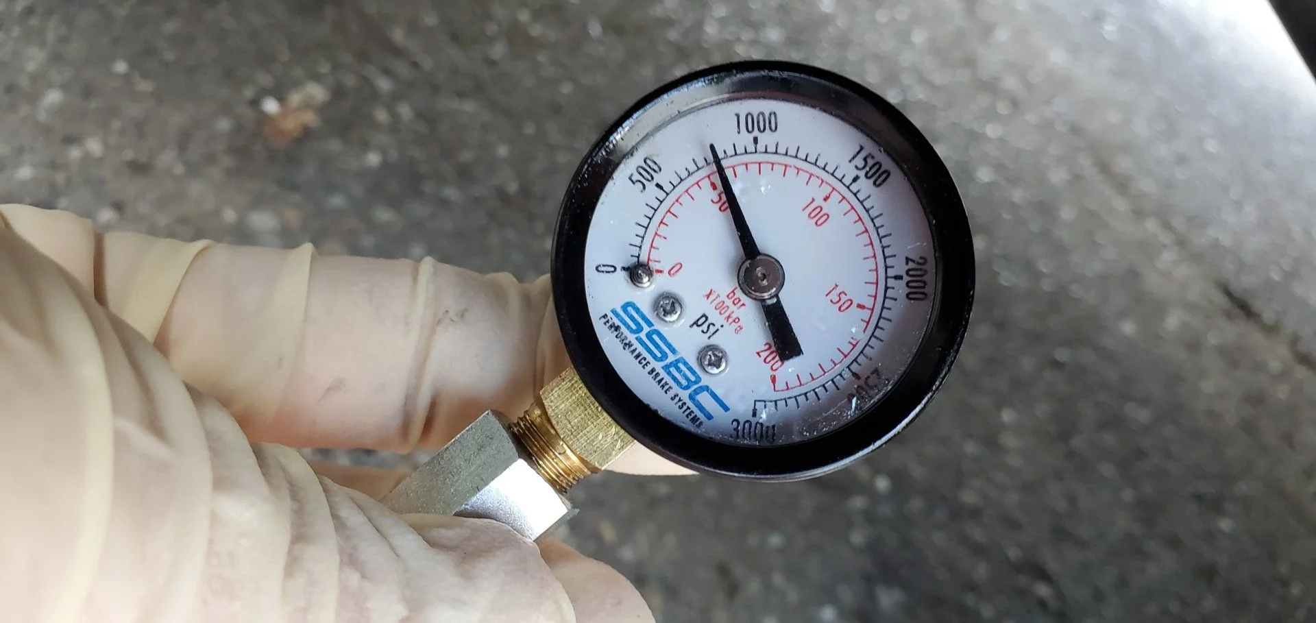

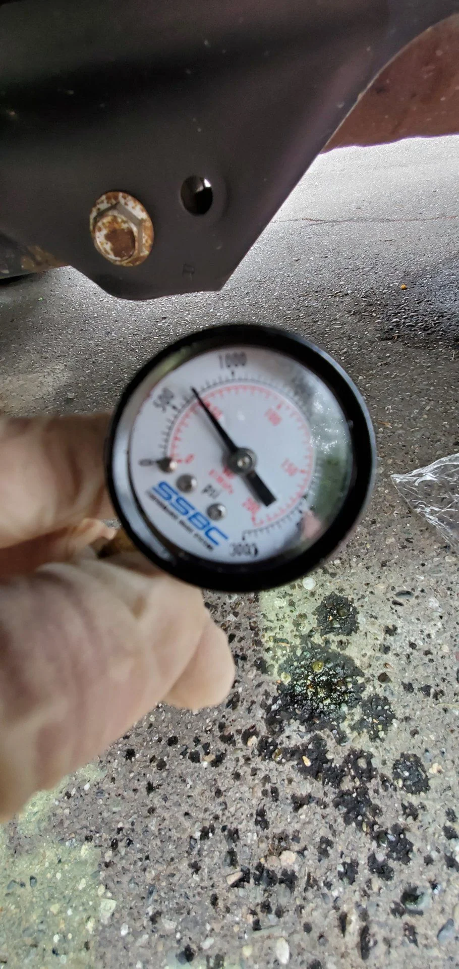

I had to move outside so the so the truck is about 1 inch higher in the front because of the ground anyway, the front right pressure is about 290 PSI in low mode and 700 psi in N mode
this picture is hot garbage sorry but I believe it is right at 700 PSI
As expected the rear pressure is a little bit High because of the slope but I think it is close enough to say that it is fairly accurate..... the right rear in low mode is just a hair over 400 PSI and an N mode it is right at 700 PSI
You want 825 psi front and something like 725-750 rear at your chosen N height. Low and H pressures don’t really matter, nor does the 16 step damping at anything other than N either, unless you install a height override and drive in H. Then you’d reset pressures to your actual driving height on the understanding that with the speed inputs to the ECU removed (that’s what the height override does) then your damping stays in position 8 front and rear.

Front right 700 which is 125 psi low
Rear right 700 which is 25 to 50 psi low
I can easily back the torsion bars off too increase the front pressure which would probably increase the rear pressure a little bit?

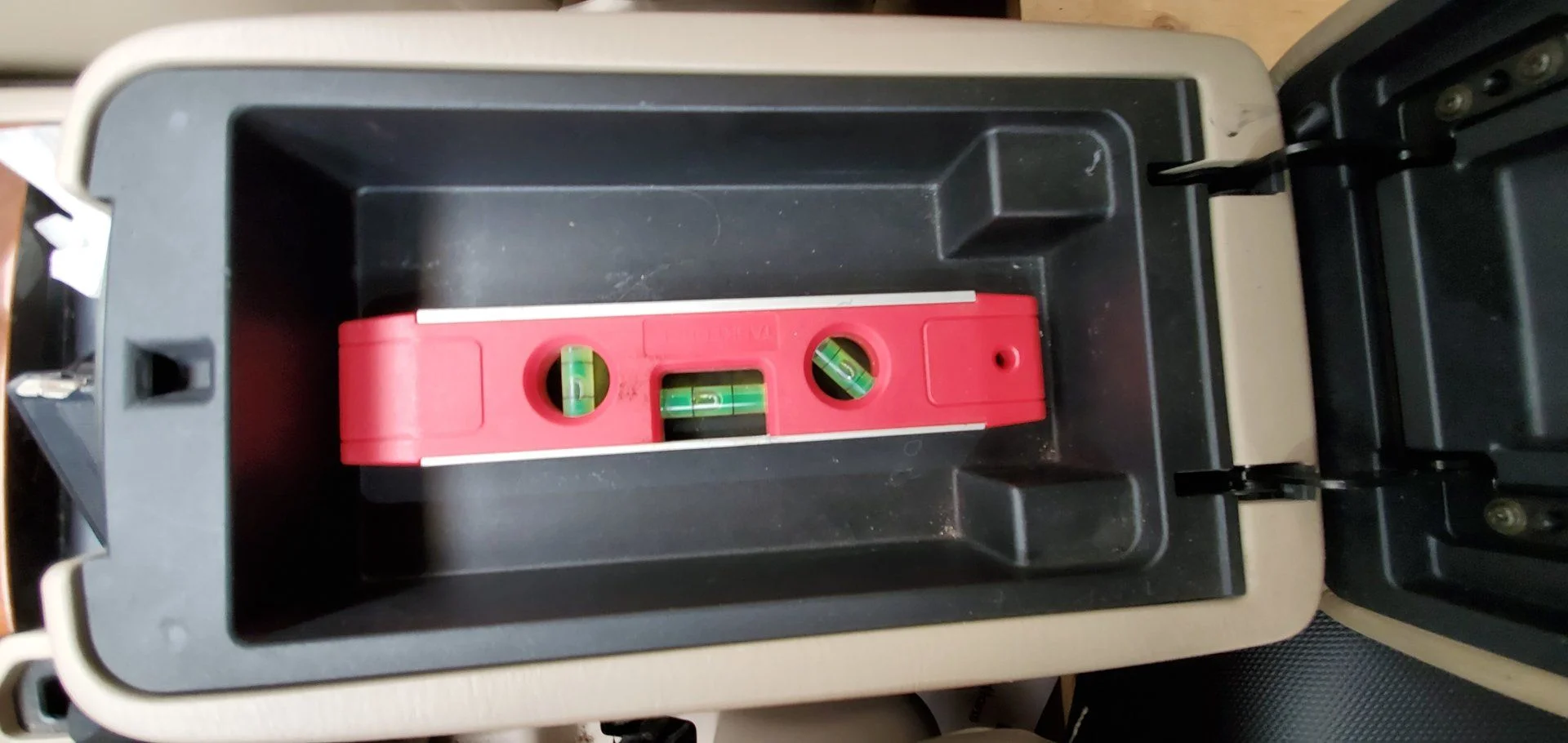

It's not much but this is a picture of a level sitting in my center console where I took these pressure readings it would take me at least a week to clear out my garage enough to be able to take readings on level ground but if @PADDO thinks this level is indicating enough of a lean to constitute taking measurements again will find level ground
