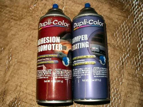

I used bumper paint and an adhesion promoter to do my duct. Turned out great!

The plastic paint form ACE made by Krylon has held up in my cruiser fairly well. The key to painting any plastic is good cleaning. if the plastic is newer you need to use something that will remove the mold releasing compounds. These compounds will prevent anything from sticking well. A cleaner that removes wax, oil, etc. is especially important. A good place to check out info is on ATV forums as a lot of them spray their bikes with good results. I have sprayed mine also using an adhesion promotor afte careful washing. I didn't use a plastic specific rattle can paint. On older cruisers i doubt that there will be huge issues with adhesions if the surface is properly prepped and cleaned.

I sanded the whole thing to remove the 'dead' plastic, used JB Weld to fill in a couple of gouges, sanded that down, sprayed on the adhesion promoter, then the top coat. It's tough stuff. There are pics of this on my web site under the heater section.
