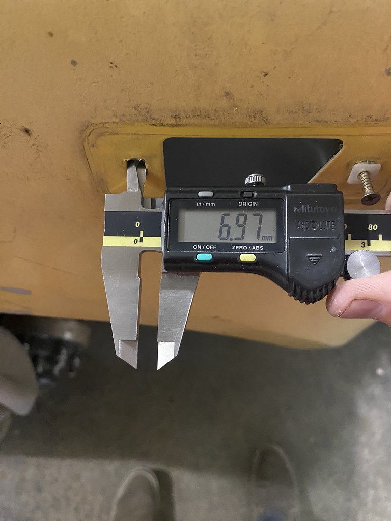

Did some measuring last night really quick, these are rough but seems like most holes are 7mmX7mm and 9mmX10mm
Side marker
Headlight bezel mount
Headlight bezel/corner light mounts
This would mean that the following two should work:
