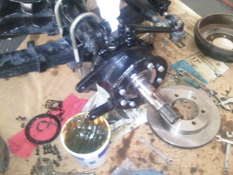

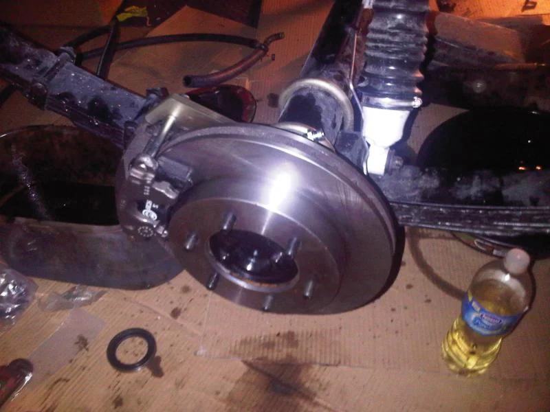

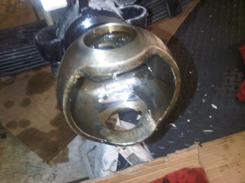

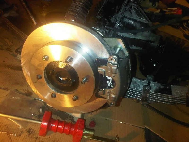

I am installing JT Outfitters kits for both front and rear. So far, in the front, the rotors opening is a bit smaller than the diameter of the ring that holds the studs. I have to get the rings machined. So I had to stop on that today. :(

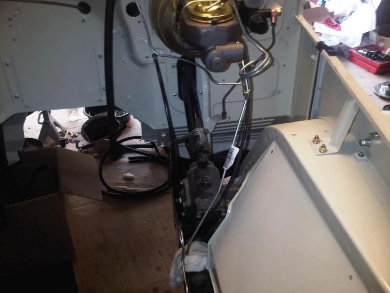

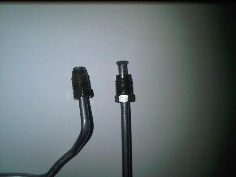

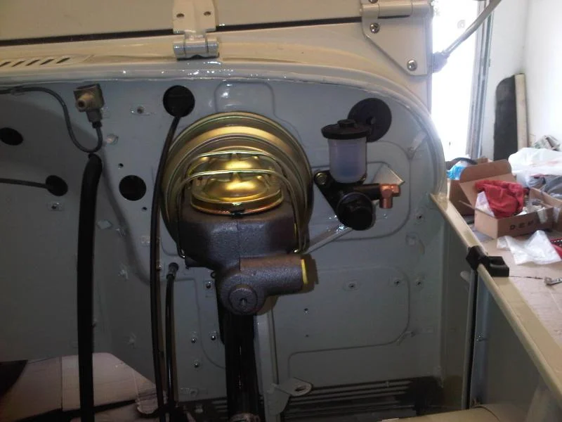

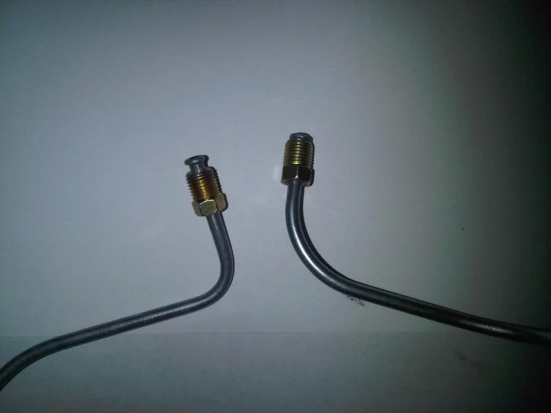

New SOR brake line fittings were modified to fit into new prop valve of the new booster. :)
One of the front circuit ports was capped, the rear port was fitted with an adapter to accept the new line fitting.

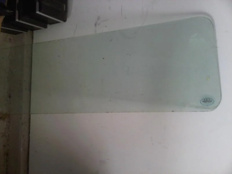

New windshield! :) From Binswanger Glass, laminated Solex (greenish in-glass tint no film, DOT approved). $102 after tax. F.M. 1960 between Ella and Kuykendhal in Houston, TX.
Comparing old OEM glass with new one.
My old one is still usable if anyone wants it, some PVB bubbling in the bottom, I think it was unnoticeable with the weatherstripping, it has a newly installed legal charcoal tint film along with its stock antifreeze sticker. I'm guessing $30.00 in Houston or Dallas. Remember mine is a 1970 model so it may not fit others.

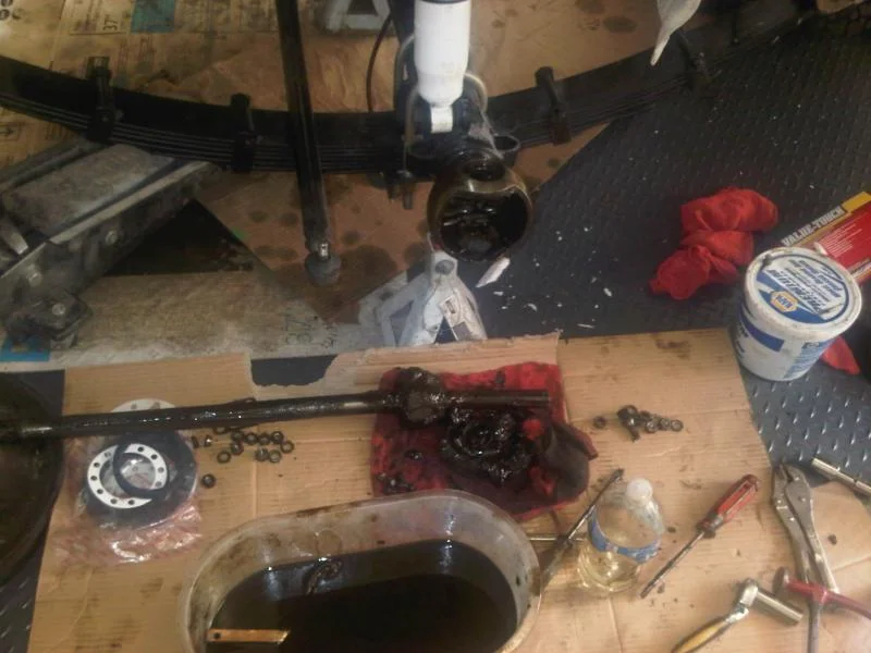

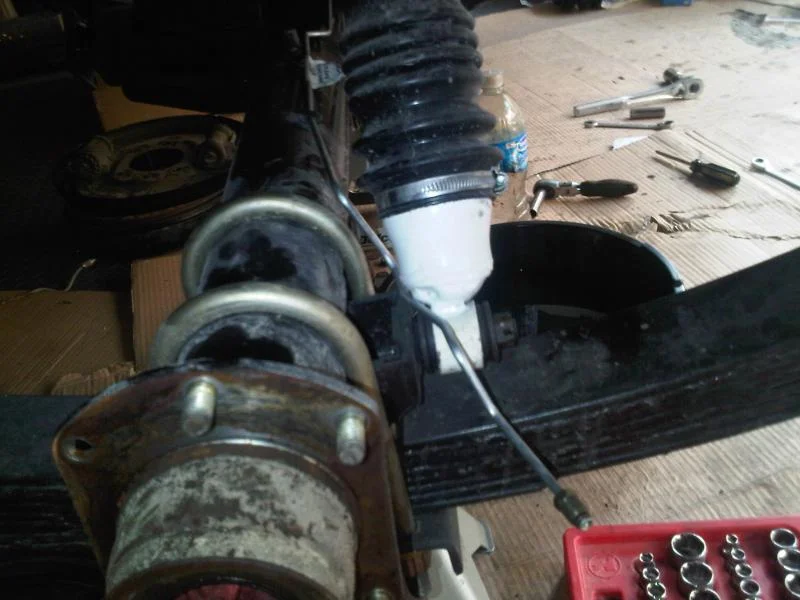

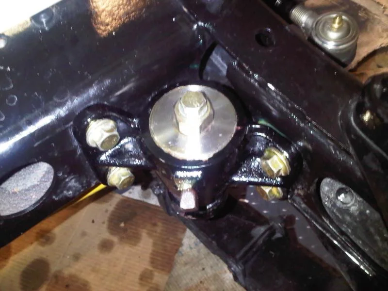

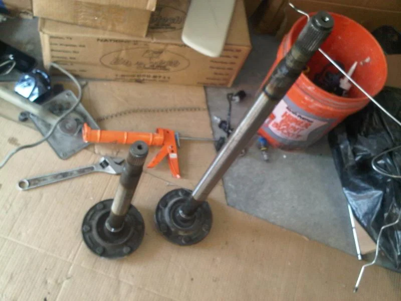

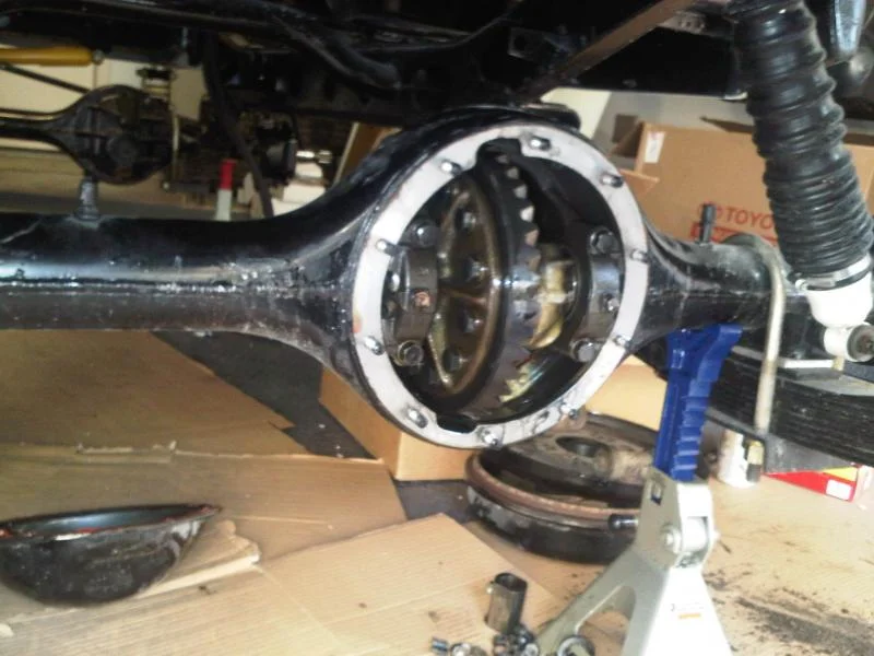

All work on rear and front bearings, rear axle, knuckle rebuild, all four wheel disc brakes and front hubs is finally done. All new SOR brake lines were installed as was the NOS OEM exhaust assembly. Just waiting on electrical and rebuilt engine and transmission reinstall. :)
