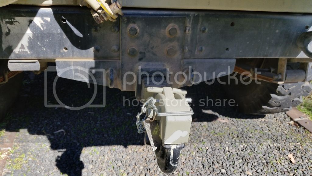

I have a Hayman-Reese (2") tow bar and it is fitted to the BJ40 by bolting onto the chassis and uses the four factory trailer hitch holes in the rear bumper. See pic below.
I want to retain the Hayman Reese towbar for use with normal tow ball hitches, but I want to be able to mount a pintle hitch to the factory mount. Besides, the Hayman Reese bar has loops for the trailer chains so I don't need to find looped bolts long enough.

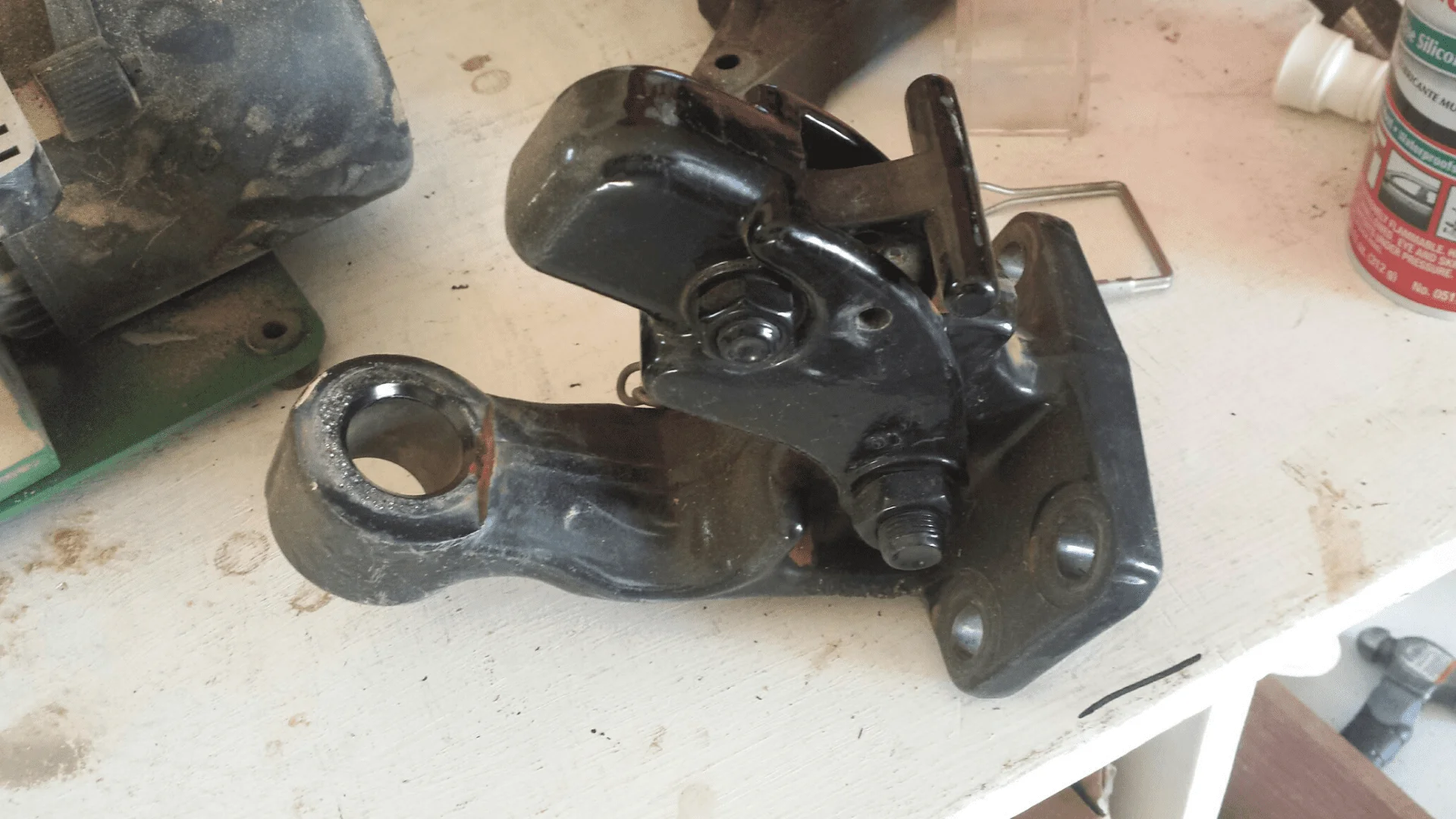

Why not just continue to use the pintle hitch in the photo? It sits too low for the trailer, which has SOA suspension.
Why not use one of those plate type tongues to which a bolt-on pintle hitch can be bolted at various heights to make the pintle hitch higher? Tried that and discovered the spare wheel carrier latch doesn't open, let alone the tailgate.
My proposed solution is to use a lockable, rotating pintle hitch bolted in the FJ40/BJ40 factory location. Since it can be unlocked and rotated, it will clear both the tailgate and the spare carrier latch.

Thanks guys. I'll go ahead and bolt the pintle hook to the factory mount.

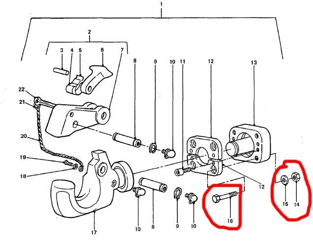

I'm using a lockable/rotating British and Australian military pintle hook (see manufacturer's page here - 4.08T Light Towing Pintle - Bradley)
It's the same pintle hook fitted to land rovers so I found the details in an army parts book -
The bolts are M12 70mm long and grade 8.8. The nuts are 12mm locking nuts, grade 8. I picked up a box of 16 of bolts, nuts and washers which are same specs but are 75mm long to hopefully help clear the Hayman Reese towbar plate.
Here's an exploded diagram of the pintle hook.

8.8 bolts are roughly SAE Grade 5, not strong enough. You want 10.9's at least.

The pintle hook in the pic above is old-spec and has a locking latch jutting out of the bottom. If the military pintle I'm receiving has one of these then the tow ball slider won't fit and I'll need to remove the pintle hook before towing a normal ball hitch-equipped trailer.
If it's the new-spec rotating pintle hook like the one in the parts diagram above, then it won't have the lock and the ball hitch slider will fit fine by simply rotating the pintle on its side.
