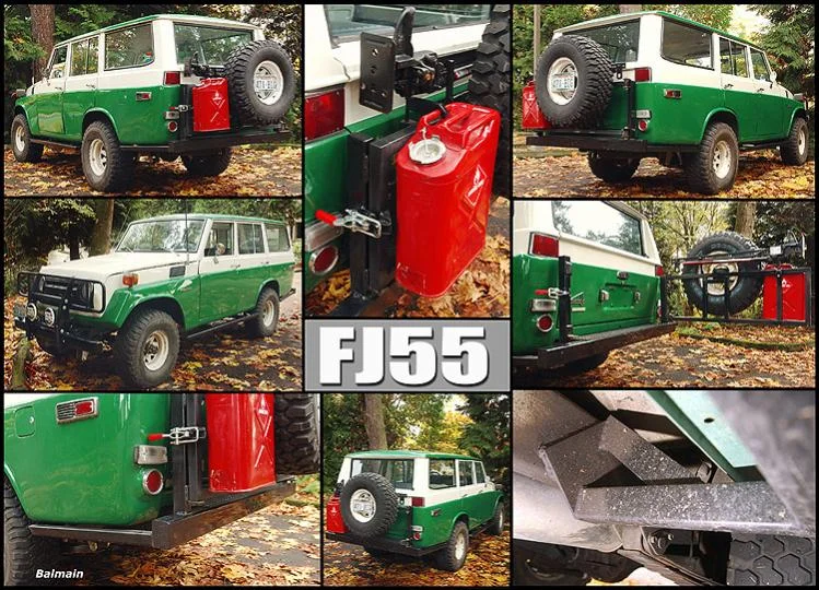

Nice rig! Hey, do you have any more pics of your swing out rear bumper? I'm trying to design one and I'm looking hard at what everyone has done. Yours seems to be a bit different than the run of the mill pre fabbed units. Keep up the work!:)

LambCrusher, I will take some more pics. It was there when I bought the truck and is stout to say the least. The PO did a nice job on it. All custom built and has a jerry can rack and HiLift mounts too.

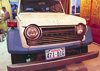

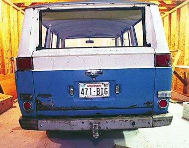

I have never seen the 'before's'. You did a LOT of work!

Thank you, Max.:cheers:That is one heck of a rack! Hope you don't mind me copying your tire carrier! History is always cool. Keep it coming
