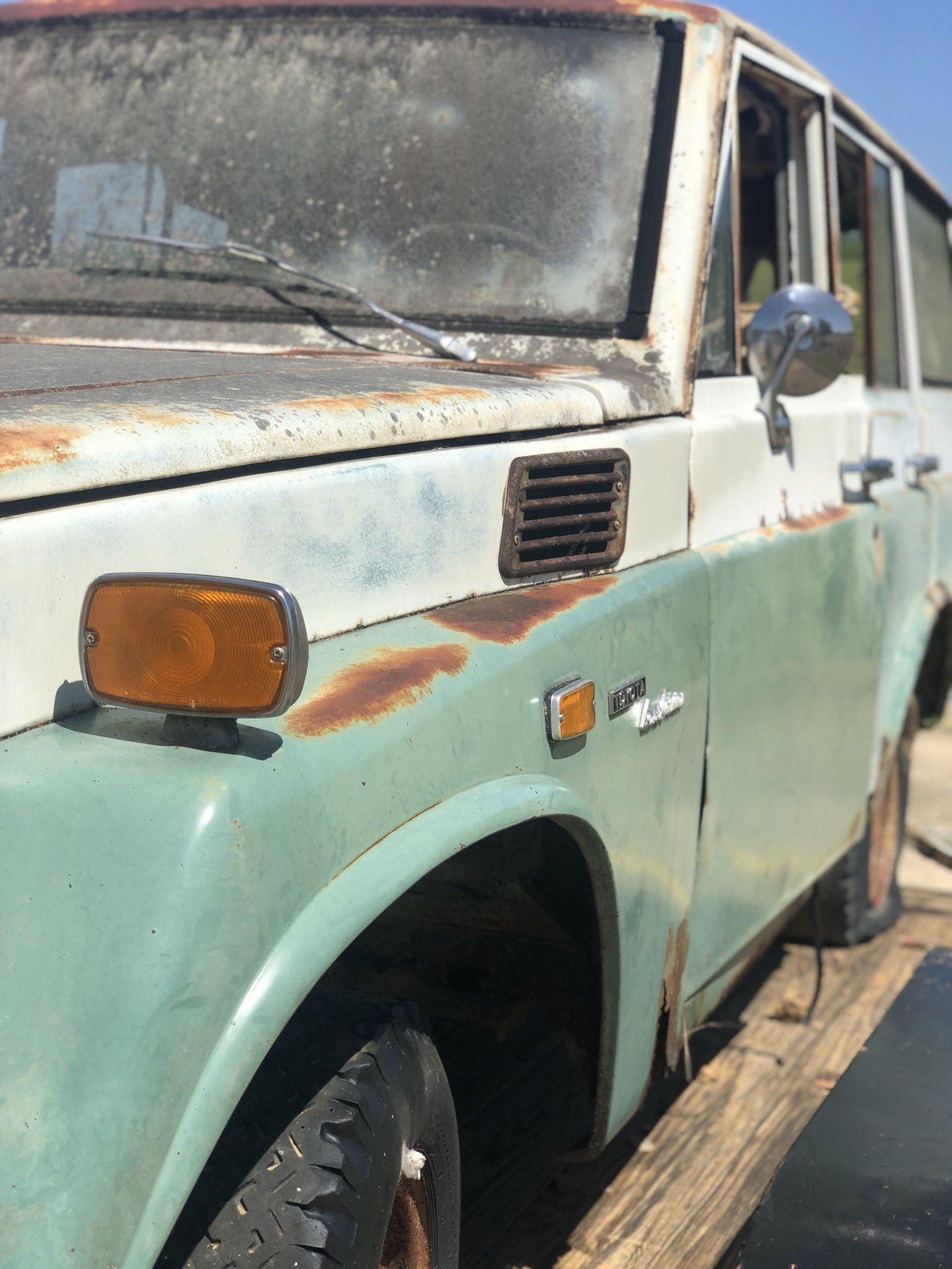

Saw some cool ass swine today. The 1968 is truly unreal. Look at the steering wheel and fender Blinkers

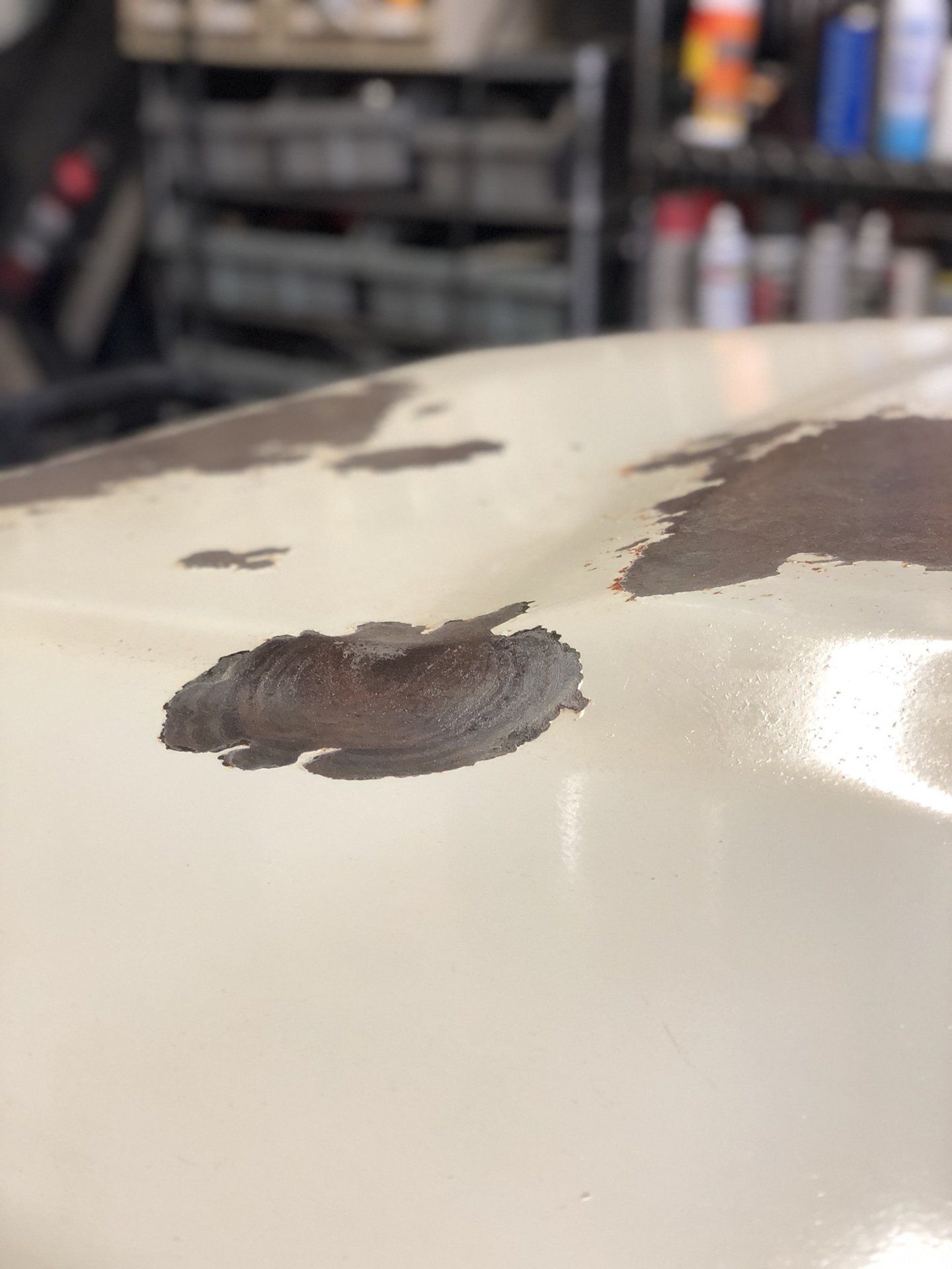

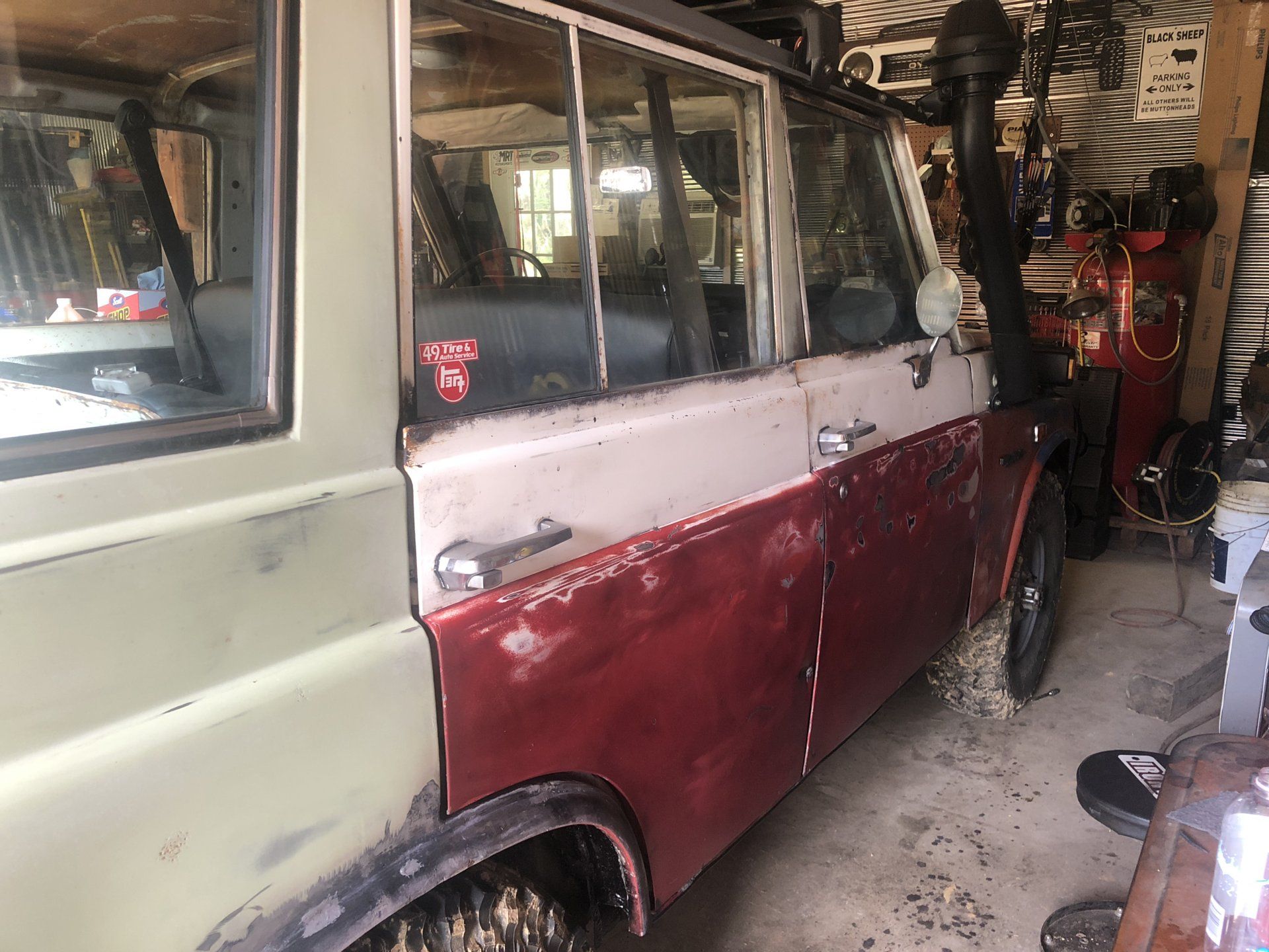

Finished laying down the white paint.
@wngrog back up a liiiiitle more and take another pic :hillbilly:
I dig the pig and admit I'd have repainted the whole thing but have come around to like Patina.
Where are you stopping with this one?

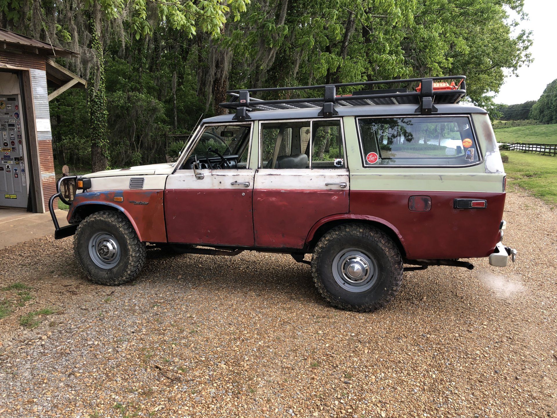

Paint is finished for now.
Sliders.
Getting front door springs rebuilt.
KM2s from the 60.
Install new shackles and bushings.
I think that’s the list.
