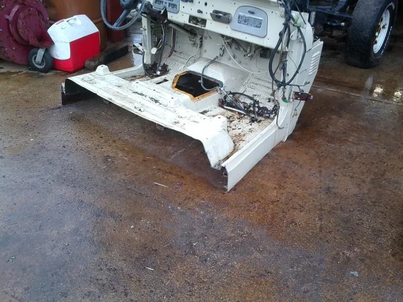

Picked up the 45 today

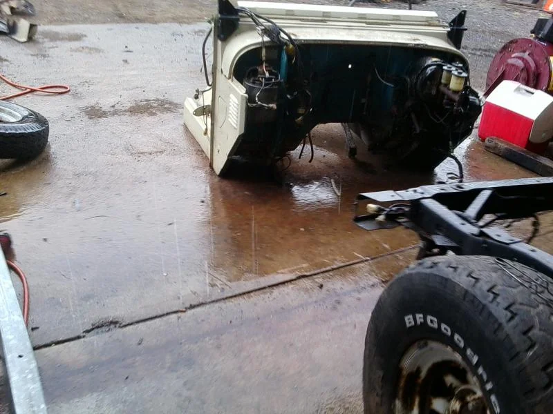

Today I put some time in on the 45, I released the 65 rear cab from it's bondage on the 79 floor and cowl and got it off the 40 frame.
It will take a bunch of work to get the lower section back to being happy it is a bondoed mess, I was trying to cut out all the all the welded in metal with the sawall but I could not get thru some of the thicker steel that was welded in, So out came the smoke wrench (I love the smell of burning bondo)I cut out a bunch of chunks of steel. So I have to take the sheet metal off the back and get new corners rolled.

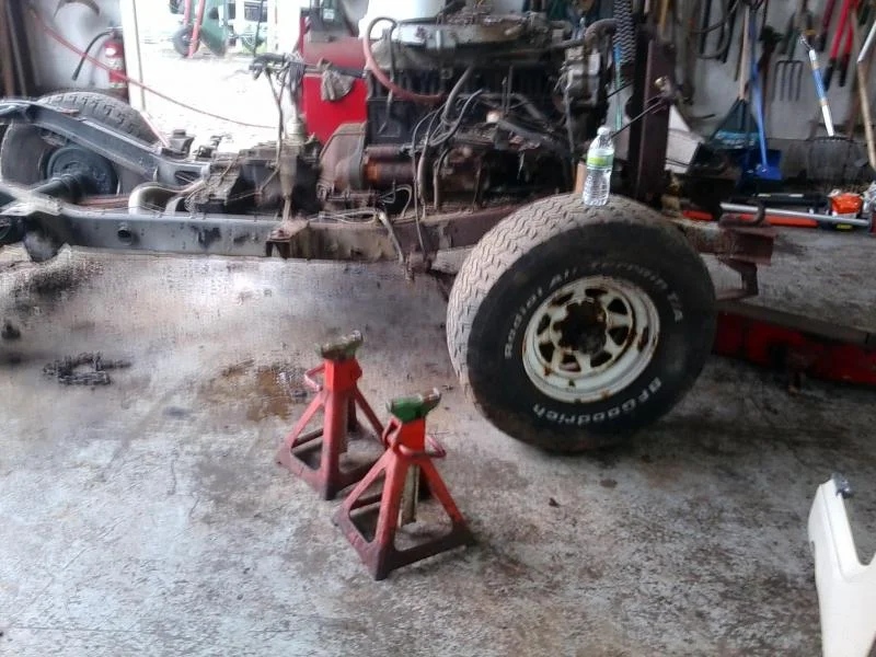

Well I spent 4 hours today on the dissasembly of the frankencruiser pulled the engine (seized tight) put the trans tranfercase away for a later date. I steamed cleaned the frame, axles,knuckles got into all the frame seams blew all the crap out of the inner frame rails. cut off all the ubolts pulled the axles,springs and stashed the axles for later.
The 79-40 frame is pretty clean compared to the 78 frame I was thinking of using for the rear section. If I can't find a frame I may use this one for the rear section. Nothing set in stone yet but if I find a decent 45 frame I will go for that and save a bunch of work.

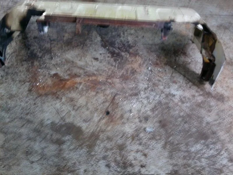

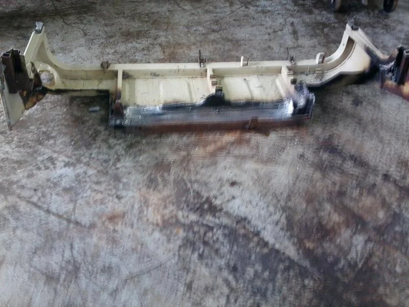

This morning I had a little time 2.5 hours to work on the 45, So I thought I would try the new plasma cutter to cut all the welded on metal that the po put on, if you are shy or squeamish you may not want to look at these pics.
Did I say I cant take good pics! I'll try to do better

You said it, first time using the plasma cutter, I had to get used to it plus there were areas with 1/2 thick,1/4 thick steel and then to straight sheet metal,bondo,seam sealer so I had a good time.

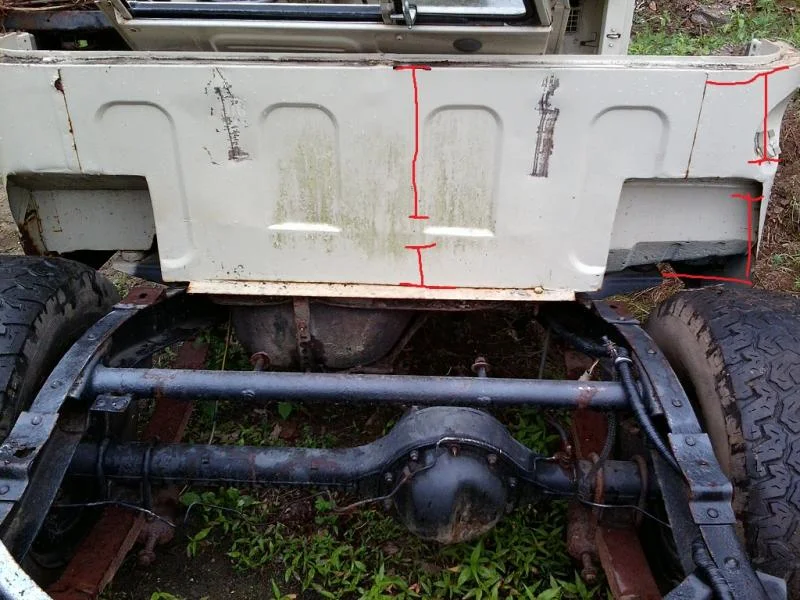

Ok I need a little help here, I need to know the height of the rear cab back and the total height of the corners, since there is a step between the back and the corner.
Hey I'll measure mine out for you in a little bit and send you the measurements when I get back
Hey I'll check again tomorrow but I believe the sides were 25 1/4 and the back was 21
Trying to figure the rear cab panel I can't buy one with the 4 embossed areas in it. I am thinking a bead roller to make the design in the back panel. Not a bead but a step not as deep as the original but it should work.
Also the box behind the seats that attaches to the rar of the cab and to the 3 braces,how far does that come out?

mine is a removable top long bed pickup 1965.
-height of back wall, top to floor as you show in your picture is 21"
-height of corner is 25" (I've cut mine, but saved the cut off part, so I measured and included the cut off as well. I'm pretty confident that 25" is within 1/4" of being correct.)
I removed that support section at the lower inside back of cab so I cannot provide that, but I recall from memory that it is close to 5" front to back. Mine was exactly 4 3/4" tall (saved this piece so l have this piece to measure) but that includes a 3/4" vertical lip that attaches to the top piece of that rear cab lower support box or 'shelf' as some call it.
