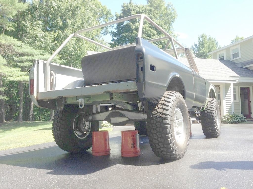

BTW -> I'm a fan of ORI struts as well, and I'm using them on my "other" 4x4 build. :)

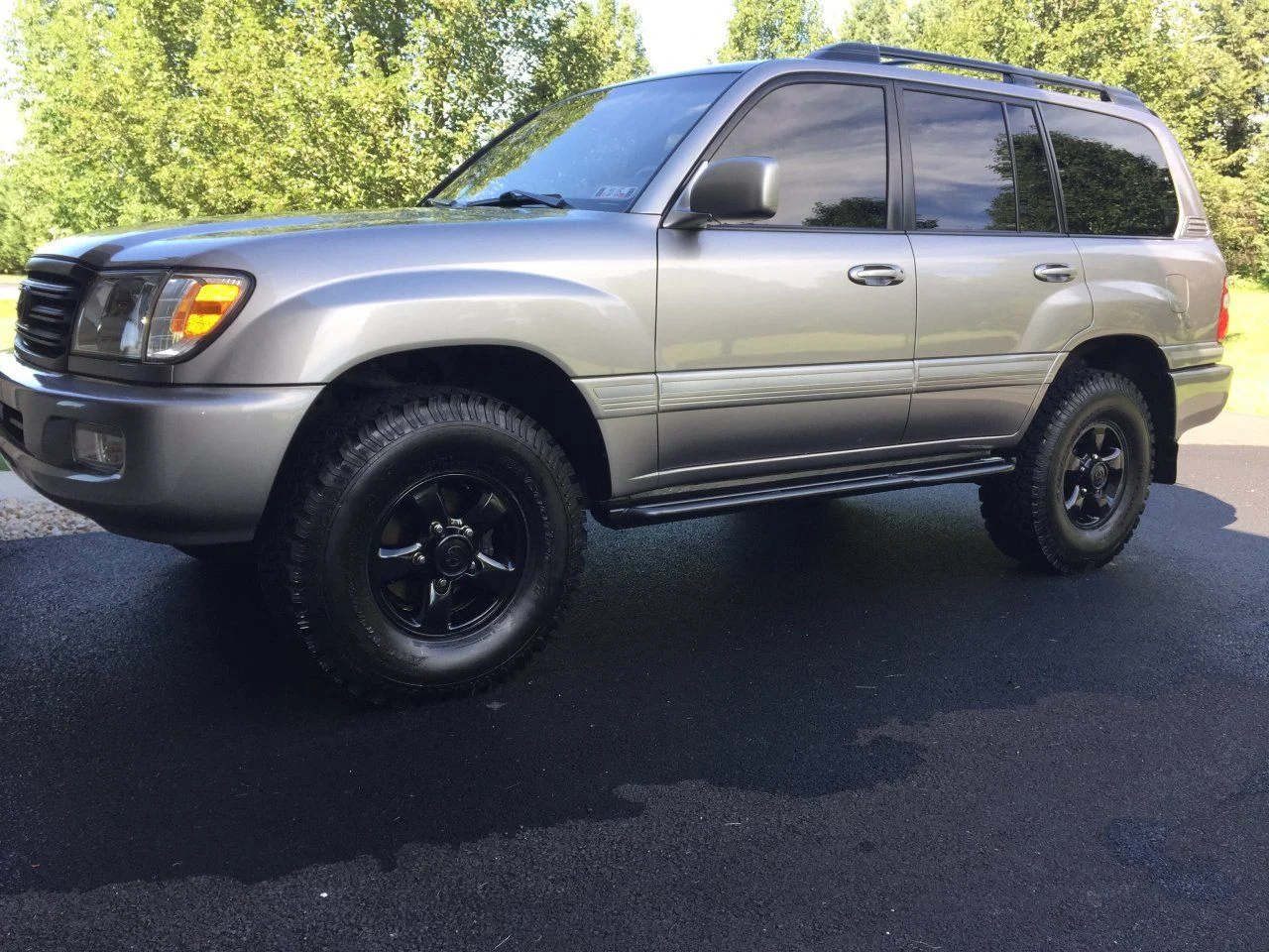

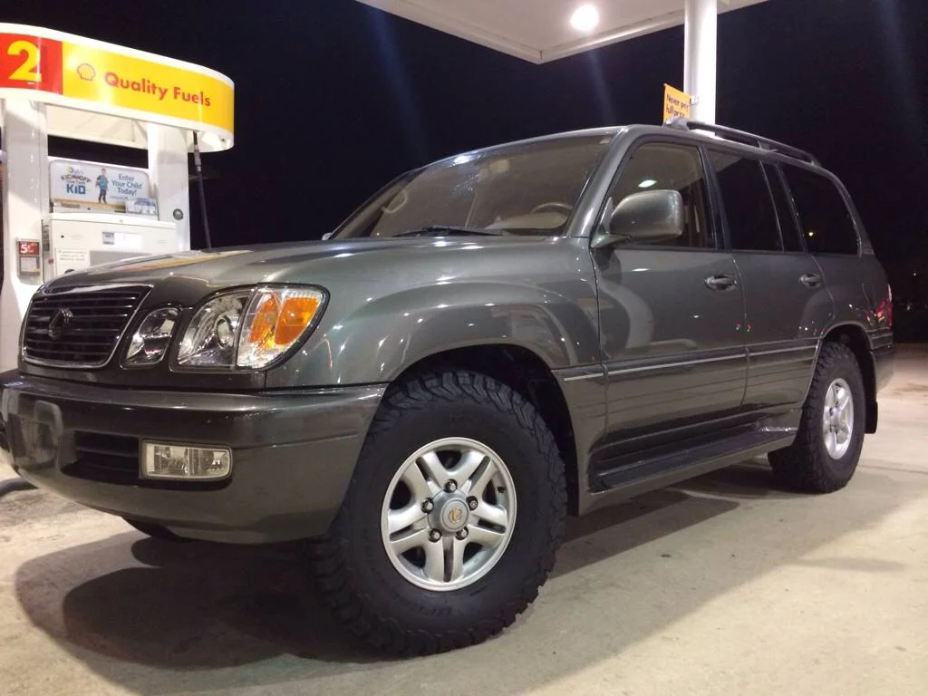

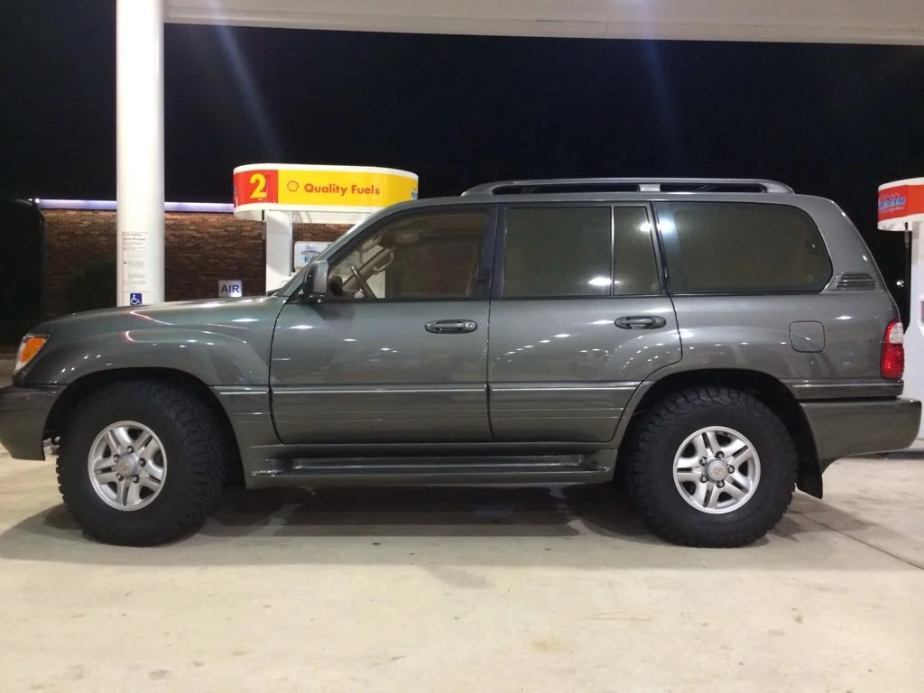

285/75/16 K02s. I don't suspect you'll run into any issues with 295 and SpiderTrax Spacers.

Thanks Duggy,
I saw those pics when I was doing my research, but wasn't sure about AHC and if those photos were taken at the same height as a regular LC "stock" height?
The people with 285s seem to outnumber the 295 crowd by maybe 10:1... I suspect the 295 hasn't been available as long which might be part of the reason.
-G

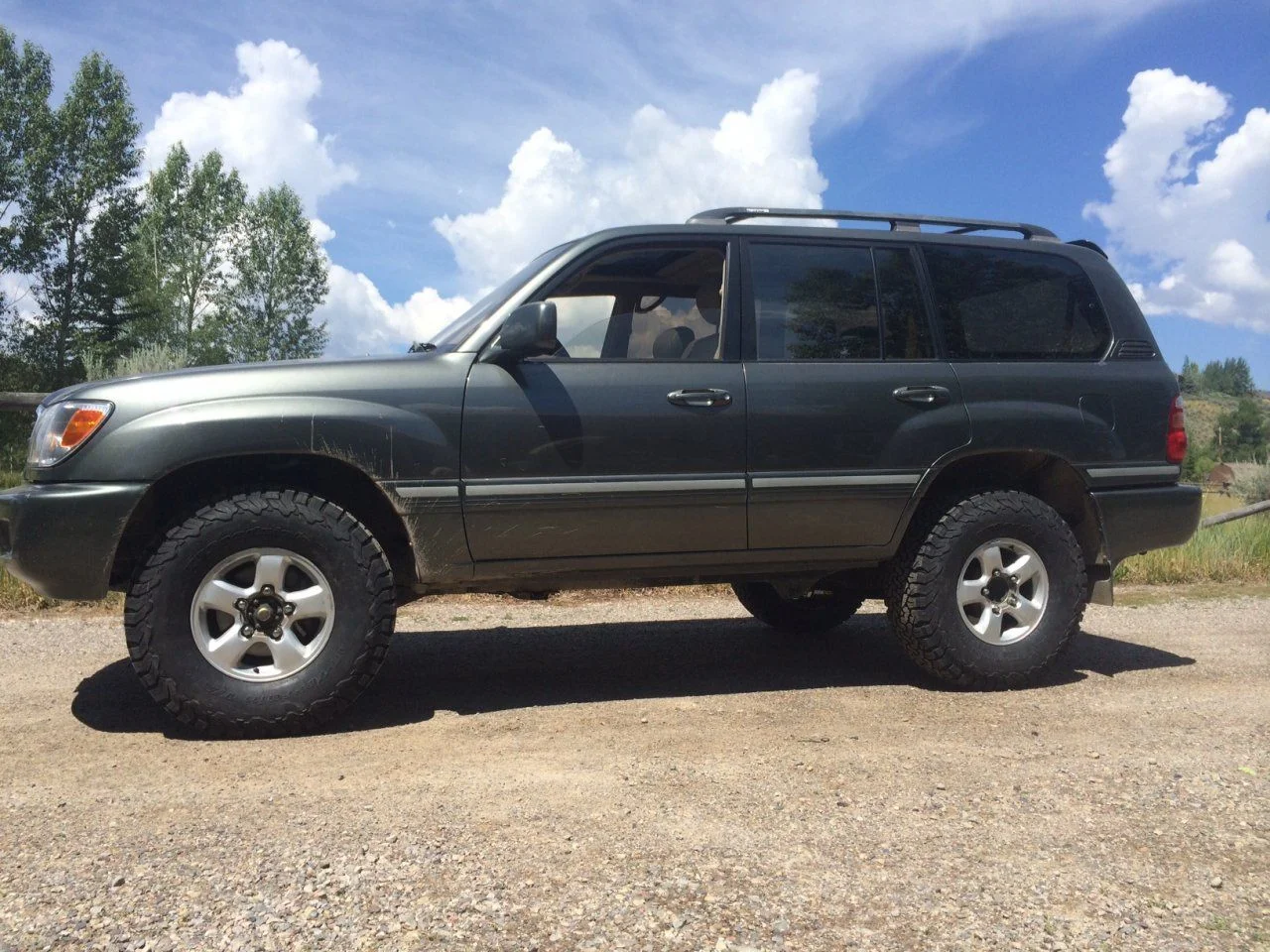

295/75-16 BFG KO's here
Very cool. Thanks!
To clarify, are those the "KO" or "KO2" tires? (pretty sure the "KO" is discontinued, but want to clarify)
Also, your /sig mentions that you are running a 2.5" lift. Is this photo with the lift, or without?
-G

Correct, KO's.
Yes, 2.5 inch lift was installed in this pic. Metal Tech sliders and slee front skid plate, so only approx 200lbs of added weight.

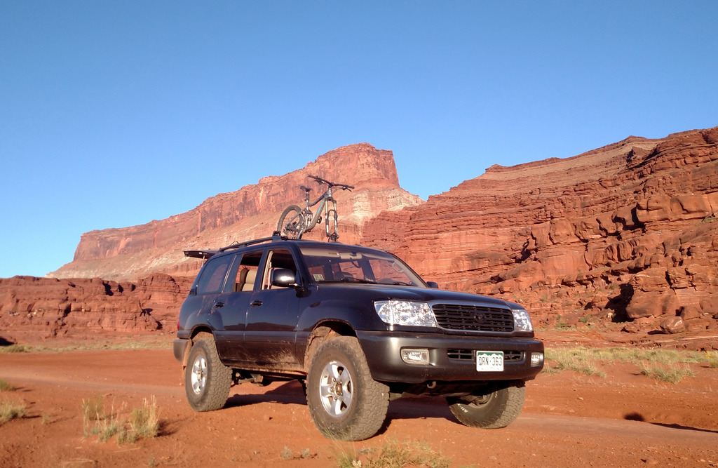

My girl has 295s and a 2.5" lift. Not the greatest shots, but you get the idea. I put on some 1" BORA spacers because they were nearly rubbing on the UCAs.
Nice! Are these photos with the spacers installed or without? The wheels look "flush" so I'm guessing it's "WITH"...
I thought Spidertrax was the only game in town for spacers..... never really like the idea of a bright blue anodized spacer peeking through from behind my wheels, so I guess I will check out BORA as well. Thanks for the lead. :)
-G
Both of those photos are with the spacers installed. You can see in the image below that the side lugs do somewhat stick out, but not terrible. IMO it fills in the fenderwell nicely and gives it a beefier stance. The wheels tuck up with no rubbing on full flex.
Do be aware though, those spacers are made to order by a dude named Lenny in Reno. Hes easy to talk to and is usually pretty good about responding, however I had to wait 1.5 months to receive my spacers since he was so backed up. Because of this, he has some bad reviews on Google+, however I had no issues at all. Quality product IMO.
