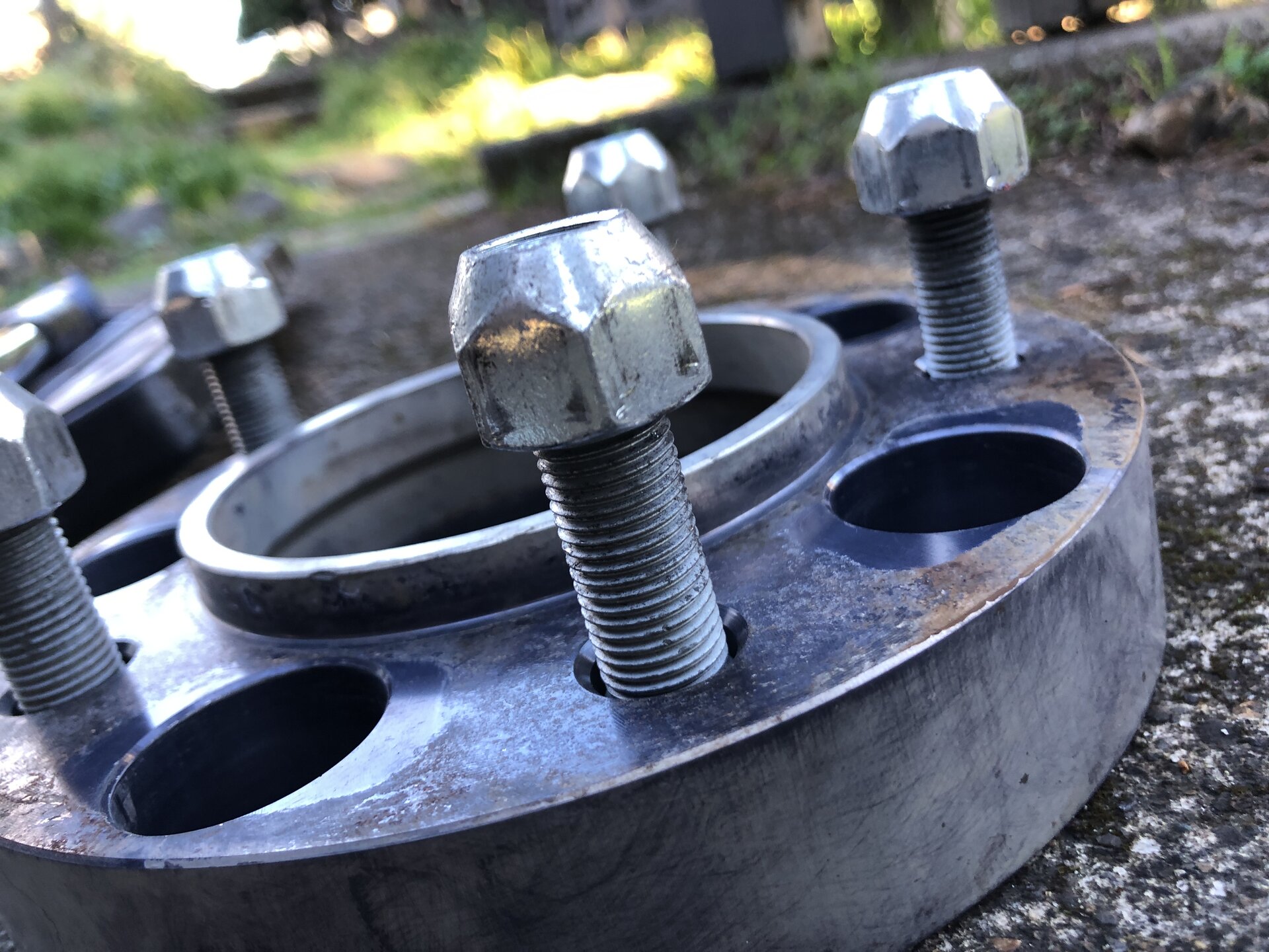

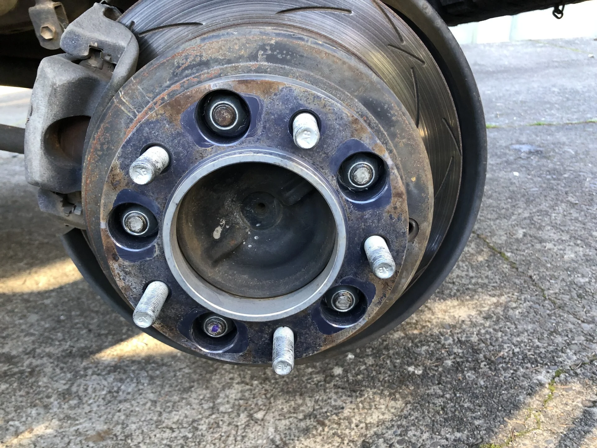

Yeah me too. I looked at my spacer install and realized I mounted all the spacer-to-lug nuts upside down. Removing the spacers cut my vibe by 90%. Which tells me I was on the path to spacer failure (evidenced by the aluminum scoring in the spacers under where I put the flat side of the bolt down instead of the coned side). Among my dumber achievements. Photo shows the bolts temporarily stored on the lugs but illustrates the cone that was supposed to go down into the holes, not flat down). Just. Dumb.
