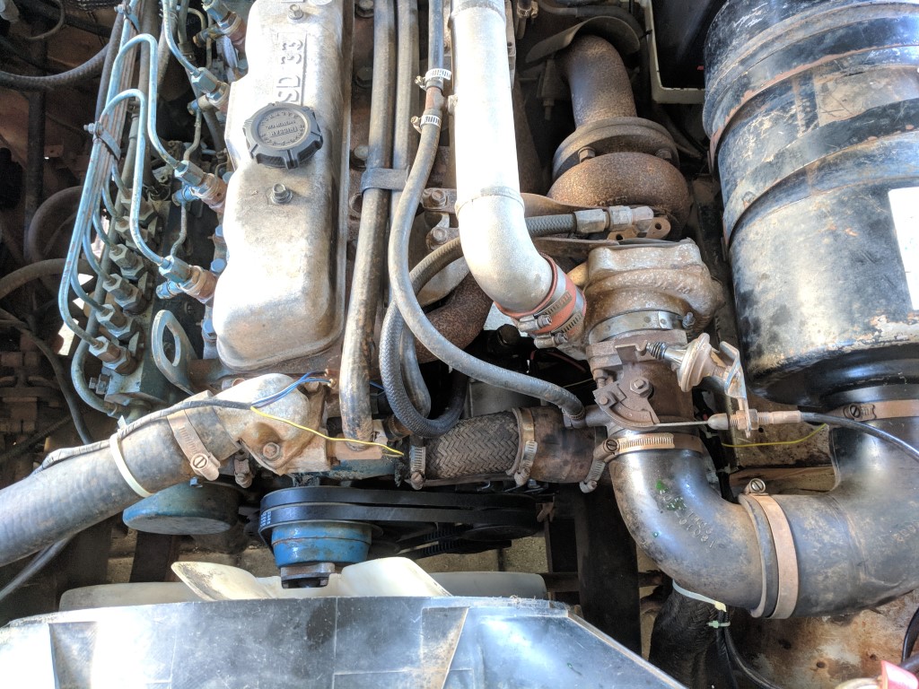

Aftermarket turbo to give the old sd33 a bit of help on the hwy. Had just installed a new alternator (GQ diesel version is pretty well a direct fit into the MQ and has the needed vacuum pump on back, for the power assisted brakes). Straps on the donaldson air filter assembly aren't yet cinched down.
