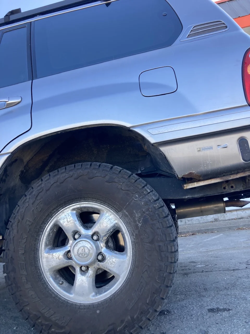

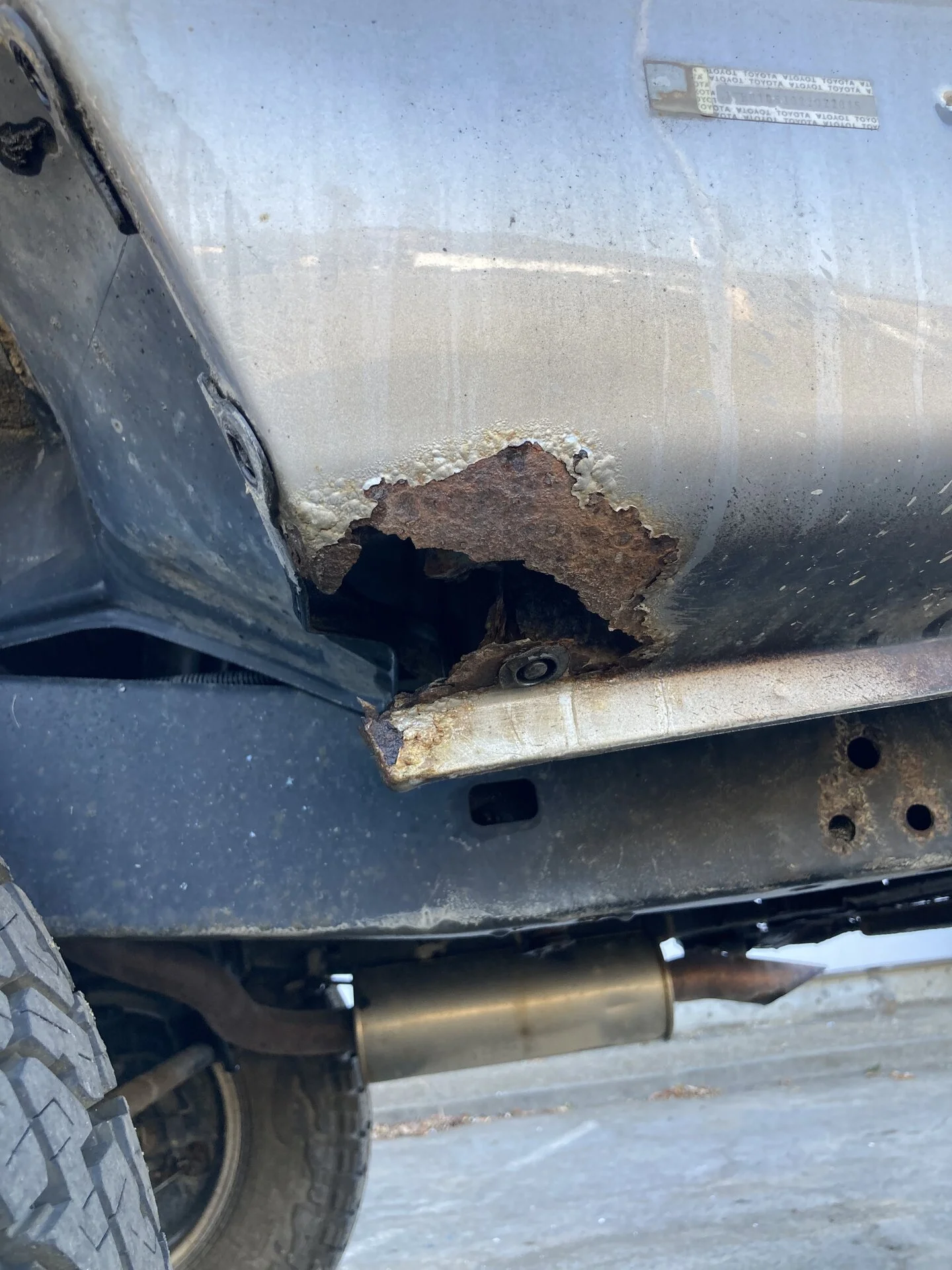

Hi all, looking for any suggestions on how to patch a fist size hole on the drivers side rear quarter panel. From searching the forum it looks like a common place for rust.
The mud flaps hide the hole so I’m okay with a simple functional solution. I also don’t have or know how to weld so looking for any suggestions that I could do with simple tools.
My thought was to cut off the existing rust around the hole, find/cut sheet metal (or any other durable material) to similar size and then seal the sucker shut. Bad idea?? Let me know!

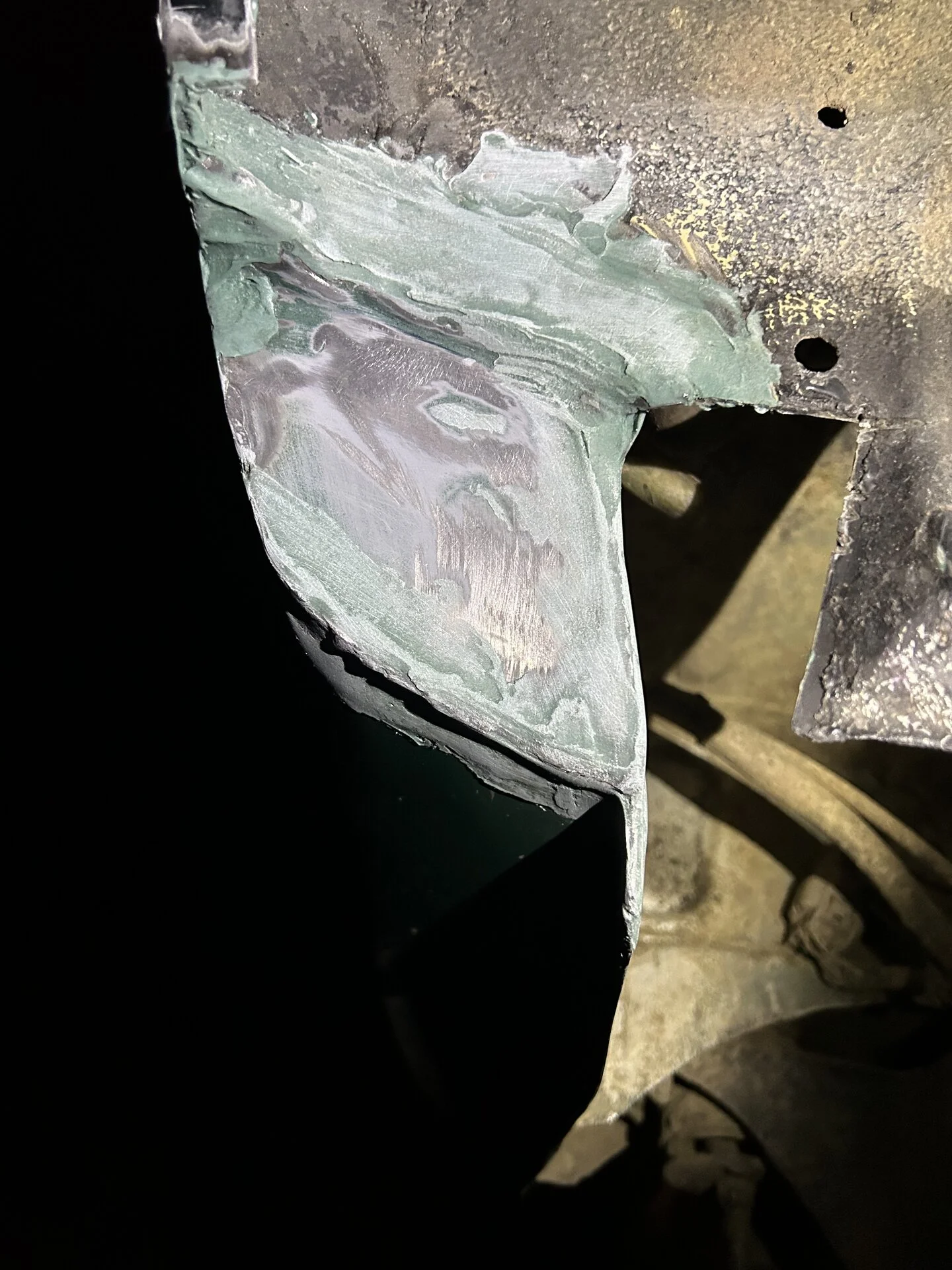

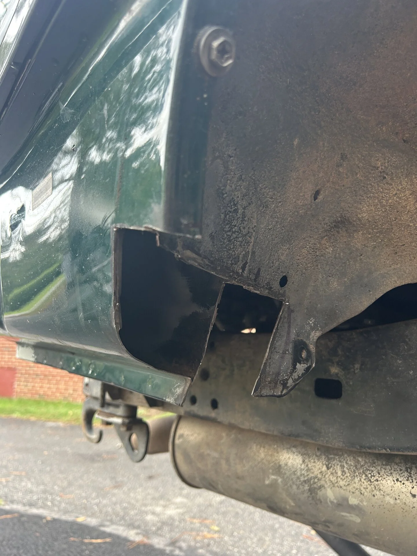

@Fairgame is right on. I don't have any previous experience and I welded my metal sheet metal cutout in before using a fiberglass body filler from evercoat (advanced auto) to fill in all the small holes. It worked great and I just need a second coat of pant to finish
. My hole was smaller but here are some pics. Definitely use rust converter and cut out wider than the rust area to make sure you get it all.
@Fairgame is right on. I don't have any previous experience and I welded my metal sheet metal cutout in before using a fiberglass body filler from evercoat (advanced auto) to fill in all the small holes. It worked great and I just need a second coat of pant to finishView attachment 3451473. My hole was smaller but here are some pics. Definitely use rust converter and cut out wider than the rust area to make sure you get it all.
Just prime all bare metal before fiberglass
True! Forgot to do this. Hope it'll hold alright. It's in a good spot to keep working on easily. It was good practice if anything later in its life gets bad.
