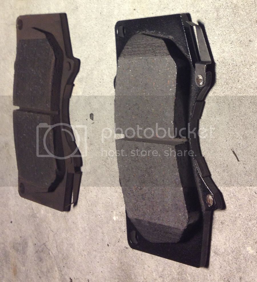

I'm not using OEM pads, I'm using Akebono pads and they came with shims pre-applied so they can't come loose. I checked the little tab against the drivers side and it didn't look bent.
OEM up top / New Akebono on the bottom
http://i140.photobucket.com/albums/r34/rrcompton/Lexus GX470/AkebonoACT976padsVSOEMpads.jpg~original

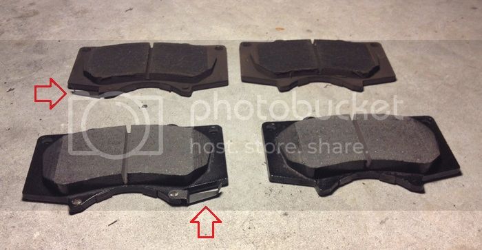

Here's a pic of the wear indicator. It's on the passenger side / engine side of the caliper:
I copied the same placement as the OEM pad but just to rule everything out should the indicator be at the top or bottom when in the caliper?
I doubt that's the problem because I'm not getting the same noise on the drivers side.
EDIT:
Most threads I've read the indicator is always on the engine side / top so it's fine.

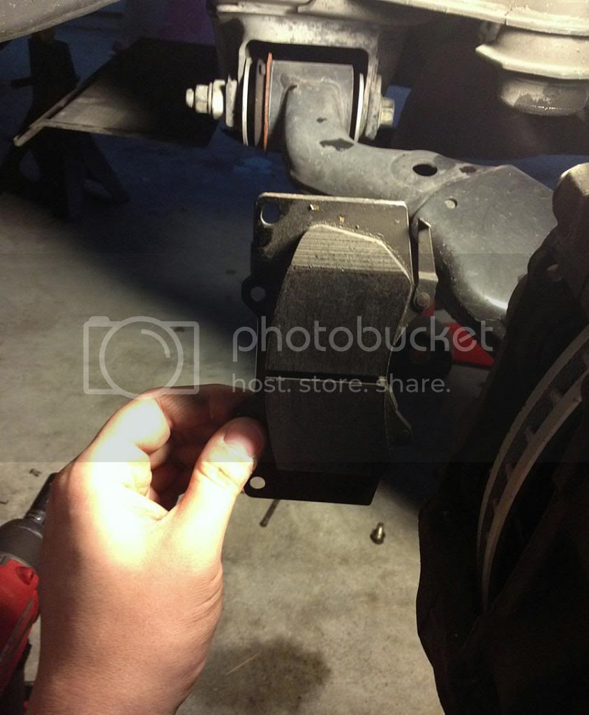

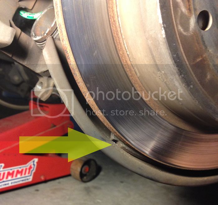

There was actually 3 causes for the grinding. The inside upper pad locator and brake pad fell out and separated from the backing plate. The backing plate was wedged in between the rotor and brake dust shield.
The pad was at the bottom of dust shield / behind the rotor.
Because there was no inside pad the caliper piston was pressing against the backside of the rotor...metal to metal grinding. :hillbilly:
