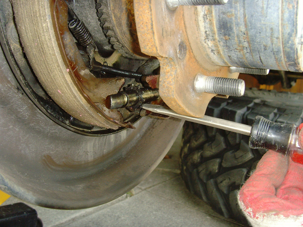

e-brkae is a seperate system to the regular "foot" brake. Easy fix might be adjusting them - wheel off, rotate hub so hole is downwards, insert screwdriver and rotate the adjusting star washer upwards - proper procedure documented on here, you don't want my version ;)

Adjusting the hand brake on a disk brake rear will do nothing for the pedal. The handbrake is strictly a mechanical set of shoes in the drum of the rear rotor. It is not effected by the wear on the rear pads and unlike the rear drum brake Cruisers, does NOT have an auto adjuster to keep it set properly. You must periodically manually adjust it as described in your FSM.

you have to adjust the toothed cog. There is a hole in the brake rotor that you align at the bottom and stick a screwdriver thru to flick the cog up (tighter) or down (loosen) the parking brake pads. The design is sucky and requires frequent attention.
I usually adjust all the way tight and then back off each side the same amount of downward strokes so both sides grab equally.
so imagine the brake rotor covering the photo below but this is what you are doing-
