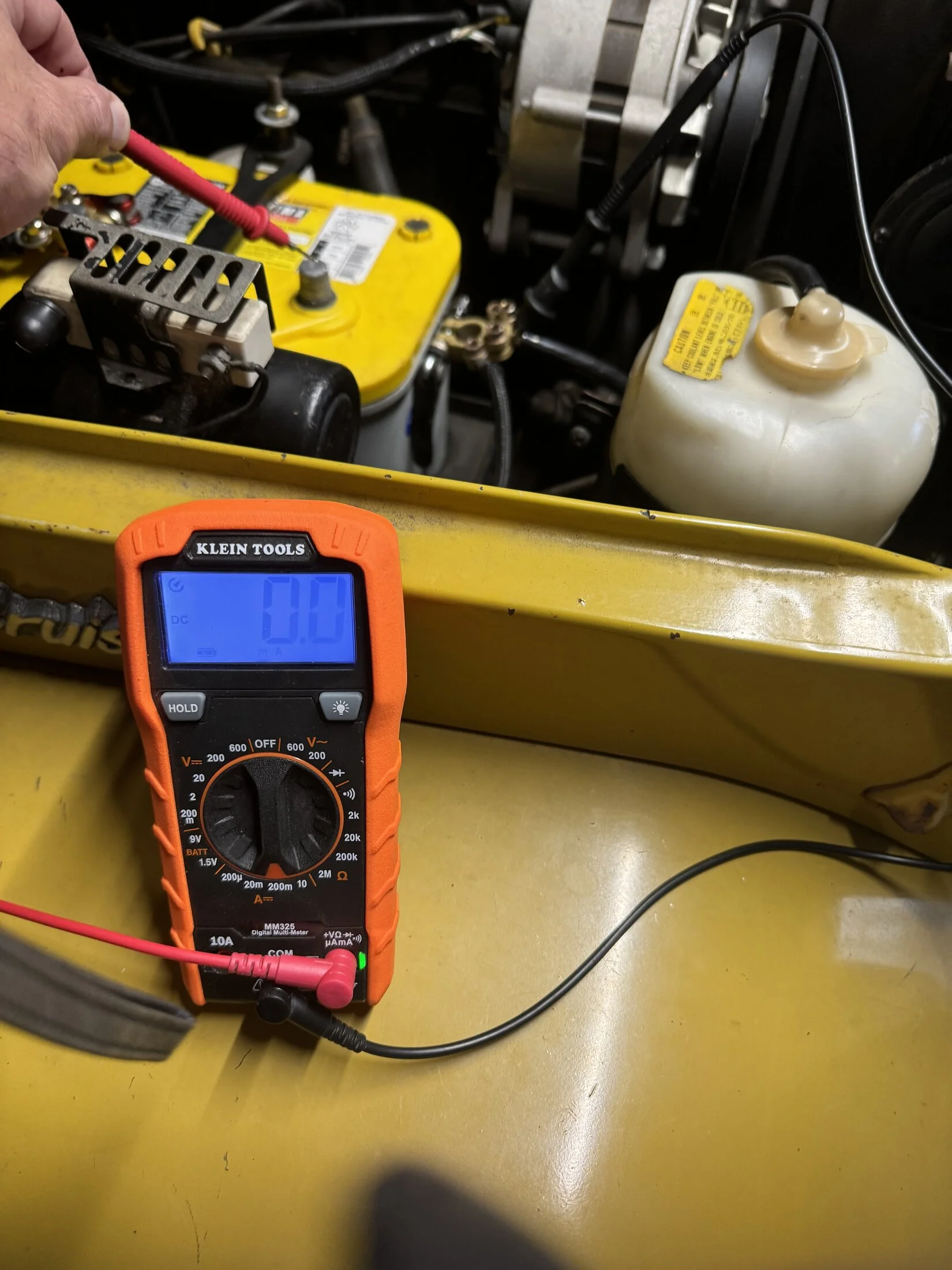

Ya the fuse is good - let me take a pic of exactly what I’m doing

Ok here is the set up of what I’m doing. Again I’m just trying to ID where the parasitic drain is. If any (but there has to be bec if I leave it in the garage for one full day & night, it’s drained).

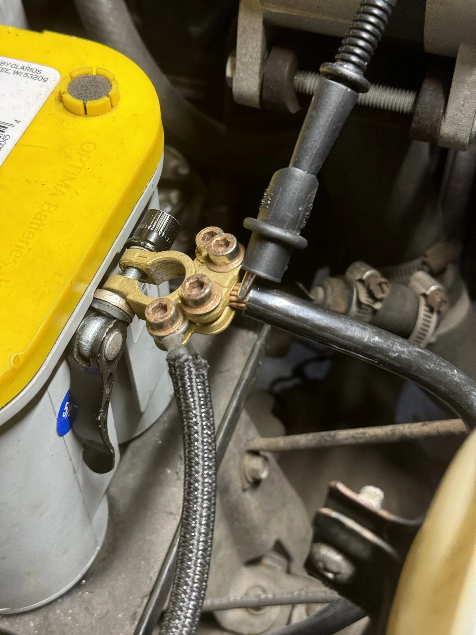

Oh s*** - when I switch it to mAMPs and touch to neg post - a fricken noise happens down by my starter I think? I dunno but I didn’t wanna do it again for fear of messing something up.

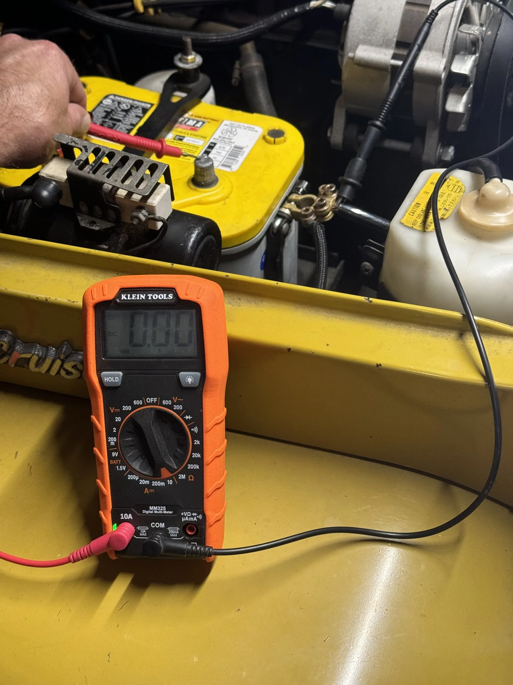

Here’s the set up when I did that..
Does it start properly ? Have you looked at the back of starter to see if wires are loose/whatever ? Next up would be the ign switch as IIRC all main power goes thru it so if something is still hot it may not be disconnecting the circuit.
The pos lead at 10A and the dial to 10 is the correct config for testing like you are - in line testing. In this pic you have it set for testing across the individual fuses.

Here let me try that ..

I mean right when i touch the probe to the neg battery post while other probe is securely connected to disconnected battery ground cable, there’s an immediate noise down by the starter. Like I’m completing a circuit by doing that or something. Could be a relay - but it’s not a clicking it’s a churn sound if I can describe it.
