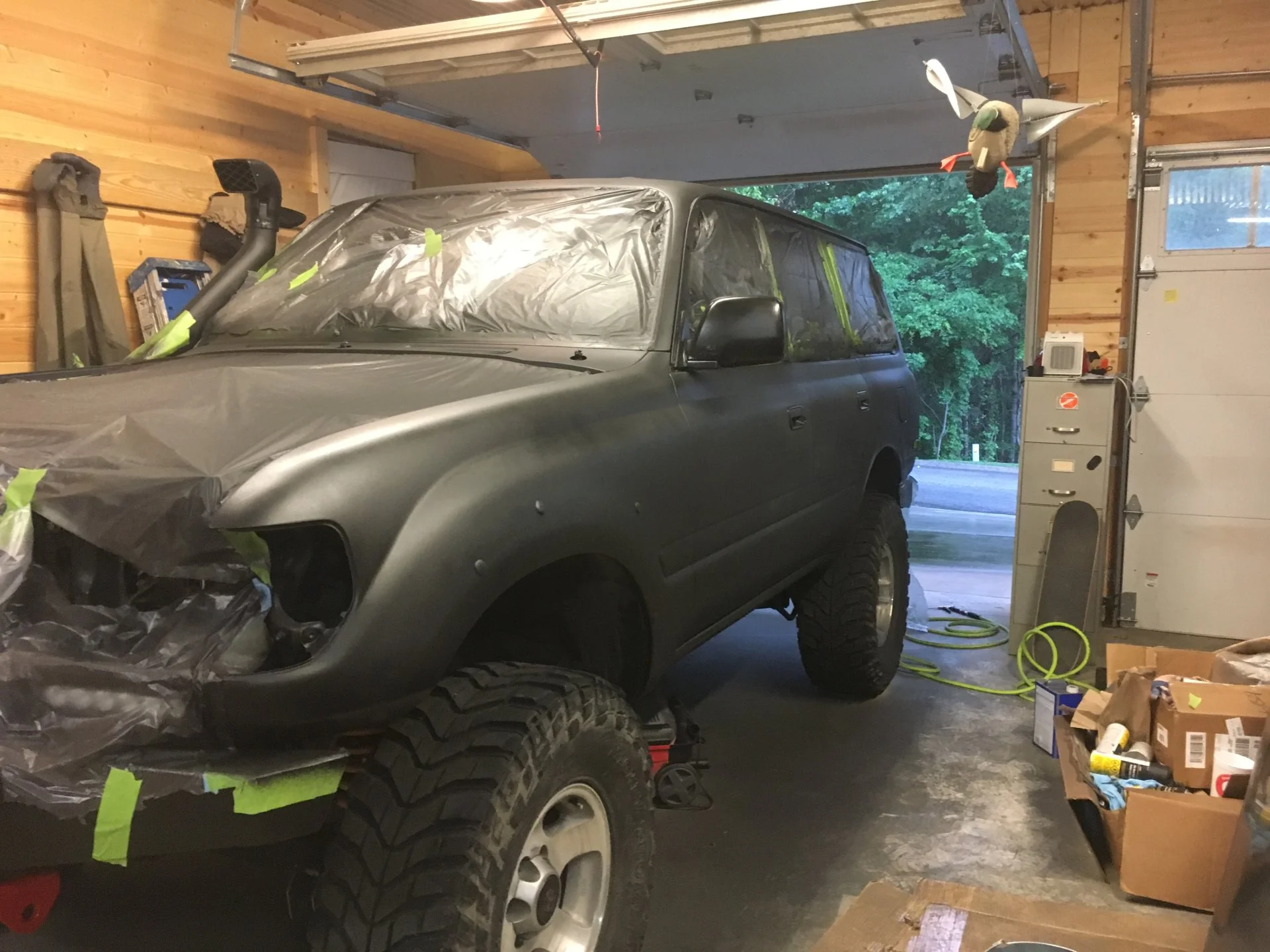

This is the best stuff I’ve ever used. John Deere Blitz Black Paint - TY25631 - https://www.greenpartstore.com/John-Deere-Blitz-Black-Paint-TY25631.html
I painted my whole truck with it and it has held up great.

@voodu3 , is the garage pic most current? Or do you have any of it assembled and outside, for a finished look? I've been tossing around ideas of JD blitz black too. Thanks!
