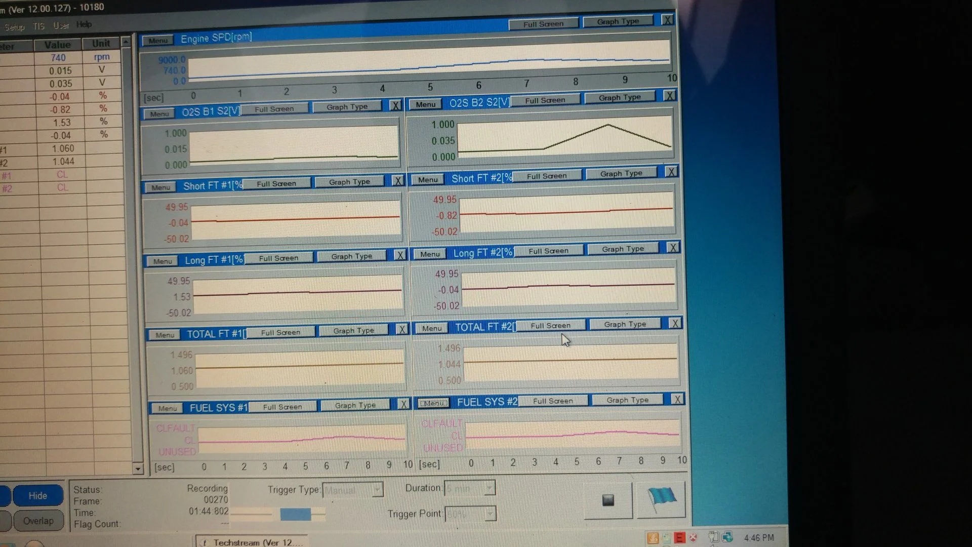

Had a P0420 pop up with a check engine light/VSC OFF/TRAC light. When I ran a Techstream live test, this is the graph on an engine rev at about 3500rpm. Can anyone tell me if this confirms the Bank 2 Sensor 2 oxygen sensor is bad? I believe the threshold is something like 0.49, and it looks like this is going above that mark.
Try playing with fuel trims in tech stream utility. Run it max rich, that max lean. You'll then see if BK 1 sensor reacts.
