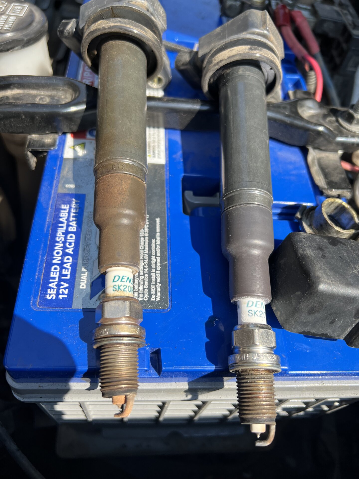

Pulled the coils and plugs on #1 and #2. Plug #1 was loose, but thankfully not falling out and no apparent damage to the threads in the head, so that's great news. Plug #1 is on the left. Pretty easy to see it was about to get much worse. That coil and plug both had reddish-brown fouling. Oddly, both plug and coil #2 looked fine. Plug #2 was tight and the coil and plug show no signs of heat damage, but I'll probably replace all the coils and plugs as PM at a bit over 150K.

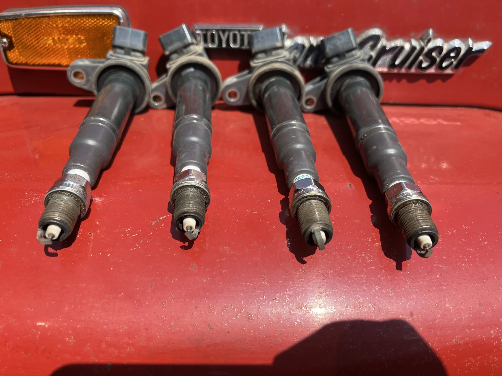

All eight plugs and coils are out. Right side (PS) all seemed ok. Plugs tight, coils look fine. L-R, cylinders 2-4-6-8. A little oxidization on the ceramic around the electrode, but they all looked about right for 60K miles and all gapped right about 1.0-1.1 mm. You can also see the anti-seize crud on the top of the plug threads. Will be skipping that on the new set and torquing to 18 lb. ft., as per the info on Spark Plugs Alert Alert Alert!

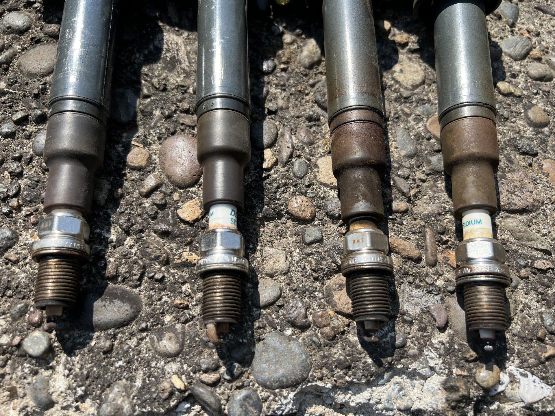

Driver's side was less good, but still not catastrophic. L-R, cylinders 7-5-3-1. Cylinder 3 also had a loose plug and the coil looks equally heat-affected as #1. Weird that the codes were for cylinders 1 and 2 and that 2 looks great and plug was tight. We'll see. The rest of the DS coils had some degree of browning of the tips, whereas the PS coils all looked grey and fresh. Ordered new plugs and coils from Amazon ($48 each!), so we'll just roll the dice they're all legit Denso parts. Camping trip planned for Labor Day weekend, so time was a bit of the essence. I'll keep coils from 4, 6, and 8 for spares.
