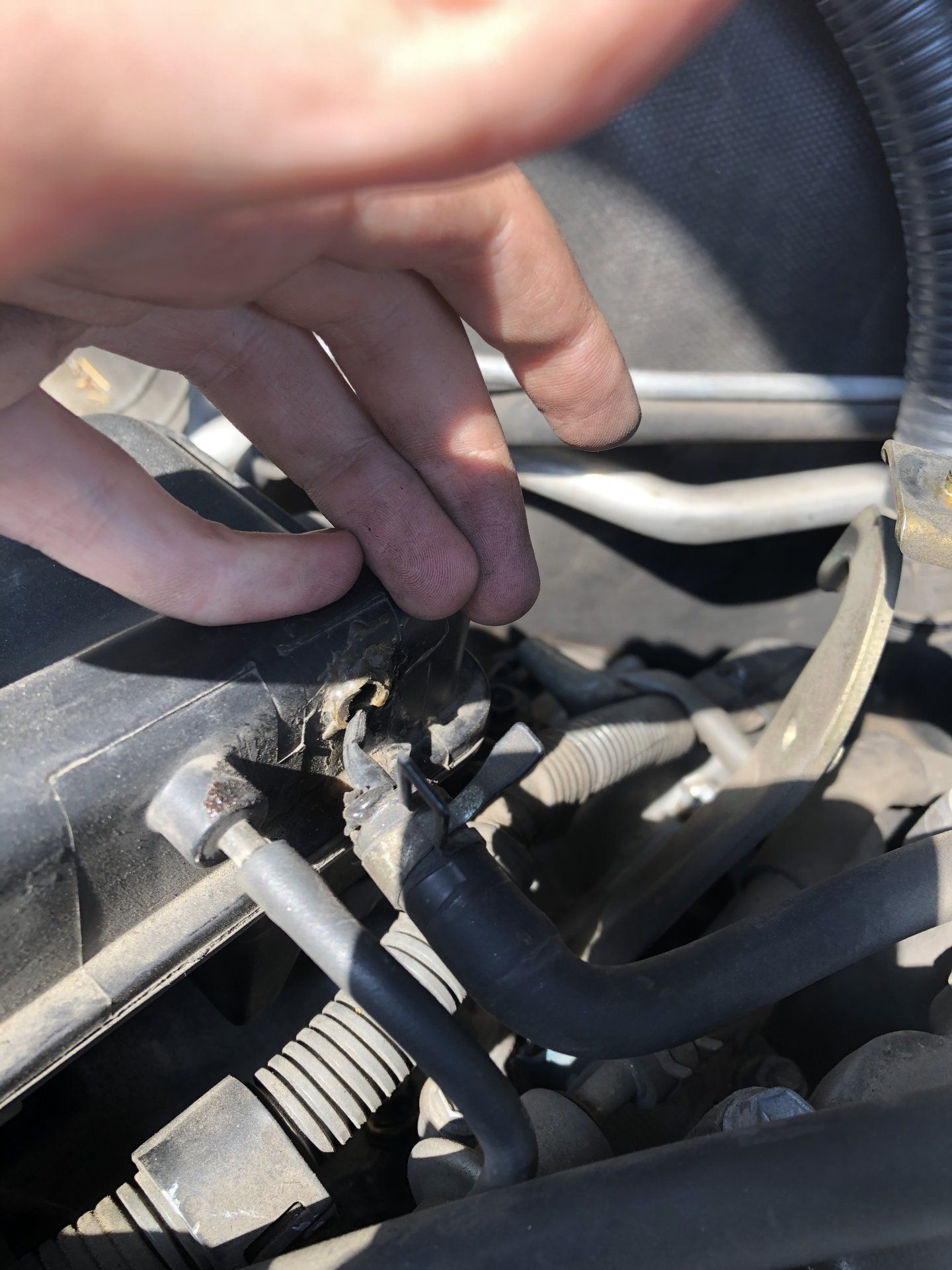

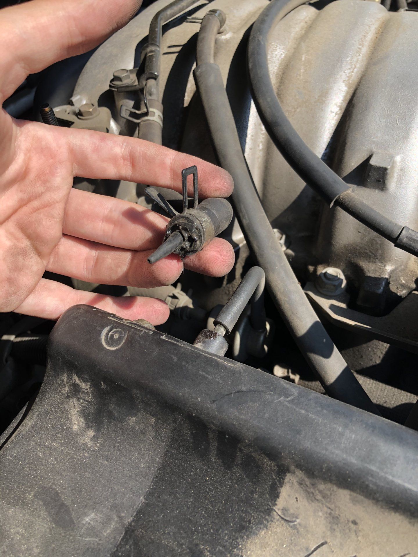

I have found the problem. Looks like my mechanic tried to glue it last time but it did not hold. I have uploaded a few photos. I am now trying to figure out how I am going to attach it because the box it connects to seems to be damaged a little bit.
I believe that box is polypropylene with ~30% glass fiber. So if you know someone with a hot air welder, you should be able to weld it with some poly rod too, if you prefer to go that route.
Sounds fancy but cool.
Haha, I am very fancy indeed. But really, you can pick up a plastic welder for pretty cheap at HF, and most plastic stuff has the type of plastic (PP GF30 in this case) somewhere in the molding. You can just Google the abbreviation for the plastic type and see if it's weldable.
I had no idea about this. So the plastic type (e.g., PP GF30) is typically stamped into the item? I'm a dumbass and never knew that's what those abbreviations were. Looks like $60 at HF can get me going; I assume I only need an air compressor and 120 hook-up to make it work? I want to try this. I break plastic stuff more than I care to admit, which usually gets redneck JB Weld treatment that is more often than not ephemeral.
It's really minimal air flow that's needed, and the $70 dollar one has a fan built in and just needs an outlet. Yeah, most plastic molded stuff has it in the casting. Definitely worth looking into. Things that are impregnated with chemicals tend to not weld well. Check out AVE on Youtube for some insight into various plastics used in tools etc, and how to identify them if they're not marked. (smell, melting point with soldering iron, etc)
