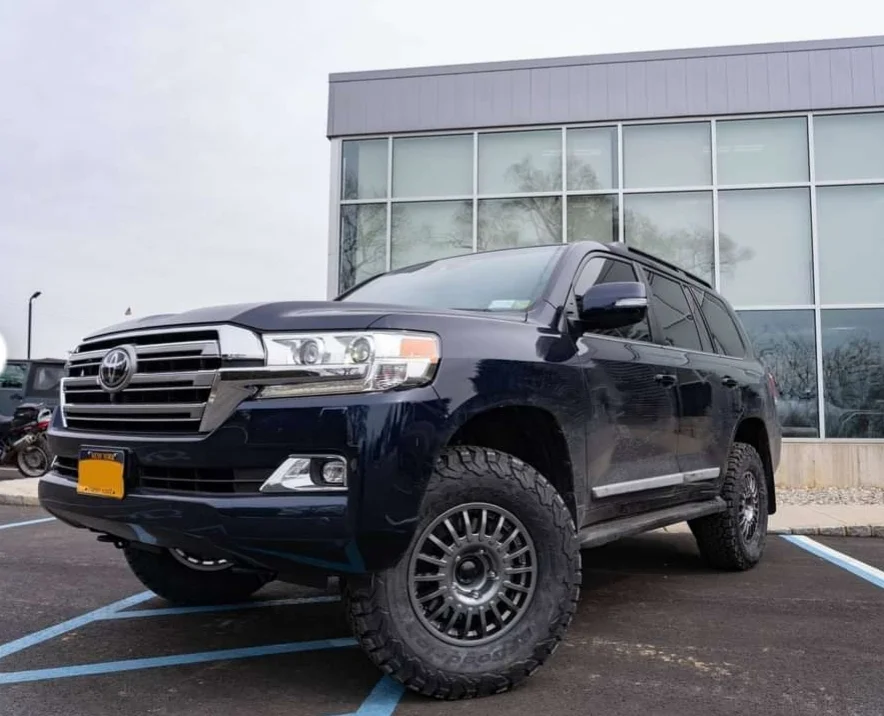

The Rally Raid is very similar, if not the same wheel as above. It just doesn't come in white in the 5x150 bolt pattern (only comes in bronze or black). I suspect if you were really desperate you could always have a set refinished in whatever color you wanted.

Rally Raids painted white would be hard to distinguish from the Rally Racing. Just a little more spoke and a little less dish in the middle.

When it should be that style you probably need to head to the Rallye Raid ones
They have them listed in 5x150 and explicitly naimed them with the 200 series.
