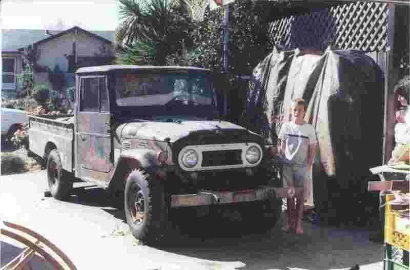

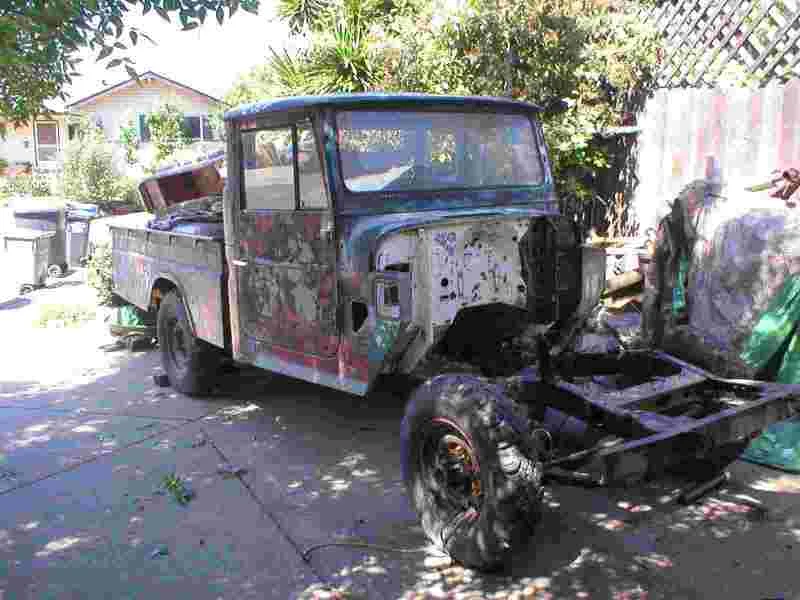

I'm joining the party. This is my 45lv, left to me after my cousin passed almost 20 years ago. It's been sitting in a garage for the past 18 yrs. I sent it to TLC 4x4 to get some needed upgrades. I'll be picking it up over the 4th of July weekend. I learned about you guys when I found a picture of my truck posted on treeroot's site while it was being transported to California.
