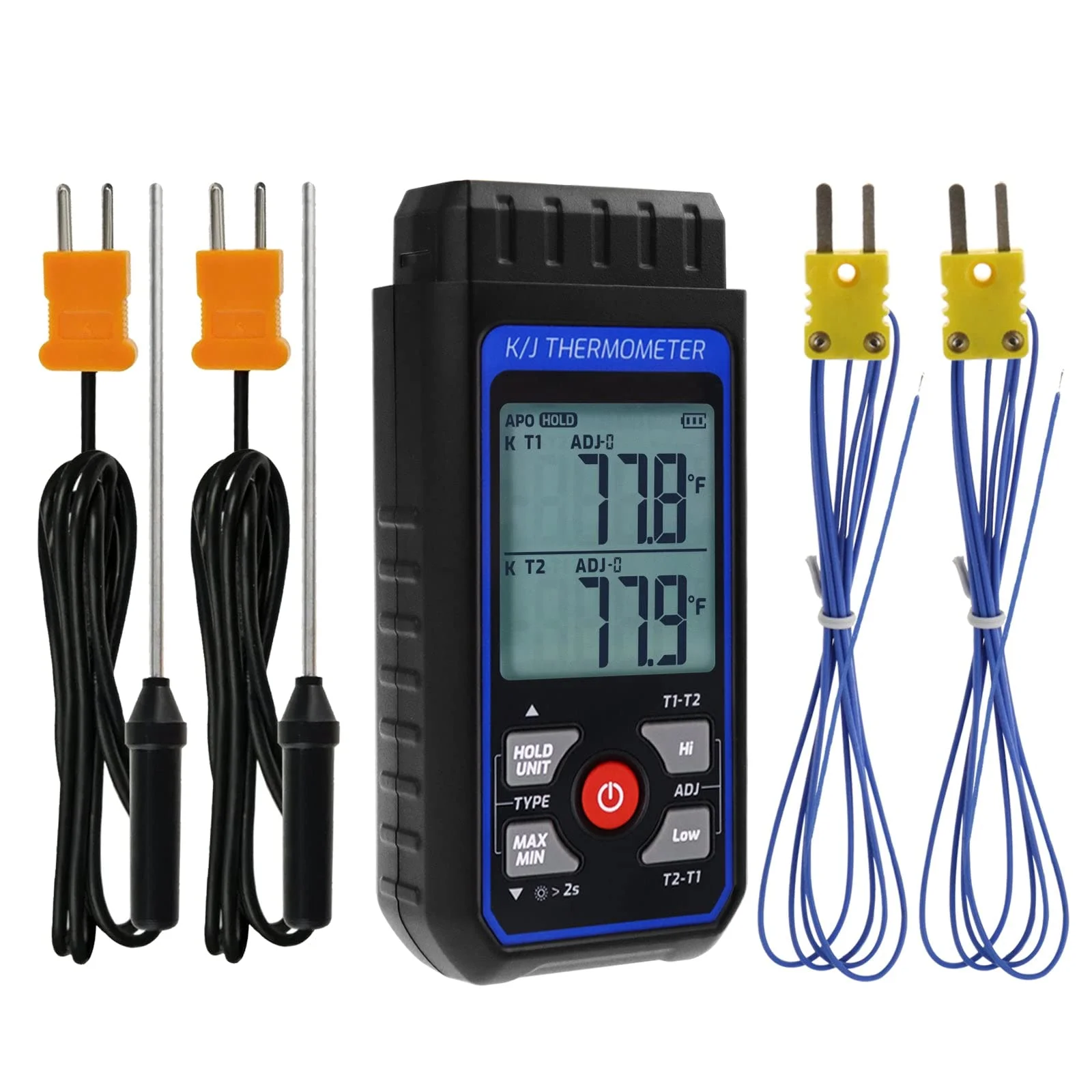

Whenever I get an odd reading, I question the source first. I would take some actual temperature measurements before throwing more parts at it. Do you have an electronic thermometer with a thermocouple attachment?
Not expensive, and you can slip the end of the thermocouple wire (the blue one shown above) into the hose connection to the radiator. It may leak a small amount during testing, but you'll get an actual temperature. You can even measure multiple spots at once with a multi-channel thermometer. This will rule out whether the vehicle is getting a bad reading - that's a different problem than actual overheating.

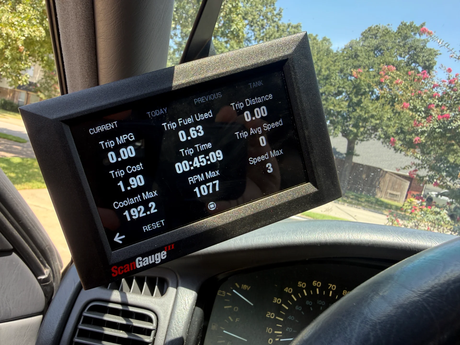

No issues idling in 98 F weather with 30k cSt fluid. 192.2 F max after 45 minutes and 194 F max after 117 minutes.
I don’t own one but I’ll check where I can buy it.
