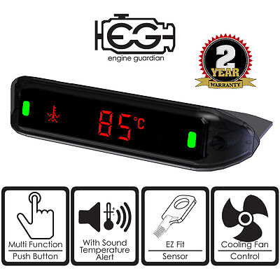

Ive had one of these Engine Guardians or its competitor (Engine Watchdog) on all my landcruisers and I cant praise them highly enough for price, reliability and ease of installation and operation.
There is an ideal spot just forward of the transfer shift lever under the dash where they will sit nicely, but easy to see. You can plug them into the cig lighter or wire them direct to the battery or fuse box.
They are so light I had mine held on with double sided tape but they do have the ability to be held on with a bracket which is screwed to the dash

With the watchdog, my understanding was it fits the sensor under any given bolt on the motor. I was worried this gives a less than accurate or at least not as real-time a temp reading as something in the flow of the coolant. Thoughts?
Having a gasket thats too thick will rob it of some power and possibly make it hard to start in very cold conditions.
I connected mine to the lower bolt on the upper coolant outlet. It probably does show a temp a few degrees cooler than the real temperature, but it gives you much better information than the OEM gauge. And you dont have to drill holes in anything.
And you soon come to realize what is normal and what is not. You look for consistency .
With the warning alarms, I had mine set a 75c, this showed me the temp was coming up from a cold start. The next warning beep was at 90c, this tells me the t/stat is working/opening. The final warning which I never used was set at 120c. The 90c warning was so reliable it would always come on in a 300 metre stretch of the freeway entrance. In summer it would come on at the beginning of the 300 metre stretch, in winter it would come on at the end of the stretch.
