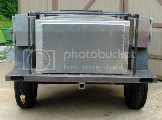

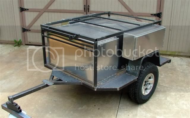

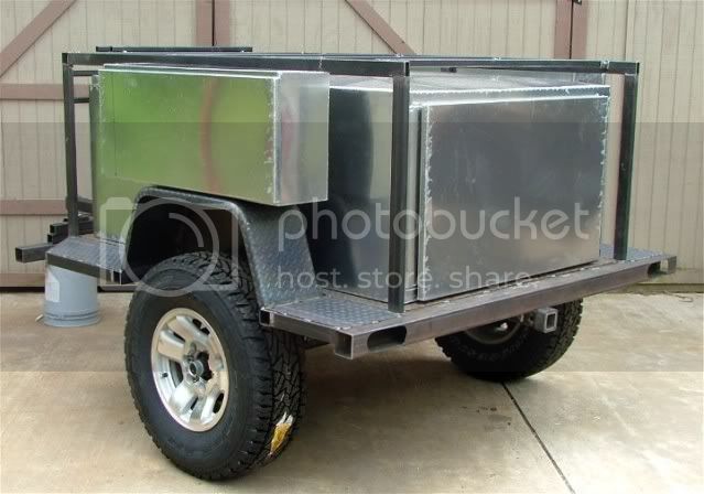

Suspension, axle and wheels on...Galley options pondering...
Got some pics of the trailer today. Rims are my OEM wheels that came with the 4runner. Tires are Bridgestone Dueler A/T Revo 2 (265/75r16).
Rear tire carrier to follow...

Closer view of the fender boxes
I had all of the front surfaces of the main and fender boxes coated with the Ameraguard coating. Dan Cusumano (Ameraguard of Lee's Summit) did a PHENOMENAL job with the coating. I removed the fuel can holders and implements (Jack, shovel, axe) but other than that He taped it all off. It is a great exercise to see true pros 'do their thing'...Thanks Dan!

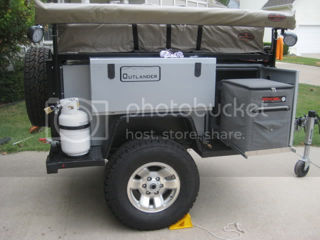

Got the transit bag for the Engel 45 installed. Fridge is on a custom tray fabbed up by Robert. If you ask me, it's about a perfect fit for front compartment...
The Engel is locked into place with a quick release pin. Even the small details are addressed...
The great thing about the location is that with the awning deployed with the screen room, I'm cooking in total comfort...:chef: I'm still trying to figure out a system for the galley box...That is the fun part of it isn't it?...
The other side of the front compartment houses the eletrical system. Eventually, my Honda EU1000iA will fit there perfectly. Don't need a tray for that, just some d-rings to tie it down. The battery will run my CPAP machine for about 18 hrs if need be with the Engel shut off...So it looks like I will be needing the Honda pretty soon...or else the entire campsite will suffer from my snoring :bang:...
The Faucet location was somewhat of an issue as to where to place it. We finally decided to go with the front of the box. Robert fabbed up a custom aluminum box cover for it. Here it is coated with Ameraguard...It is removable with two wing nuts.
