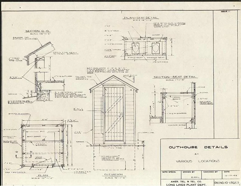

this may help. Good enough for ma bell:

I was impressed someone was able to find AT&T's old plans!
