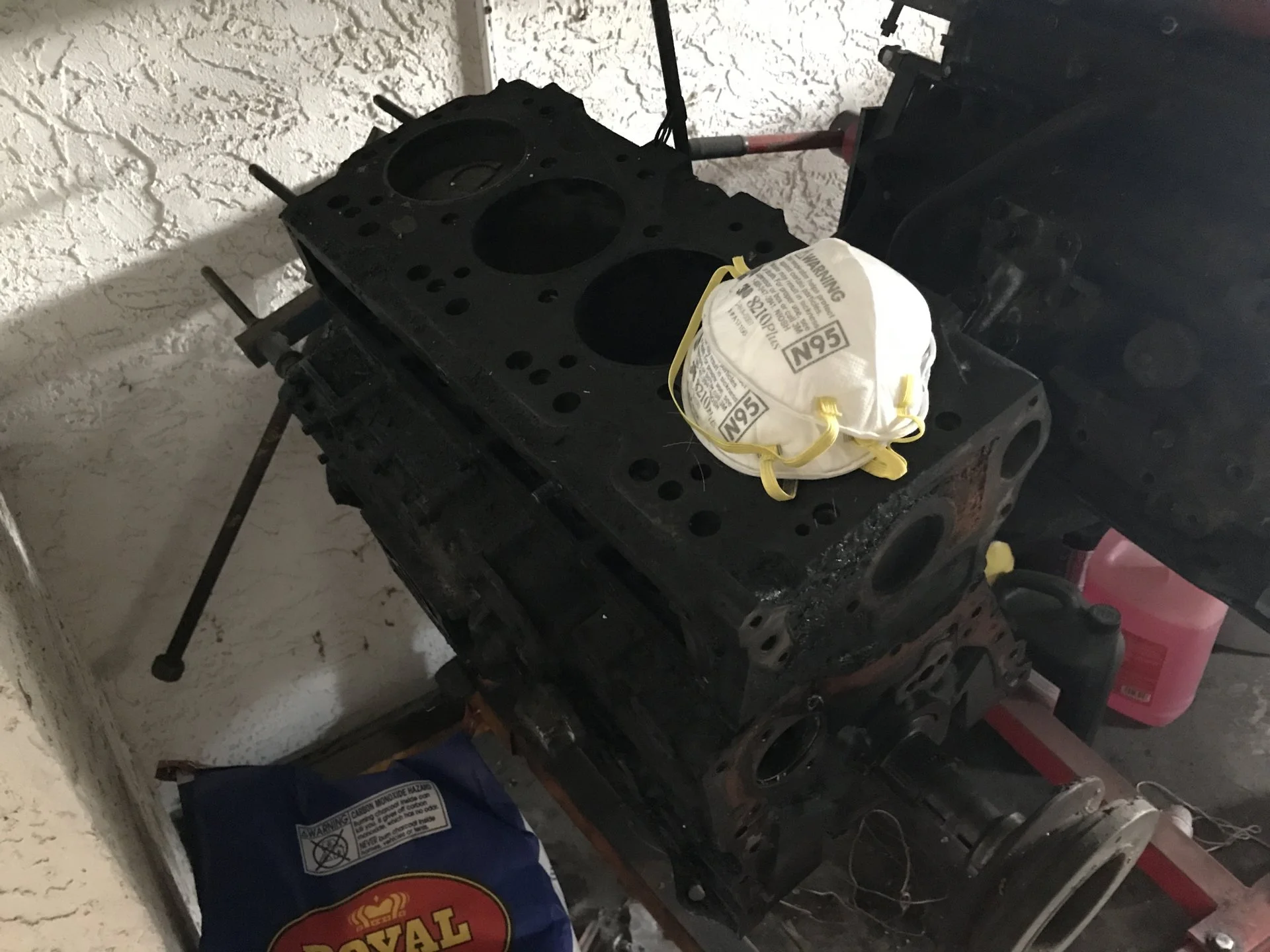

Yes, I have a motor & tranny & transfer case. I took the pan off this morning and there is a small amount of oily water. The rockers have some surface rust, and the engine only turns half-way around - I'm not sure why, yet. Lots of wire wheeling & brake cleaner, but I think I will have a brand new 3B when all is said and done.
From my one and only 3b engine rebuild, I would source a new cam and lifters, maybe have the rockers inspected and ground smooth if needed. I believe most of the low compression 3b engines I have compression tested was due to the cam being nearly rounded off, the cylinders were still mint on the one I am currently rebuilding along with the pistons. Rod bearings mint while the cam bearings were in bad shape.
It looks like some water got into number 3 for there was a bit of rust preventing the piston from full travel - a couple of squirts of WD40 fixed that issue; otherwise the cam lobes look really good, the crank looks really good, everything looks good - just really dirty. I have some new liners pistons, bearings etc coming from 4 wheel auto so things should be good to go fairly soon.
